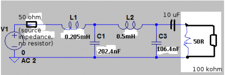

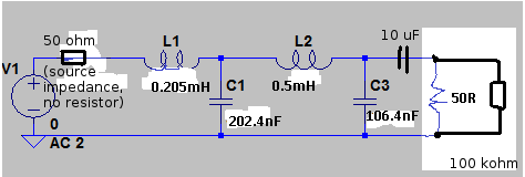

No, I mean in series with the load resistor. I don't know if 10uF is enough, simulation will tell.
With 10 uF somewhere in between a 50 ohm source and a 50 ohm load, the AC coupling time constant is 10 uF * (50 ohm + 50 ohm) = 1 ms, giving you a first-order roll-off below 159 Hz. I'm neglecting the impact of the other filter components now, but I think that's OK as they presumably only kick in above 20 kHz.
With a circuit like this you get a cut-off around 159 Hz. I gathered abraxalito wants the DC blocking capacitor somewhere between source and termination resistor to keep the source's DC output voltage from causing DC current to flow.

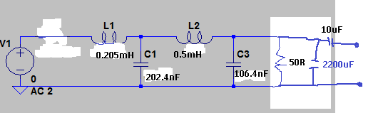

Its as I said before - 2200uF in series with the 50ohm but no need to have it in the signal path as in @MarcelvdG's drawing, rather put it between the 50ohm resistor and 0V.
If you prefer 10uF rather than 2200uF it might work but you're the design authority for that change, not me 😀

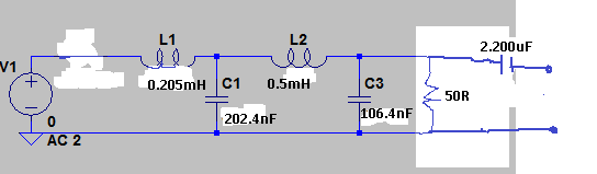

As attached schematic?

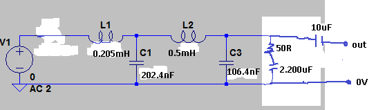

What's the purpouse of 2.200uF cap? Dosen't affect the output caracheristics impedance of filter?
  • merlinLC direct Amanero 50 ohms characteristic impedance parallel cap dc block cap.png
Yes your schematic looks correct. The 2200uF is in circuit so that there's not a DC current flowing through the 50R resistor which is just wasteful. We still need to terminate the filter at AC (20Hz and up), where the 2200uF looks very low impedance so barely affects the 50R loading.
