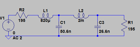

@abraxalito it's necessary R2 or in your simulation is the output impedance of the source?

Good idea, I'm unfamiliar with it. I would guess its a logic gate giving you the DSD out. I would suggest adding your own flip-flop with a very low impedance power supply. Perhaps the DIYers on the 'no DAC is the best DAC' thread will have some suggestions?
