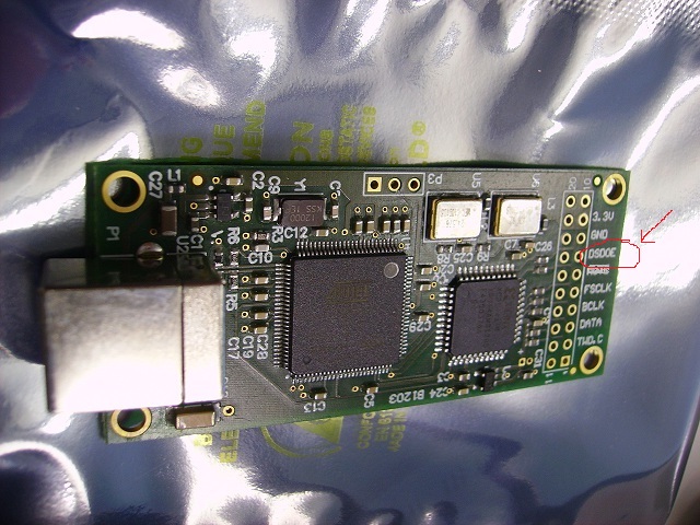

I want to filter and amplify the DSD signal directly from the Amanero USB-I2S device.

So that's presumably a logic gate giving the output. Do you have a schematic? The output impedance will depend on the particular gate (or perhaps FPGA) providing the output signal. If you use that signal directly you'll find your design will be inordinately jitter-sensitive but you'll still get sound out.

Had a look, could not see any DSD outputs marked. Assume the output impedance is low - so use a 180R series resistor at the input to the filter (rather than the 195R shown). Remember it has 6dB attenuation in the passband.
The pic's pretty but doesn't give any indication as to what the driving components are, so I suggest suck it and see.
Marked in red, see the attached pic.

Without DAC then you'd be using the Amanero board's outputs directly. Feed them into two of the LC filters I've shown, using 180R as the first resistor.
