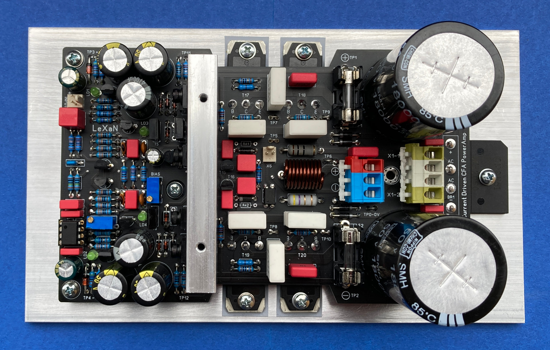

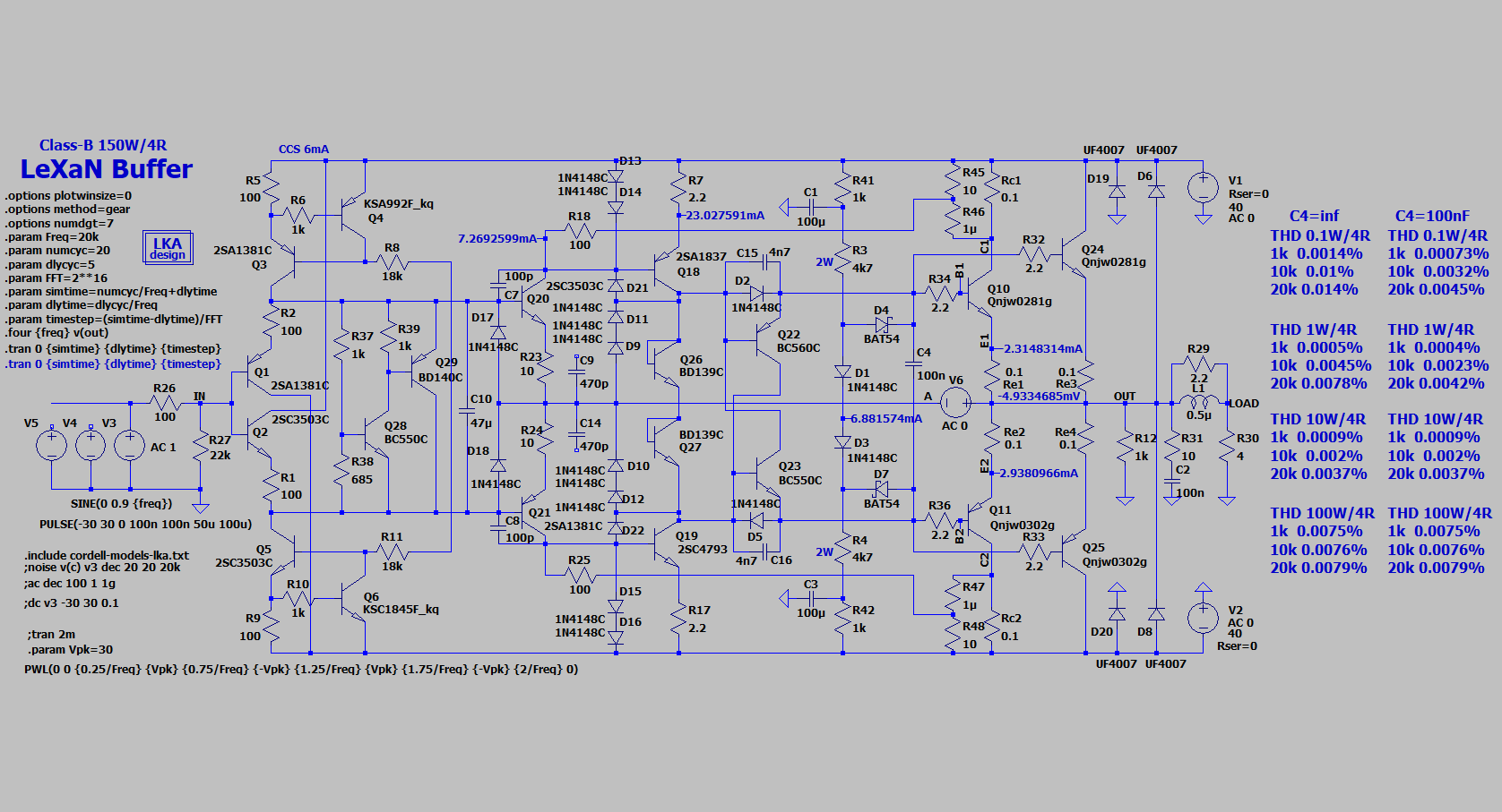

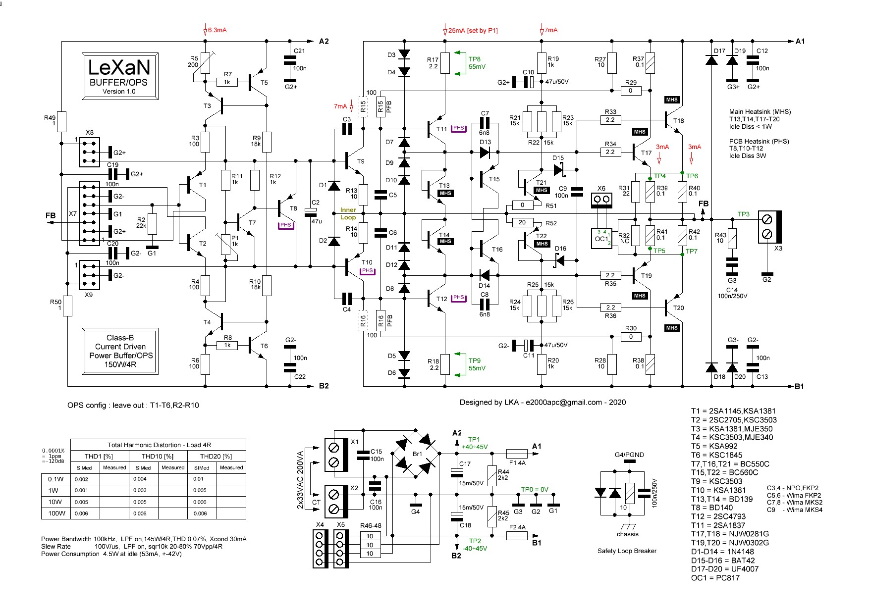

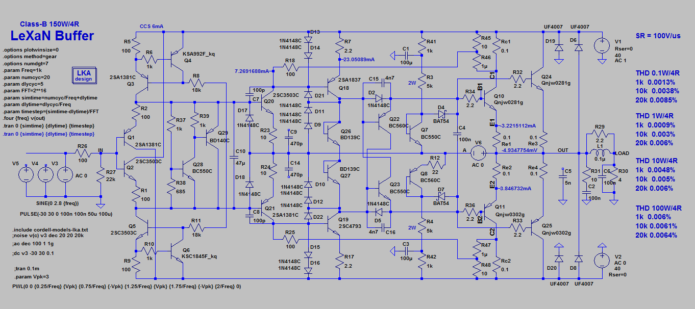

The final LeXaN buffer schematic (voltage amplification =1). I applied Technics synchronous bias technique to the outputs. The cross-over region is very smooth, though the idle bias is 3mA per pair. The circuit doesn't suffer from cross-conduction at high frequencies and output levels (the Achilles heel of almost all Class-B implementation).
Simulated THD <= 0.01% 0.1W-100W/4R
IMHO, this is the best Class-B output stage I have ever seen.

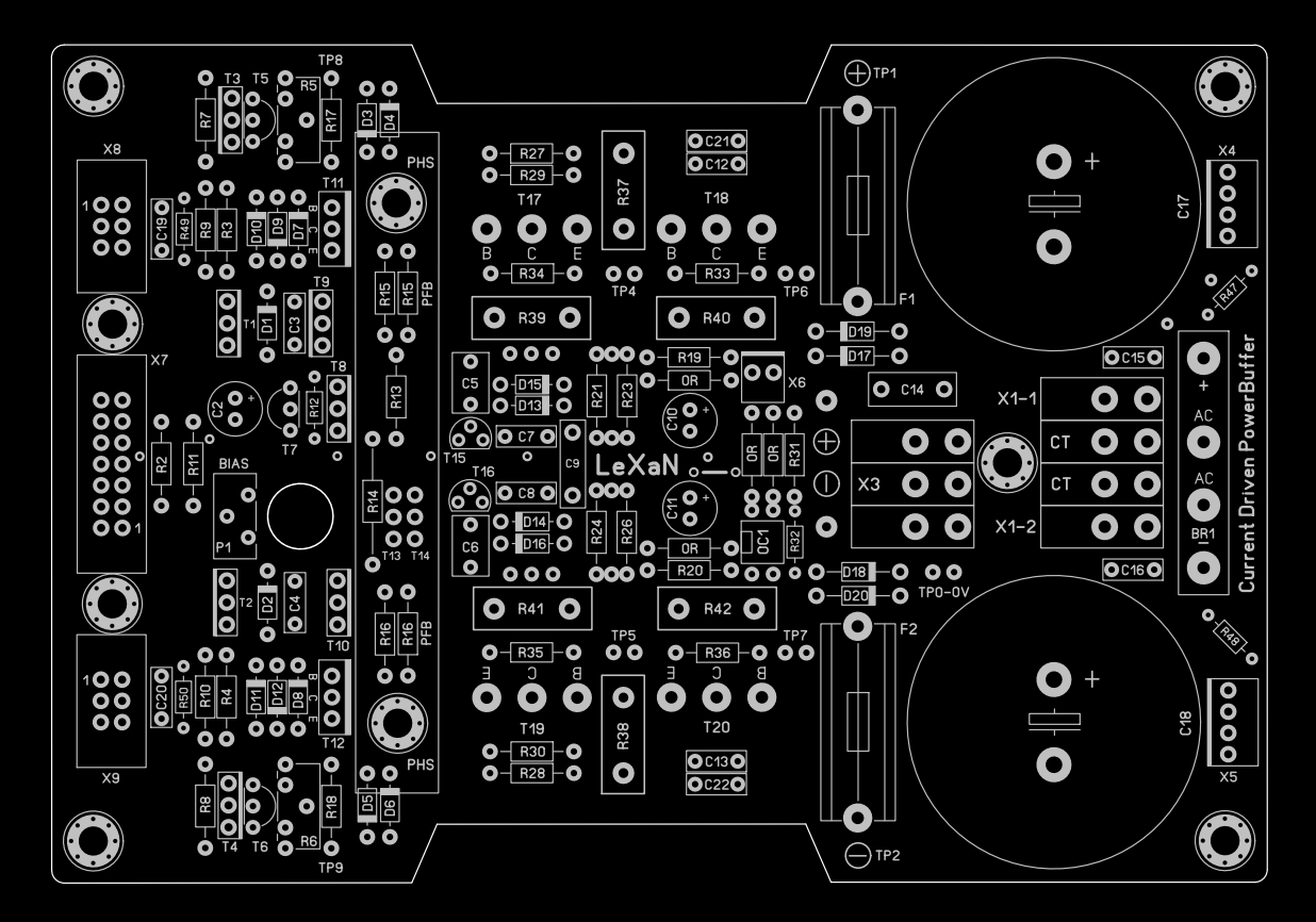

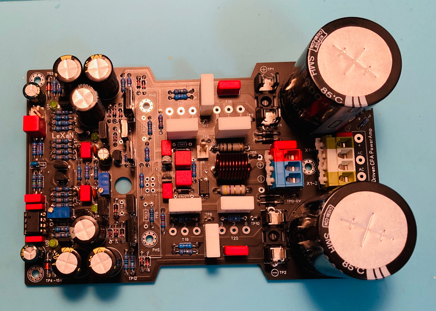

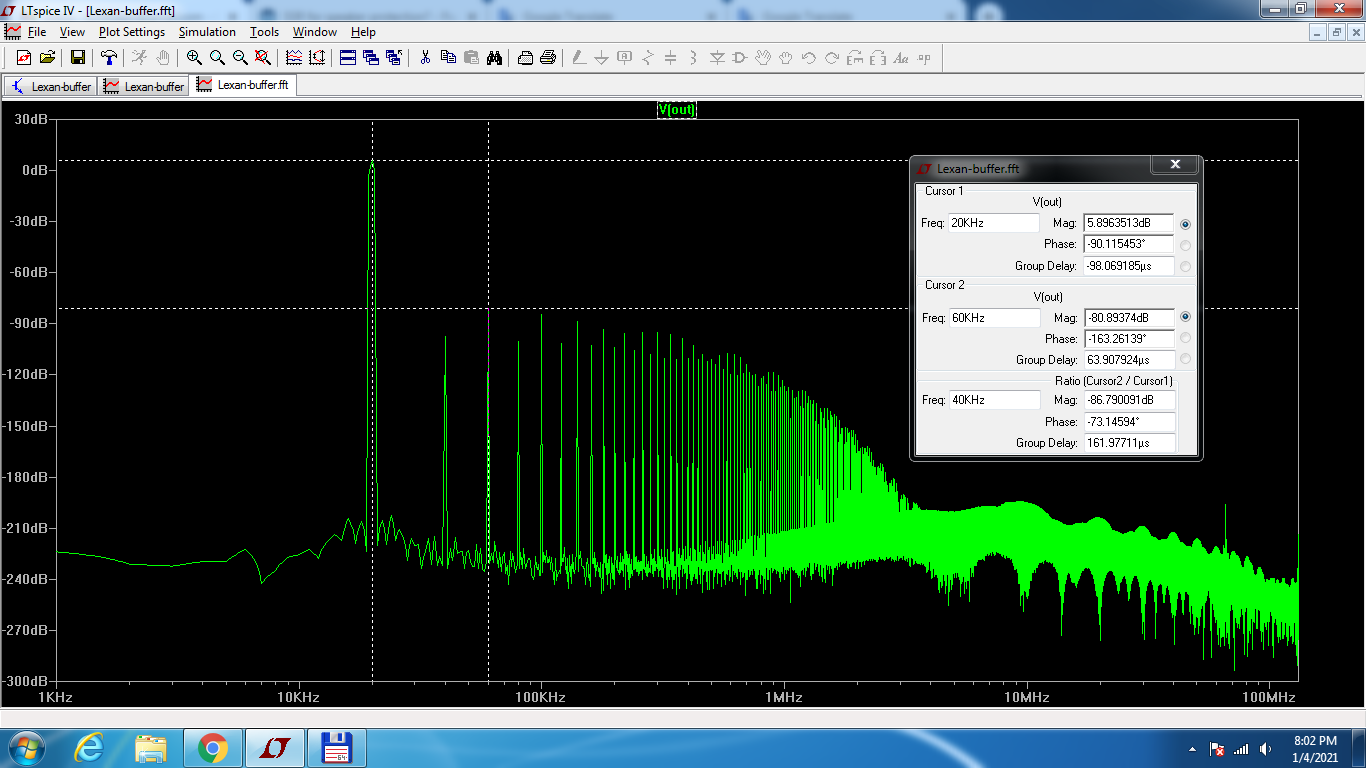

Very interesting and nice build LKA! What's the loop feedback of the circuit, could you show simulation graph and fft to see the harmonics content?
Did you mean the buffer performance ? What frequencies/levels are you interested in ?

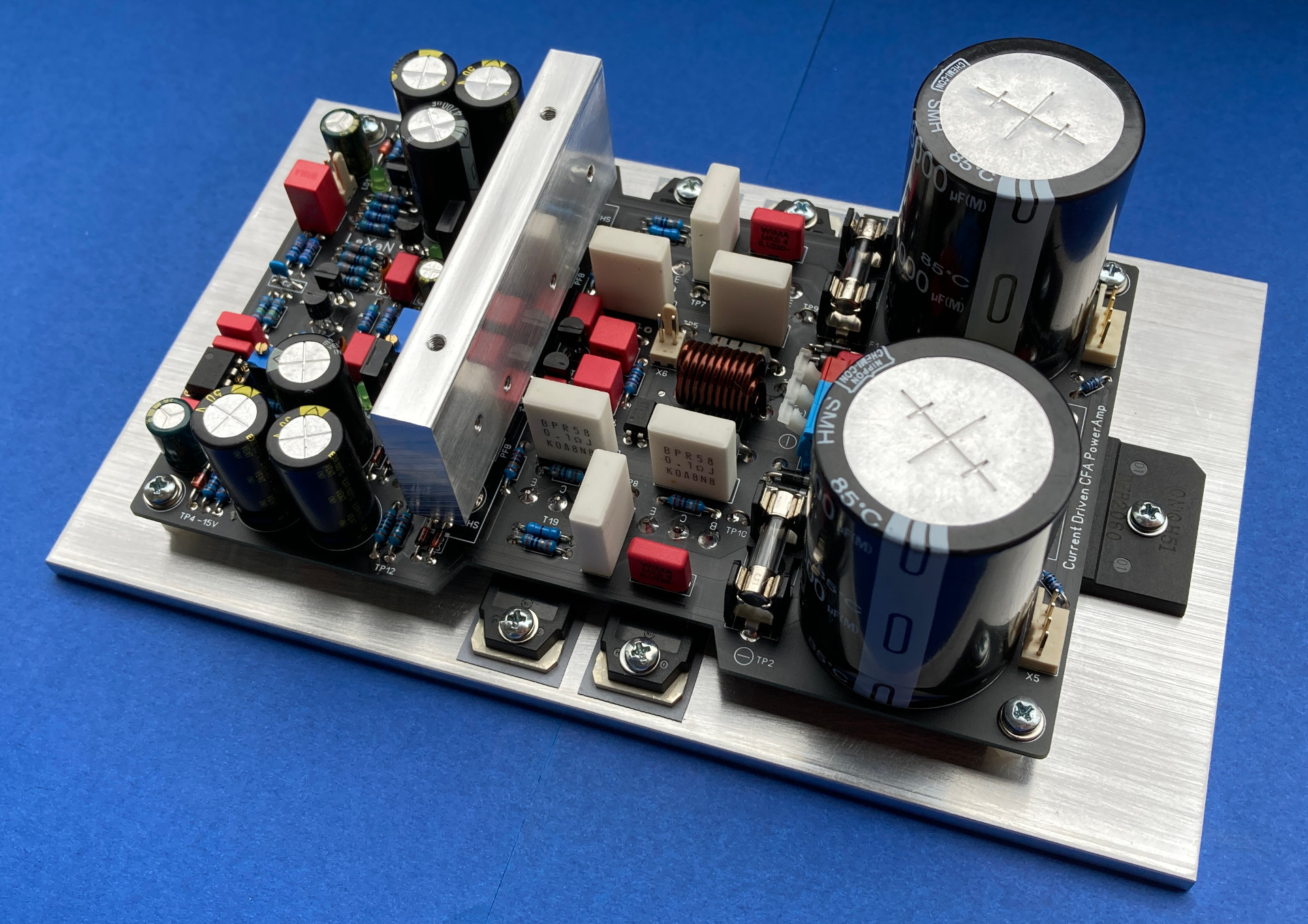

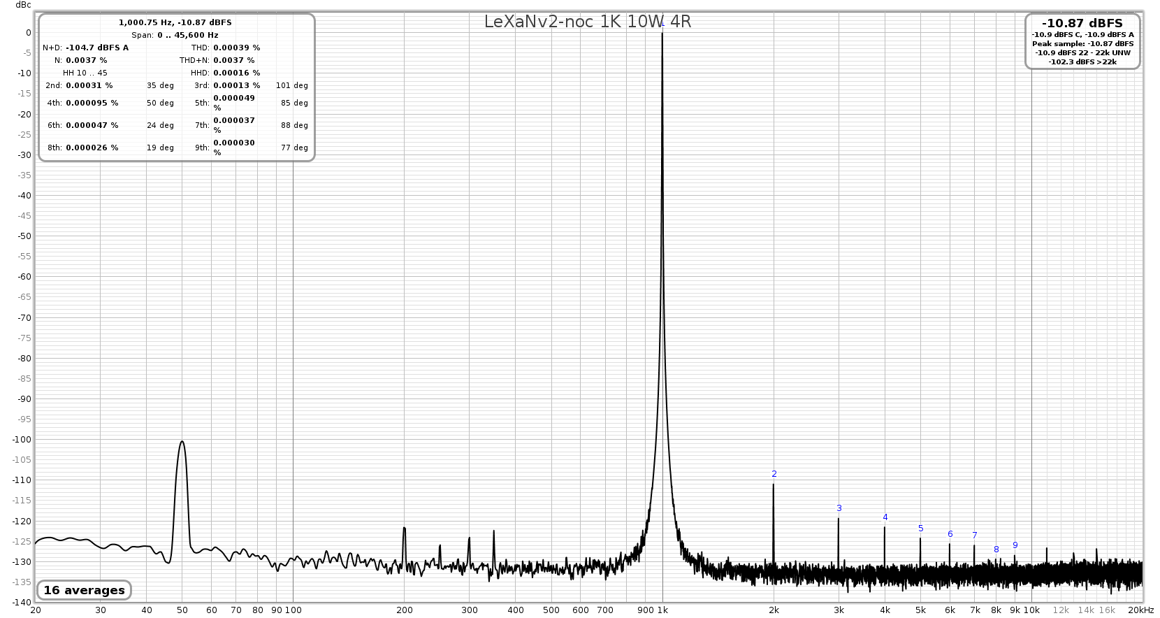

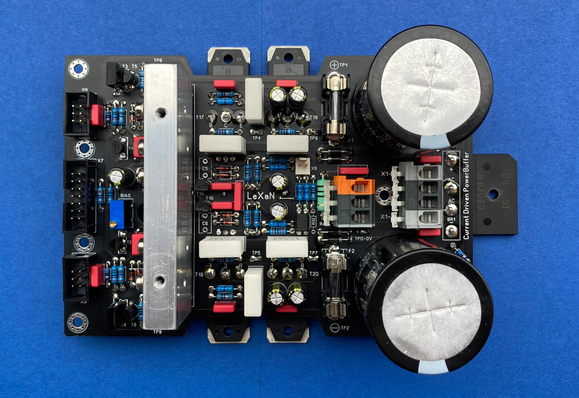

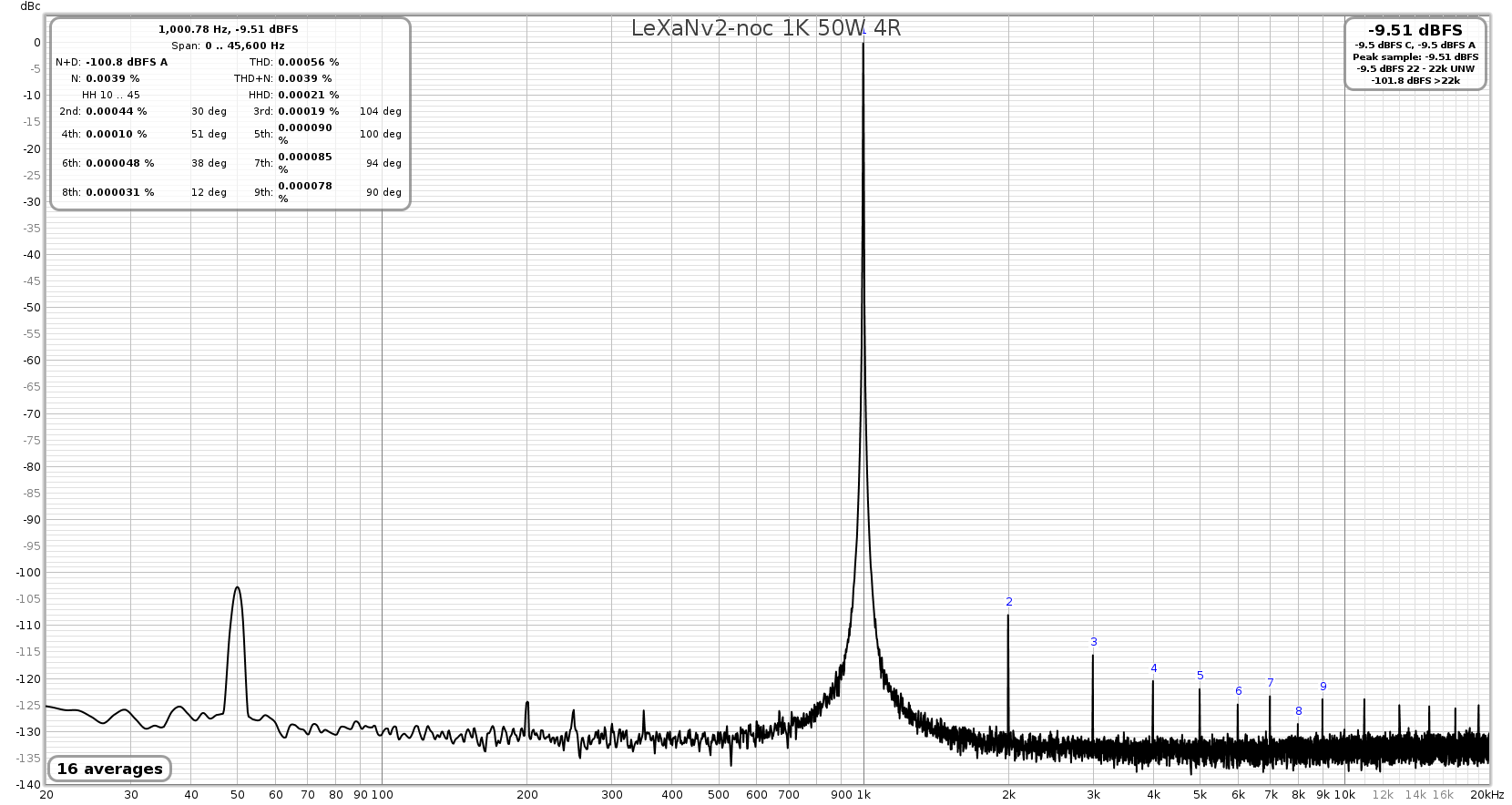

Until now I built and measured LeXaN v1 and v2, just small differences between them.

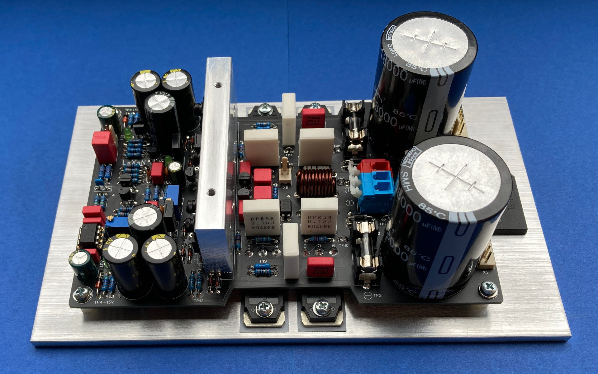

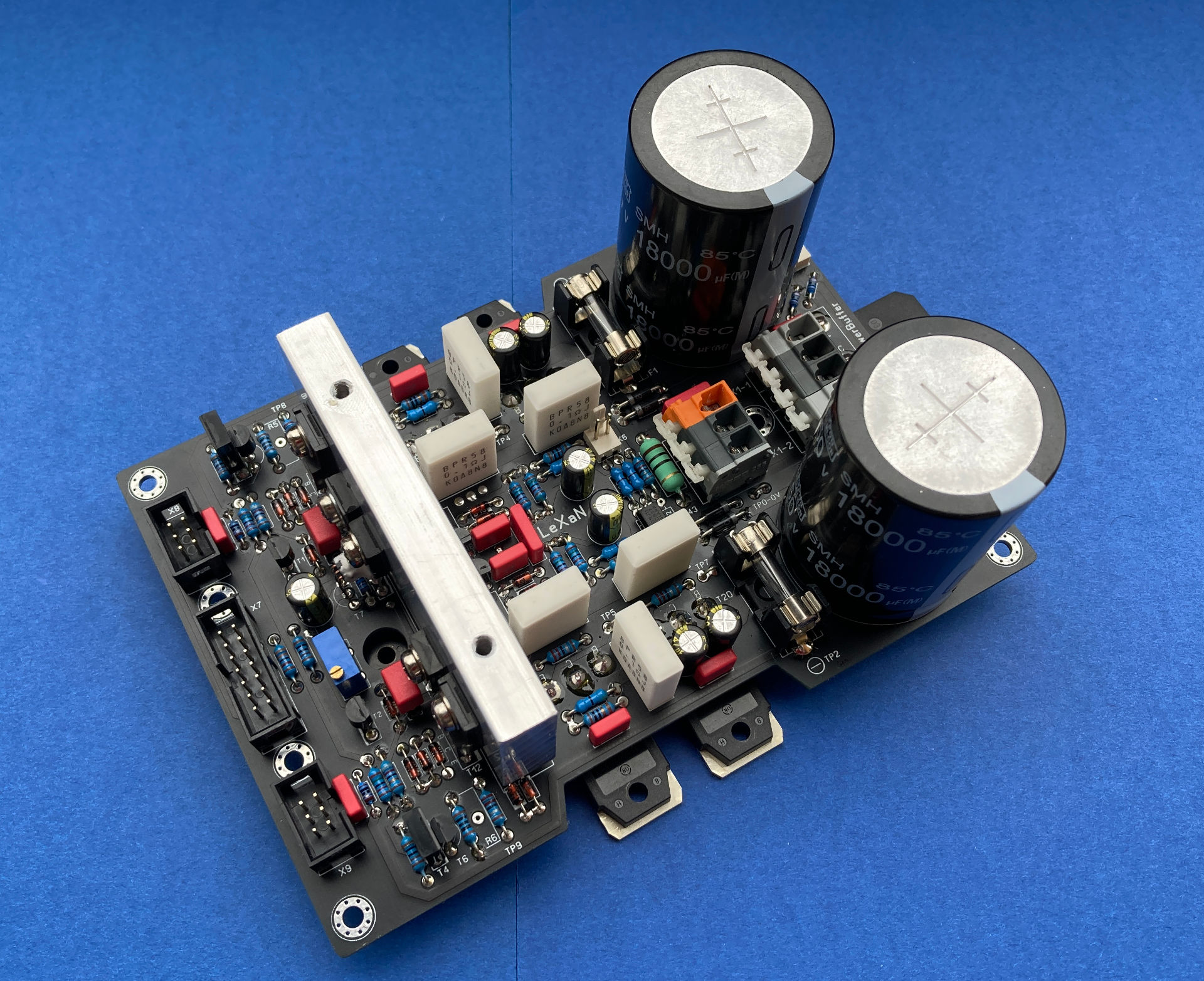

The buffer pcb is in final preparation phase, tomorrow will be send to manufacturing.

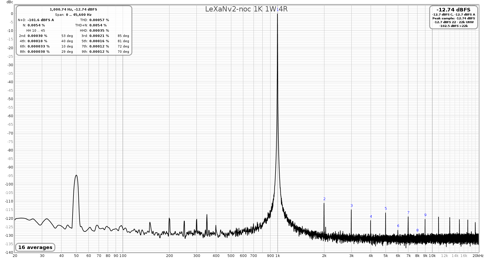

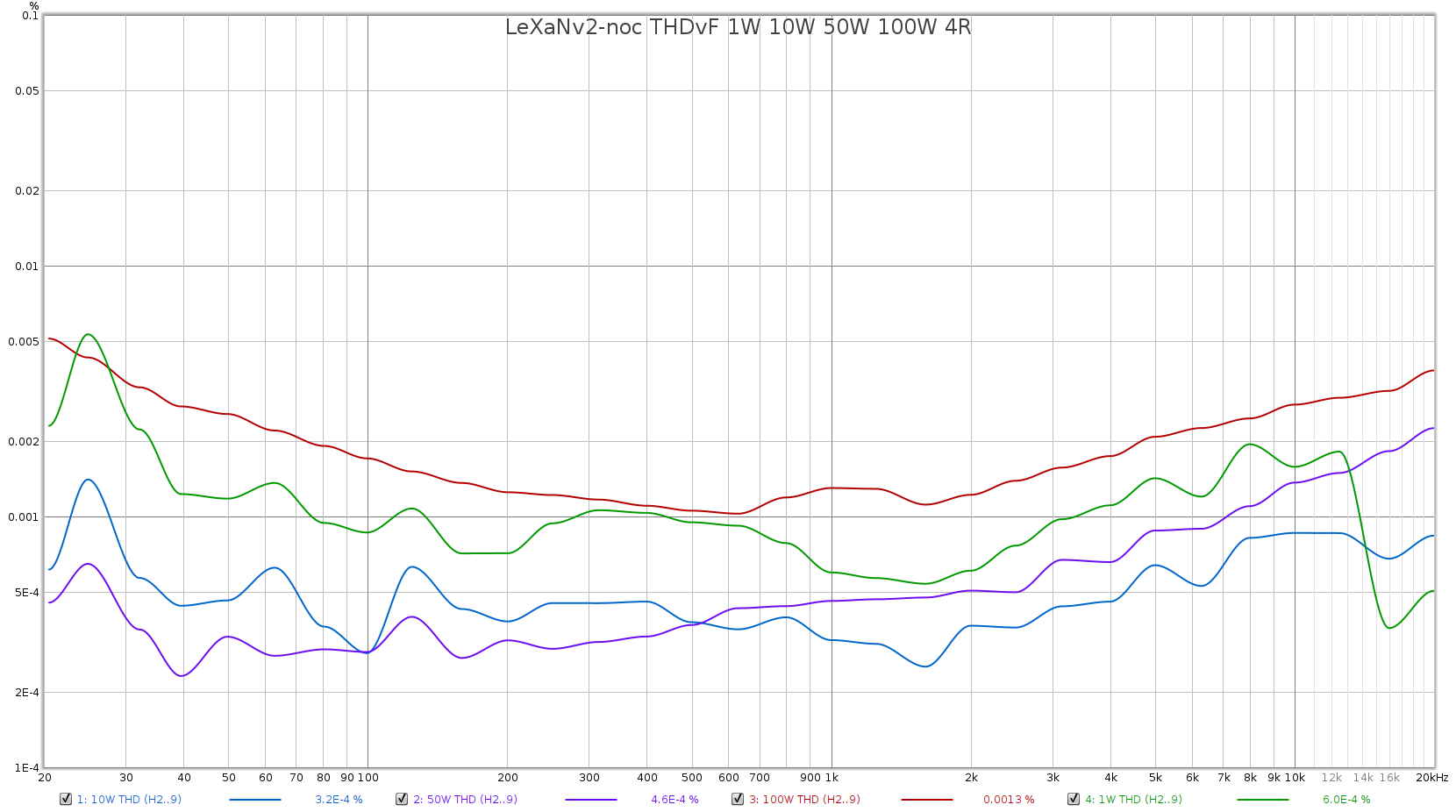

v2 measurements

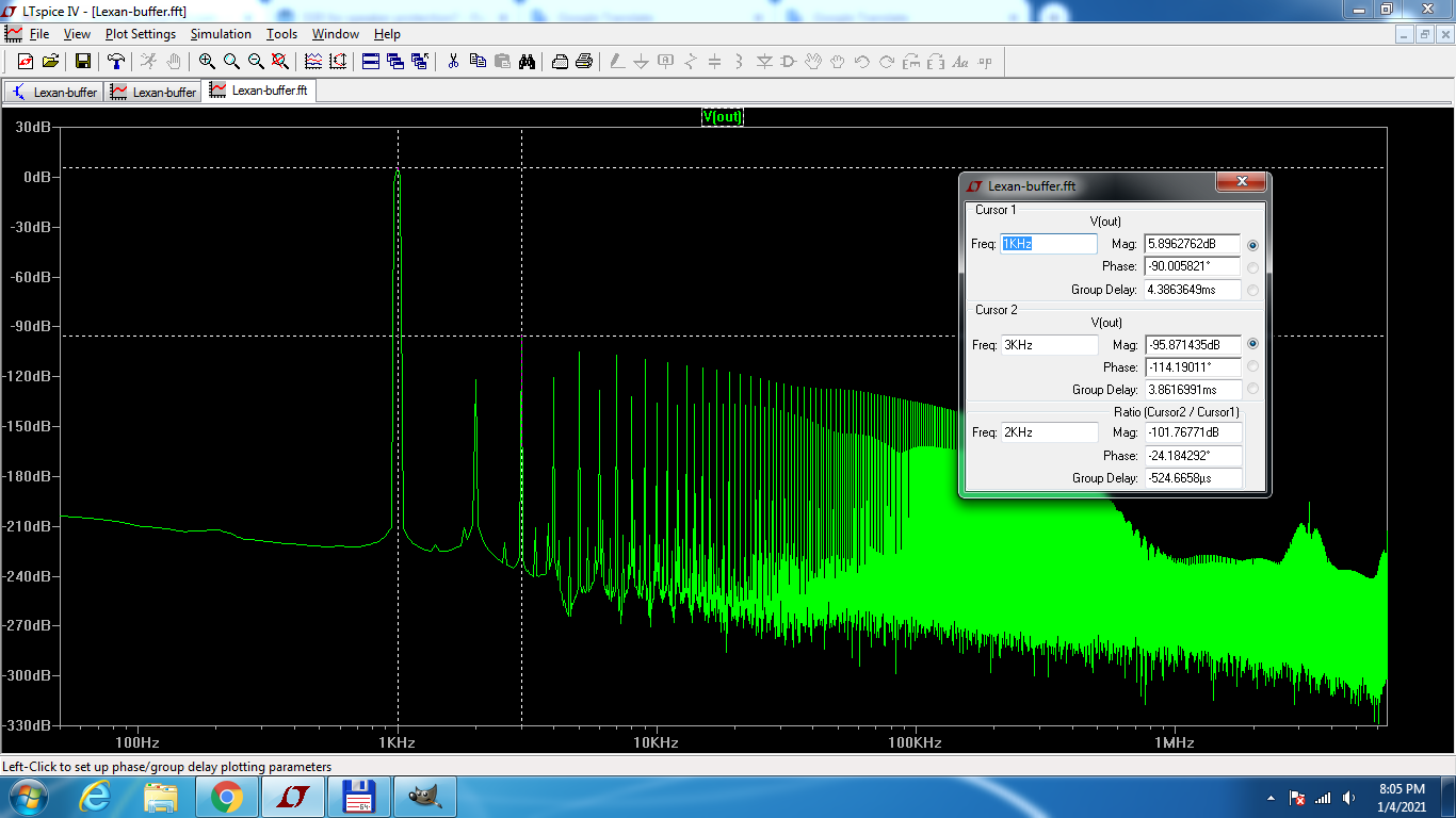

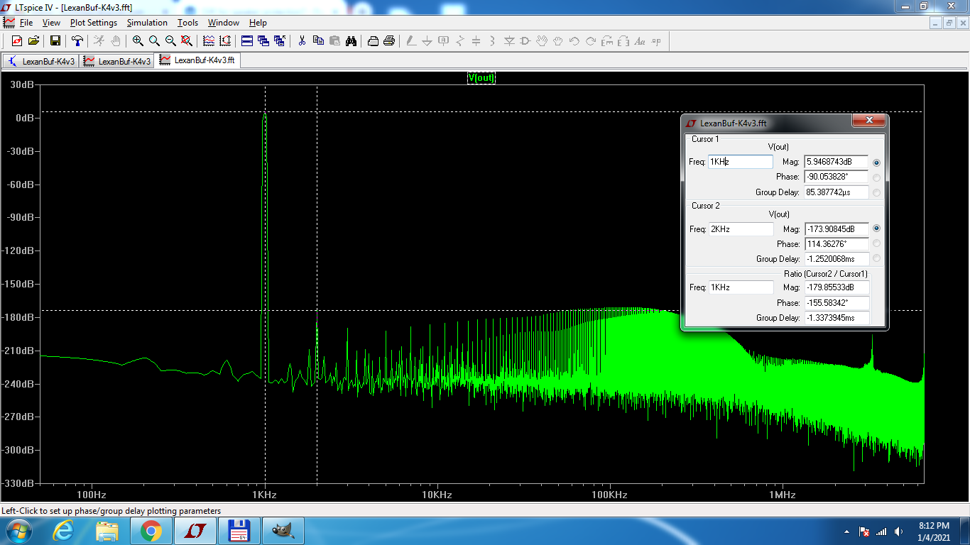

the buffer simulated spectrum at 1W/4R, 1kHz and 20kHz

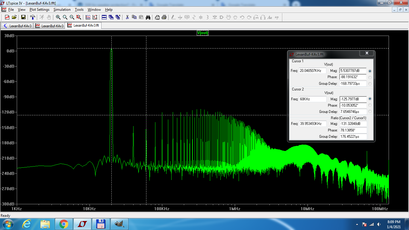

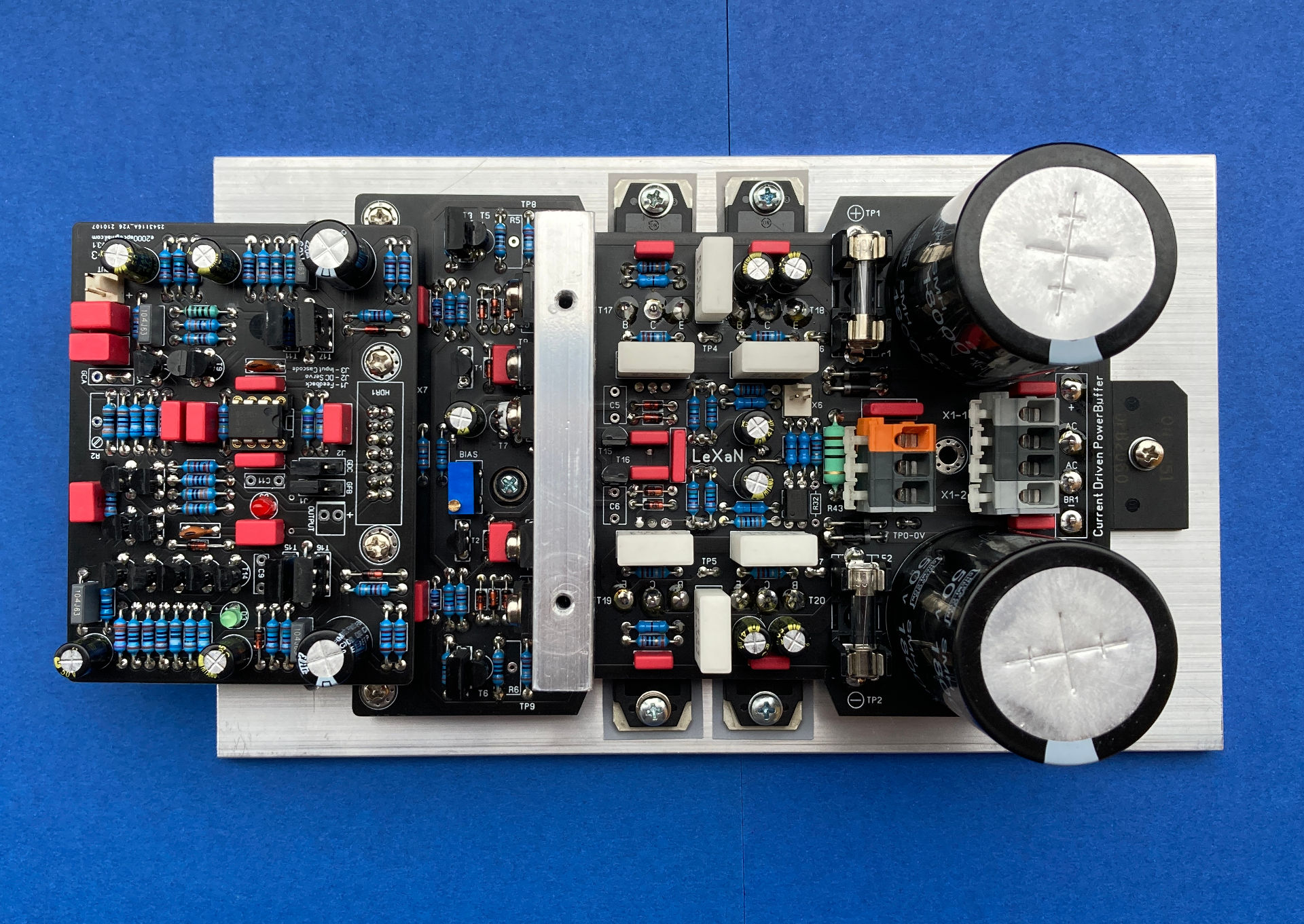

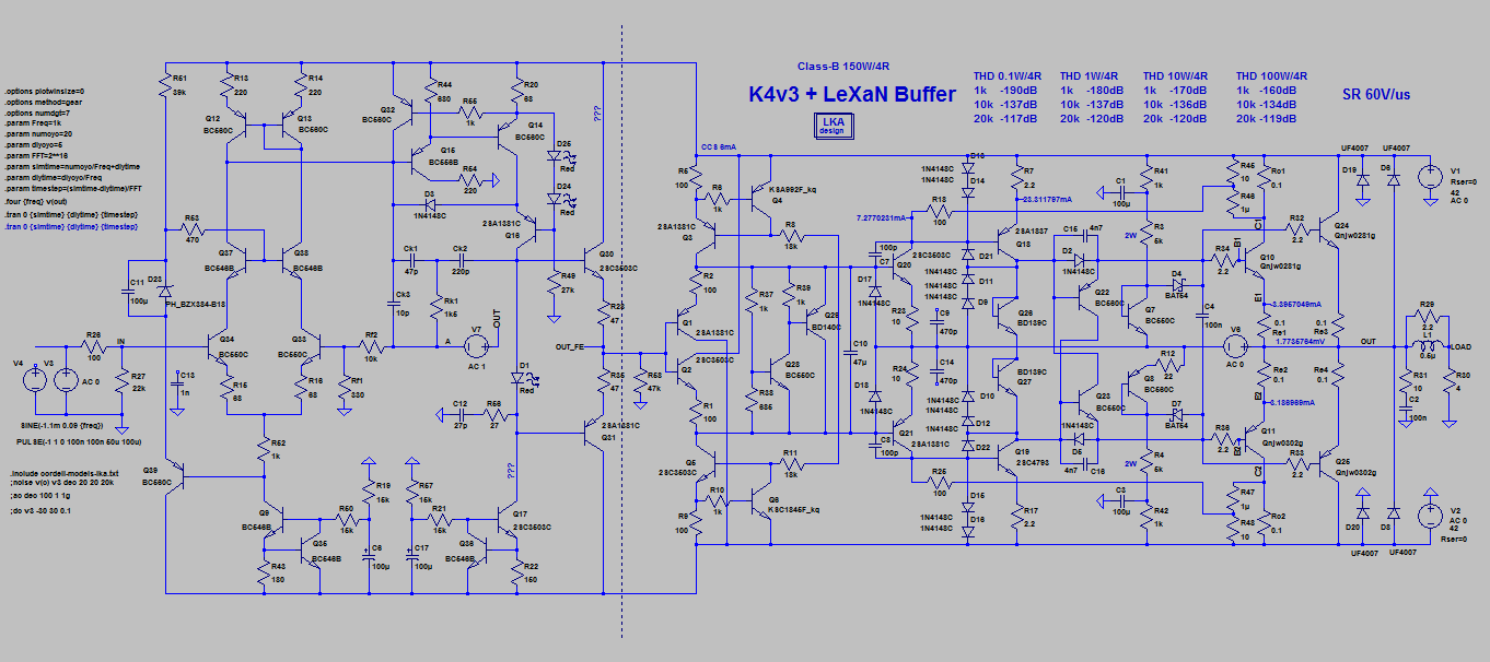

when the buffer is driven by K4v3 front-end, the thd is dropped by more than 35dB
