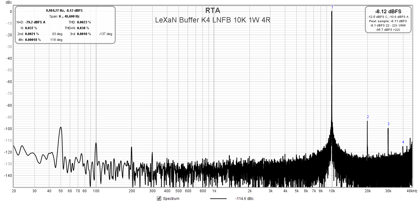

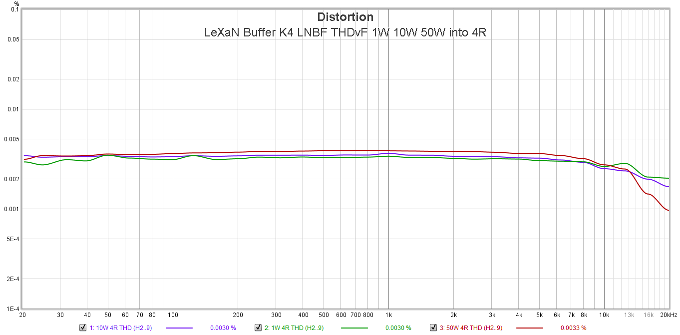

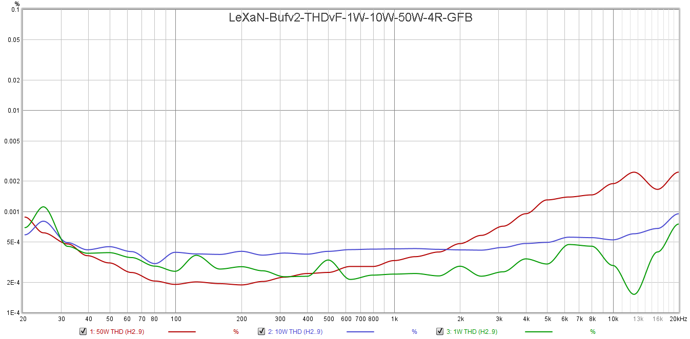

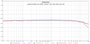

some measurments (global feedback was not applied)

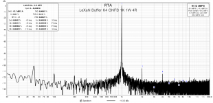

spectrum 1W/4R 1kHz and 10kHz
THDvF 1W 10W 50W /4R
When global feedback is applied, even harmonics are less reduced than odd ones. What could be the explanation?

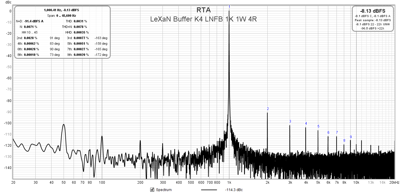

1W/4R 1kHz, no global feedback
2H 0.0028% -91dB
3H 0.00077% -102dB
4H 0.00062% -104dB
5H 0.00051% -106dB

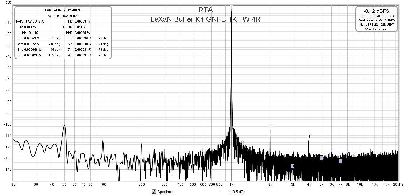

1W/4R 1kHz, global feedback
2H 0.00053% -106dB
3H 0.000026% -132dB
4H 0.00022% -113dB
5H 0.000030% -131dB
Distortion reduction by global feedback
H2 15dB
H3 30dB
H4 9dB
H5 25dB
2H 0.0028% -91dB
3H 0.00077% -102dB
4H 0.00062% -104dB
5H 0.00051% -106dB
2H 0.00053% -106dB
3H 0.000026% -132dB
4H 0.00022% -113dB
5H 0.000030% -131dB
H2 15dB
H3 30dB
H4 9dB
H5 25dB

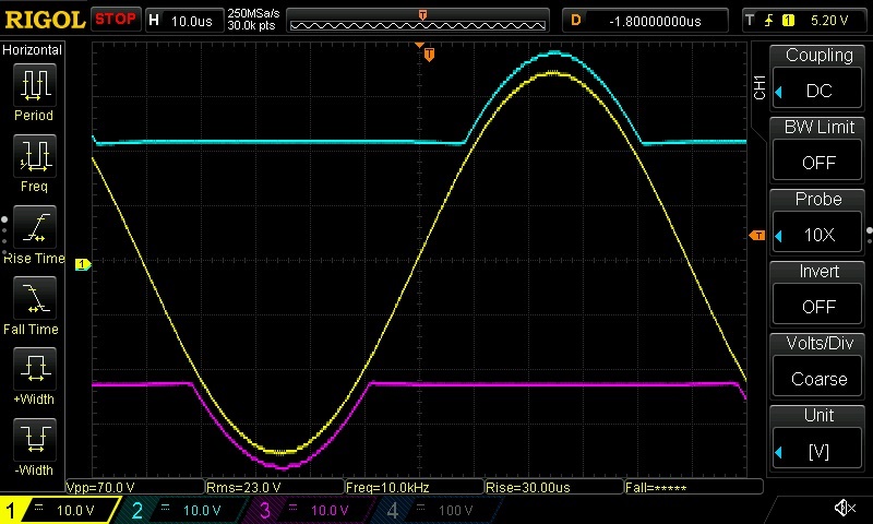

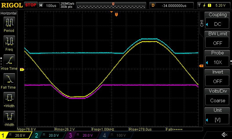

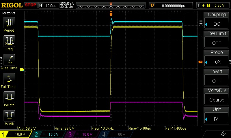

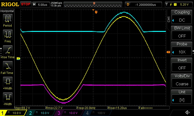

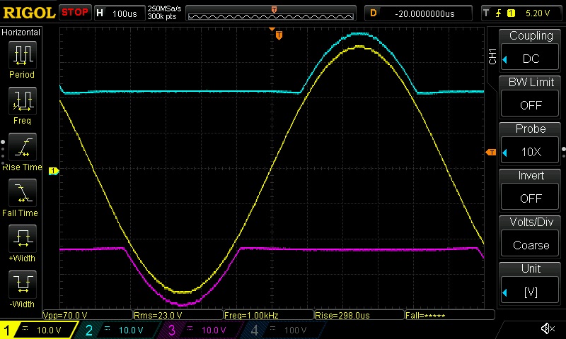

First measurments of the Class B+G prototype.
Outer PSU +-48V
Inner PSU +-24V
Yellow trace = output into 4R
Blue trace = upper/inner transistor collector voltage
Magenta trace = lower/inner transistor collector voltage
Outer PSU +-48V
Inner PSU +-24V

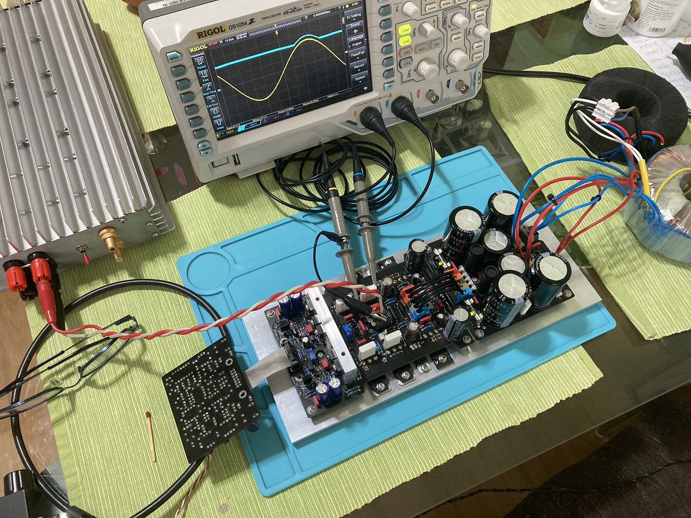

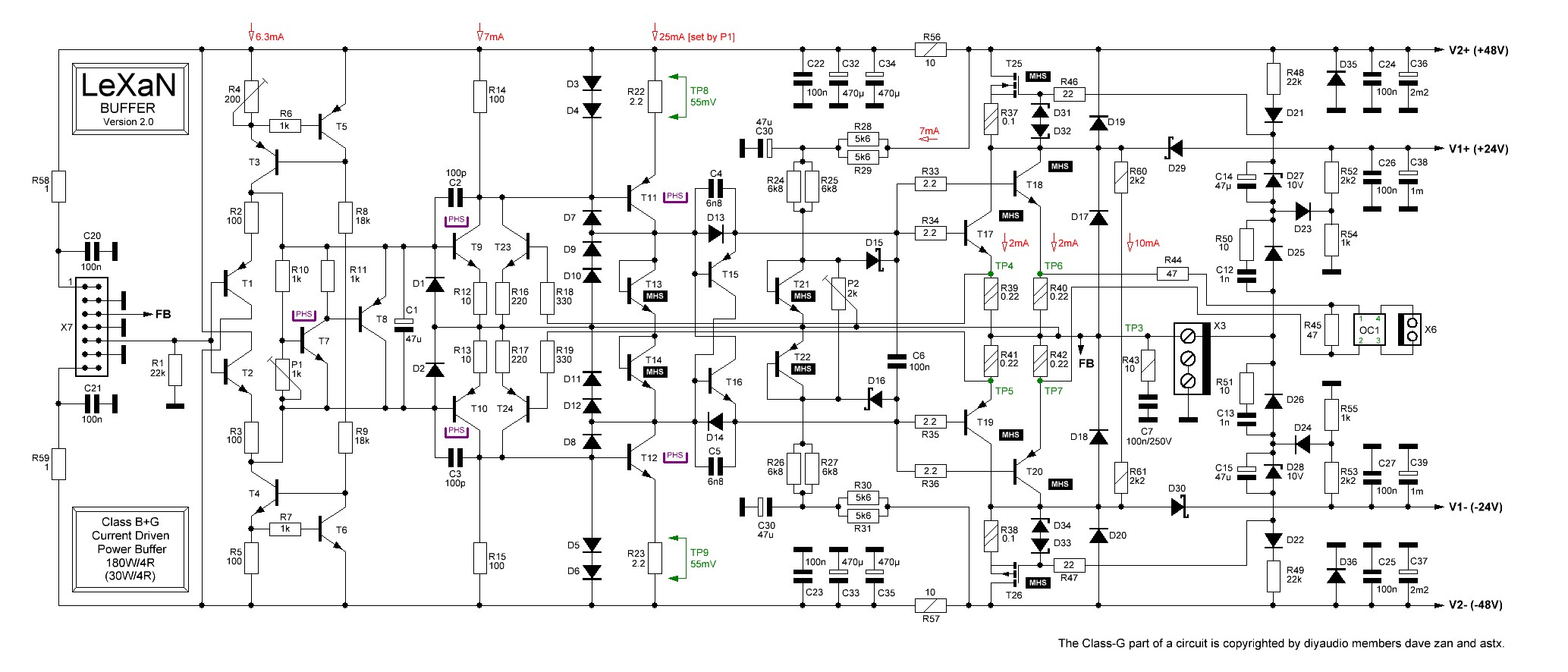

You have used IRFPs 240/9140 for higher rail voltages?
what gate resistor values are you using here in your test sample?

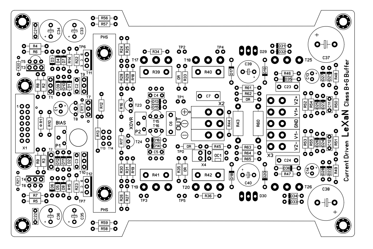

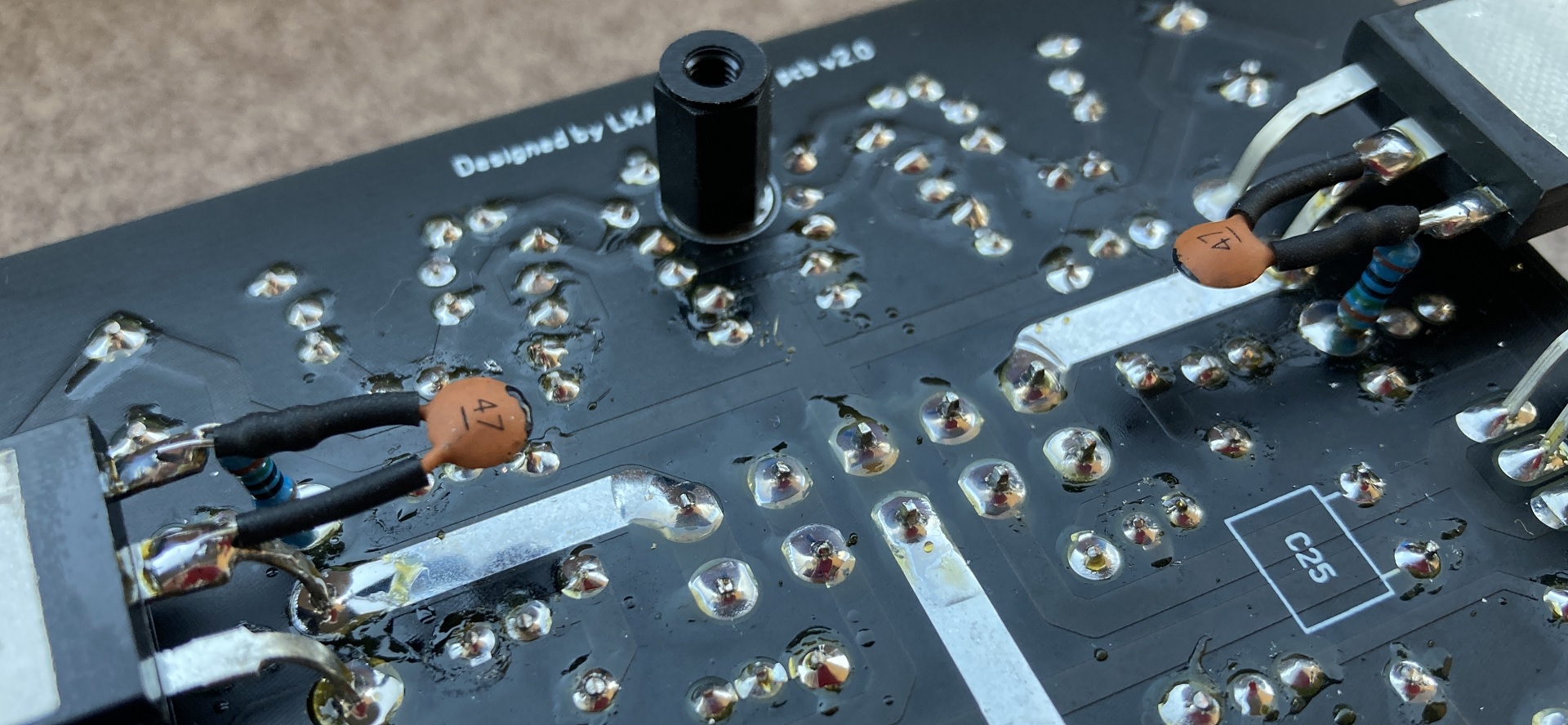

First I tried IRFP240/9140. 9140 was stable with 120R gate stopper, 240 only with 220R. Now I have IRFP140/9140 and 150R stoppers.

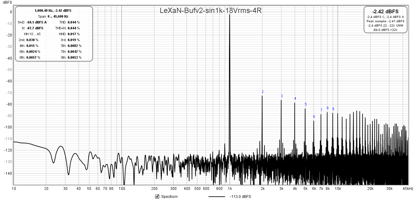

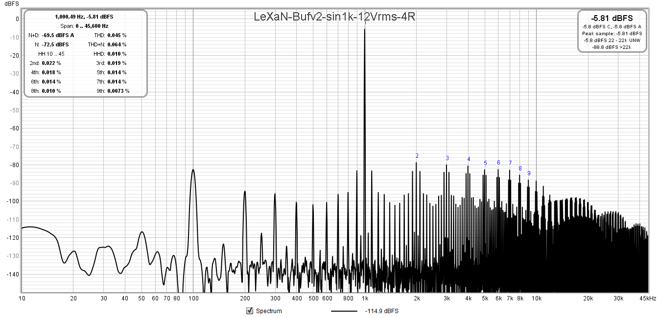

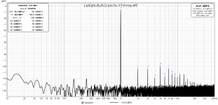

The distortion is bad when high voltage rails are involved. The transition is somewhere between 11-12 Vrms. The 100Hz modulation is also very strong above the transition line, but acceptable at higher outputs like 18Vrms. Tony, what do you think ? Where is the problem ?
r60 and r61: the original design uses 20mA idle current.
have you used the same fast schottky types as our test sample?

During the transition the 100 Hz ripple from the low voltage power supply trigger the schottkys on/off. maybe the LV PS elko ground routing is too near the feedback line.
I solved the problem by increasing the gate stoppers from 150R to 200R. The oscillation was not visible on the oscilloscope. Now the distortion is also excellent above the transition line.
Congratulations! The IRFPs do not like longer legs!
Have you tried to short circuit the 0.1R resistors R37 and R38 (schematic post #63).
I have used 150R gate resistors as close to gate as possible. (see picture in post #1408).
AFAICS you are using only one MOSFET per rail so current sharing is not a problem. Should better the THD a little bit.
