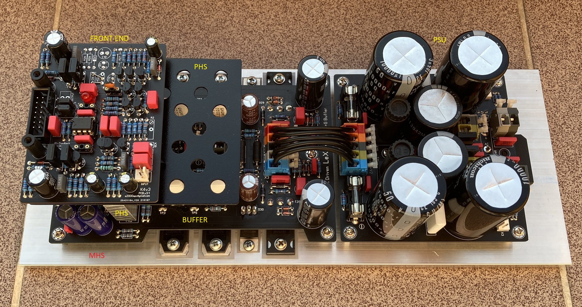

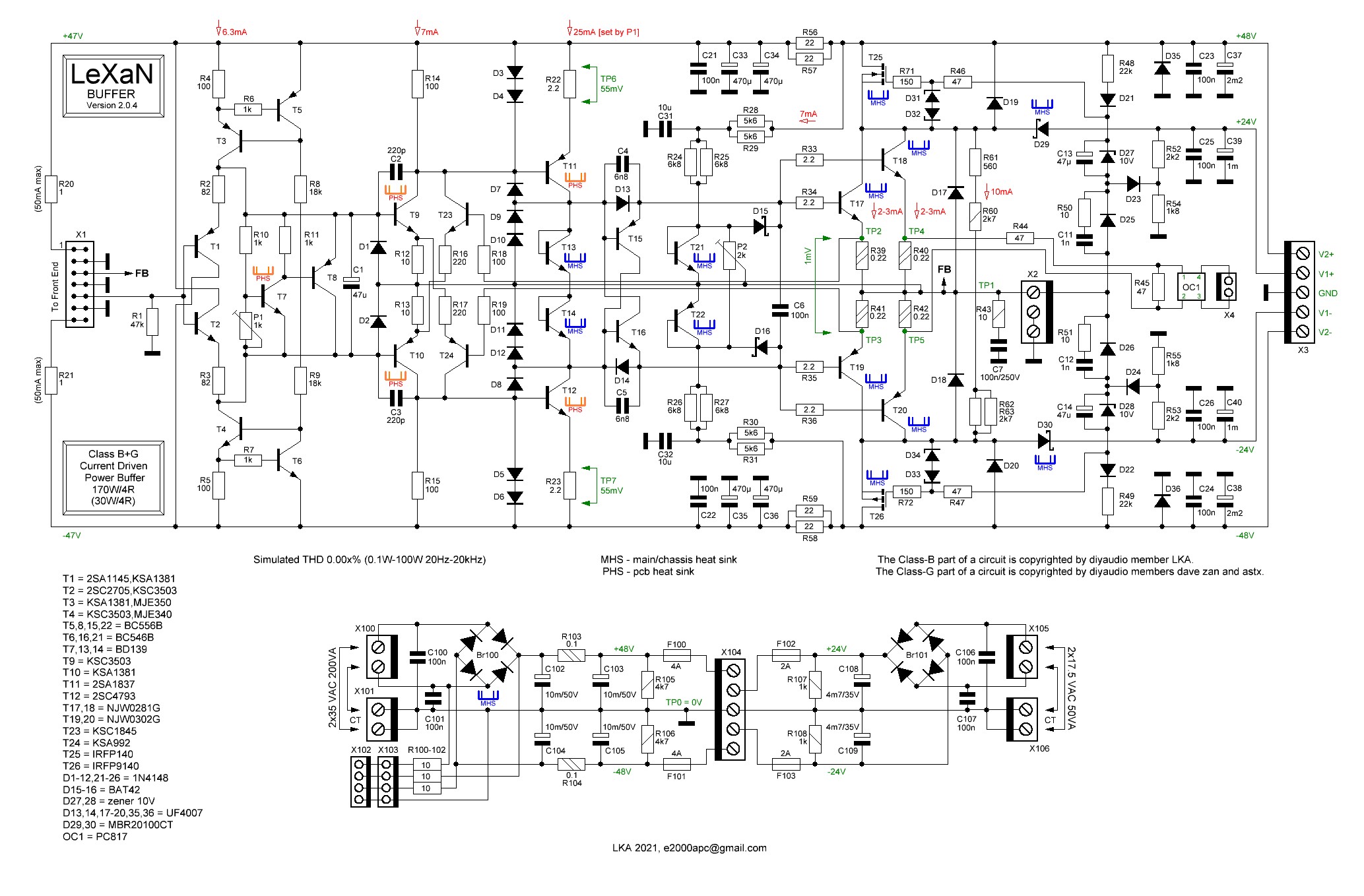

Low distortion current driven Class-B output stage
the final form of the prototype and its circuit diagram
