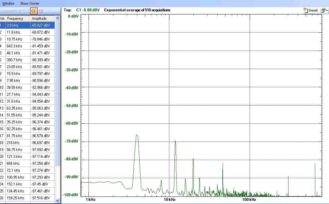

Here's my plot of the PV/FET circuit, a 1500/100 Ohm bridge, nulled against another 1500 Ohm resistor and the FET (J310) tuned to 100 Ohms. The seconds can be nulled to almost the noise (I used .033u across the PV don't know how low you can go). This is at ~.9V p-p on the FET, if the distortion is low order it should drop dramatically (60dB/dec) at lower levels.
This is about as good as I could null the fundamental stepping 1mV or so at a time on the PV drive (100 Ohm in series with the LED).

Why does the cap drop H2? Thx-RNMarsh

Non-linear Cgd and Cgs, the PV looks like a current source so the displacement current directly adds to the control signal.

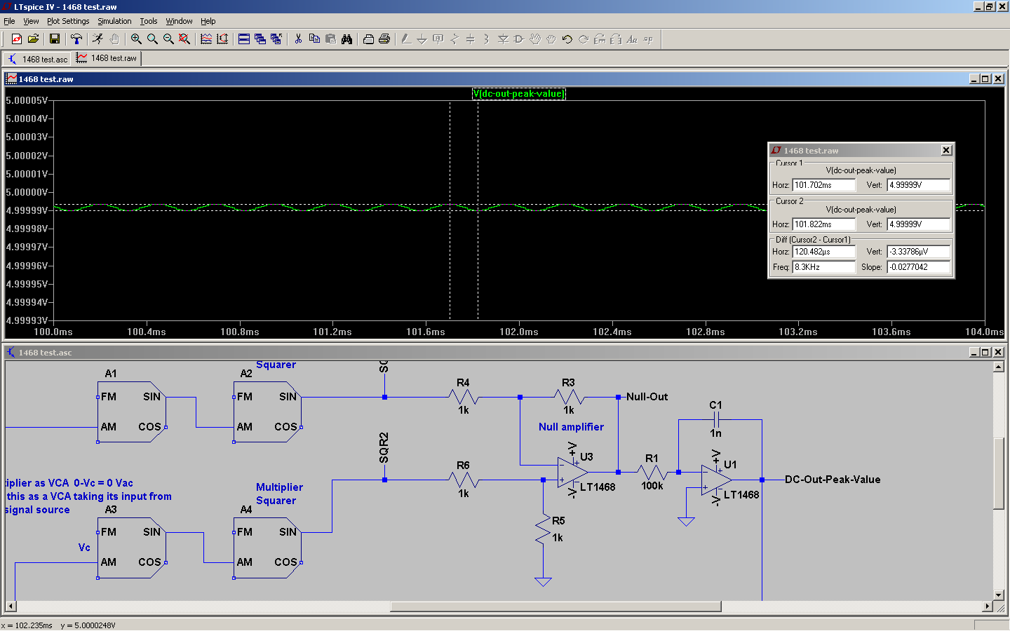

This one I'm optimistic about. I think it might be fast enough for conventional loops.

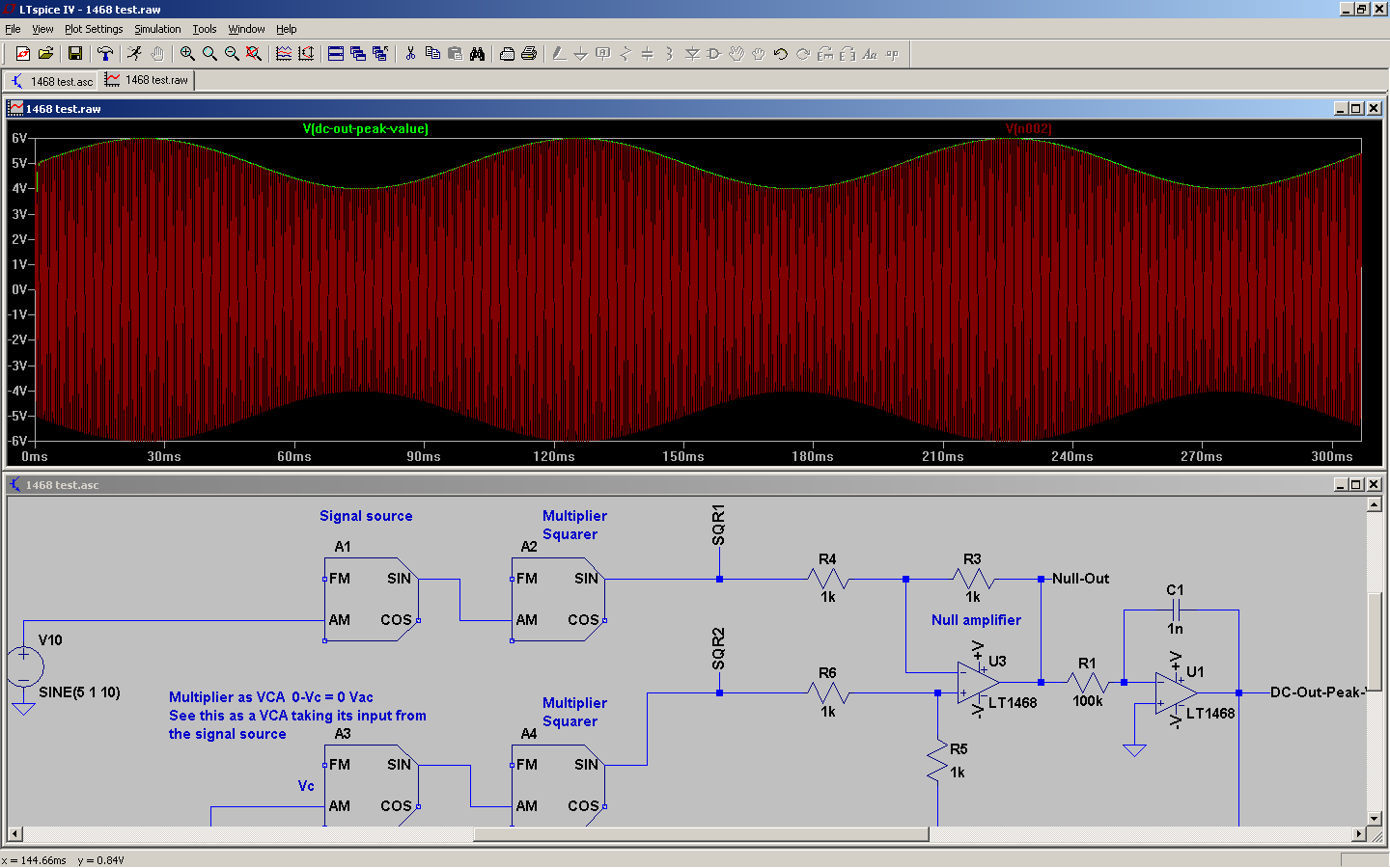

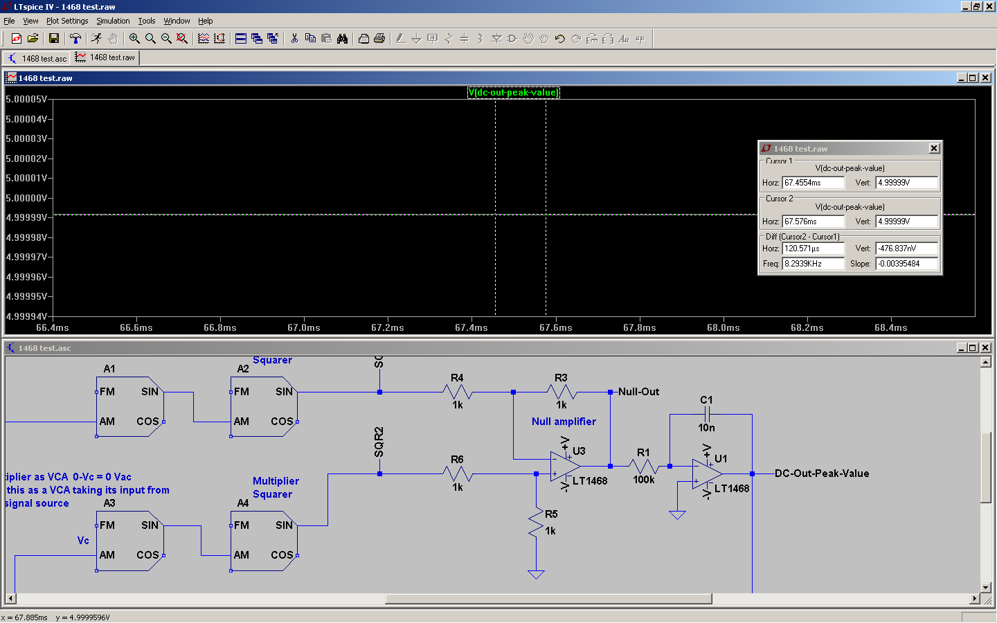

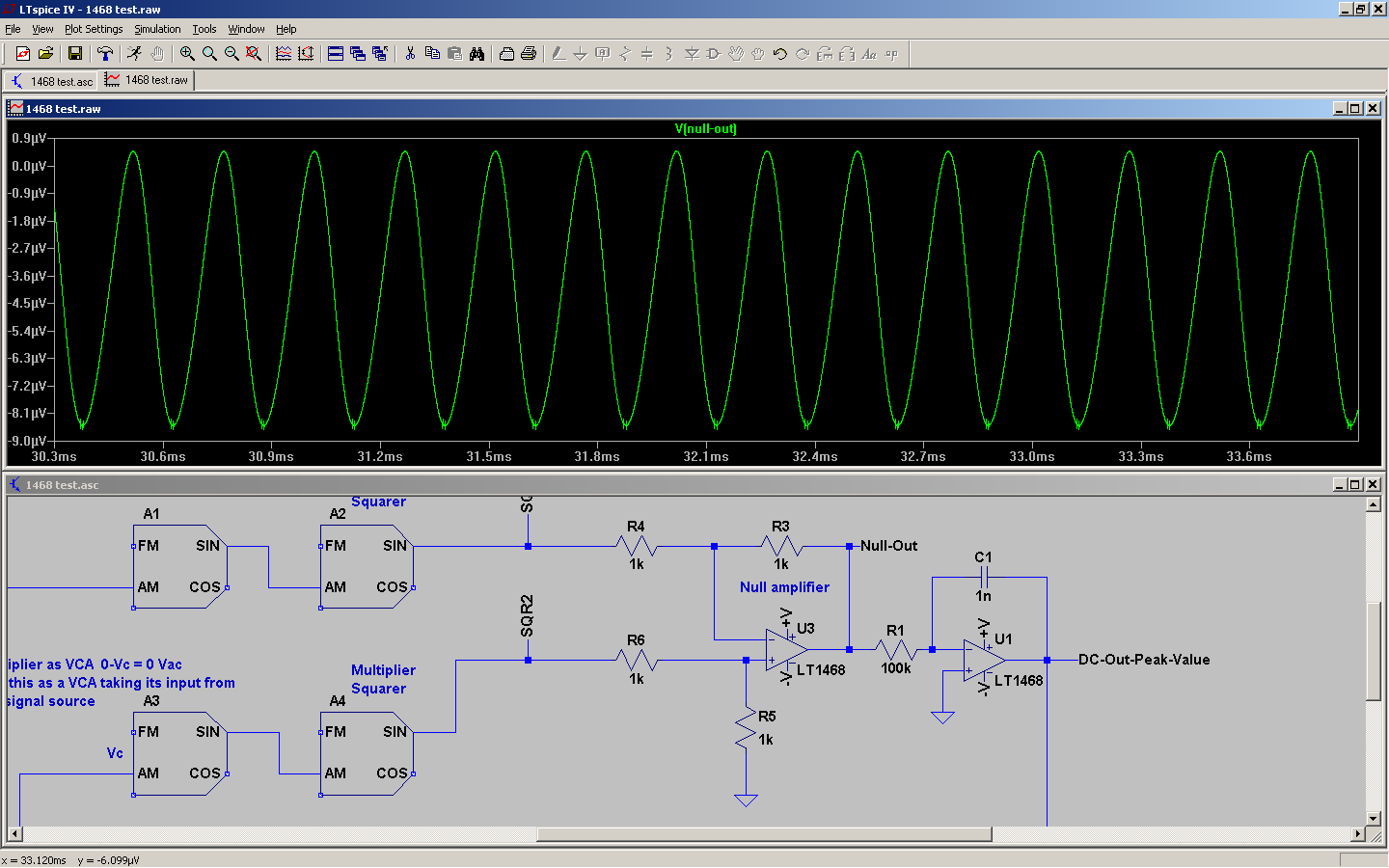

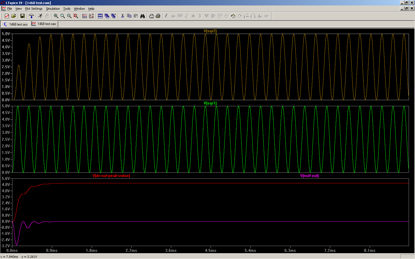

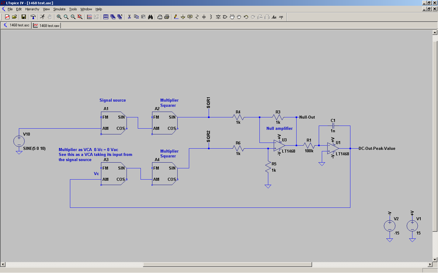

This is a functional simulation.
The signal source is squared by a multiplier. The signal source is feed to the input of a VCA and it's output is squared by a multiplier. The squared source and VCA are input to a differencing amplifier and the output of the difference amplifier feeds an integrator. The DC from the output of the integrator provides an error signal Vc for the VCA. When the squared source and squared output of the VCA are equal the output of the difference amplifier is null, 0Vdc average and the ripple component is in the low uV's. If the output of the VCA is less than the source the DC component at the output of the difference amp is negative and the integrator ramps up. if the output of the VCA is greater than the source the DC component at the output of the difference amp is positive and the integrator ramps down. The system locks the VCA output level to the amplitude of the source and the output of the integrator is a DC value equal to the peak of the source.
The speed of the system response is dependent on the response of the multipliers and the tau of the integrator. The output ripple is a function of the null and not a function of frequency. Therefore the integrator TC can be short. The LP effect of the integrator does help to minimized the ripple though.
The system is not sensitive to component tolerance and any error can be trimmed out.
The last two plots show output ripple from the integrator. The second one for a longer integrator tau.
