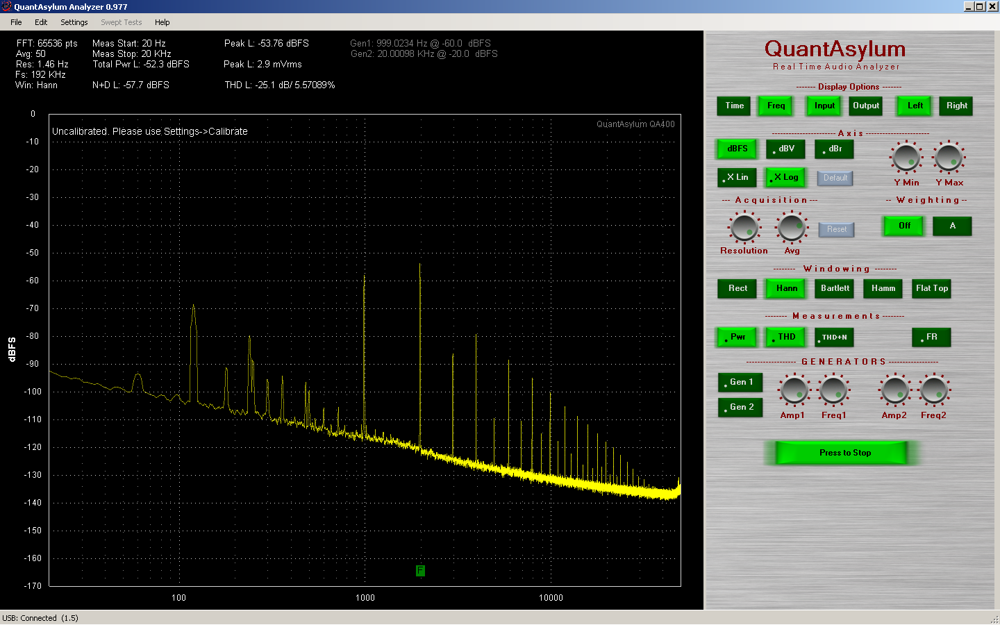

This is the circuit used and spectrum of the output.
For 6Vrms input to the lamp there is a 5.56Vdc output.
At 3Vrms the output drops to 0.823Vdc.
That's not very linear.
I'm concerned about the level of distortion as well.
This is with a 0.1uF feedback cap on the output amplifier.
I's much worse with out the cap.
R is 10M.

But the distortion and feed through is too high and I've lost interest.
