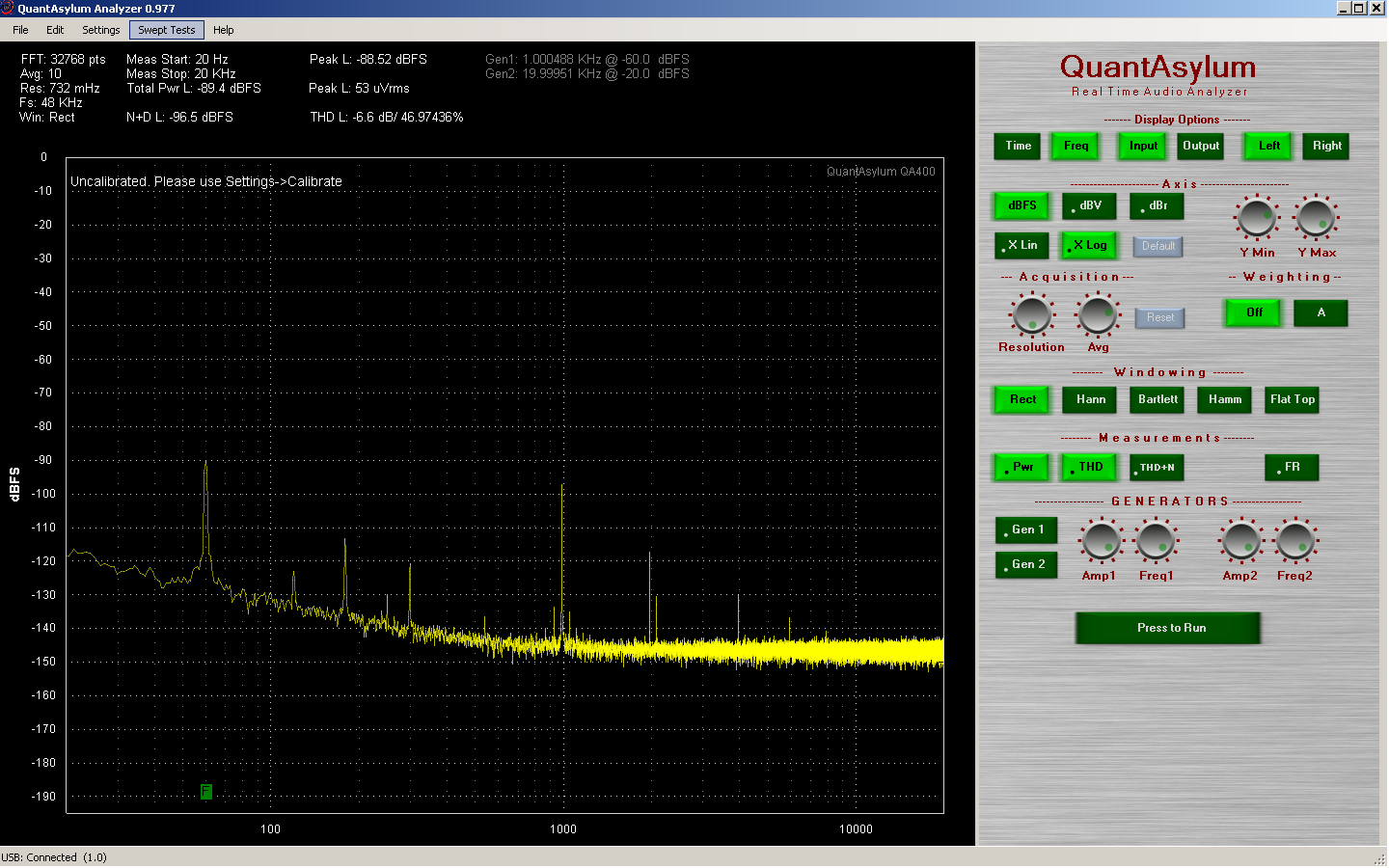

This is the circuit used and spectrum of the output.
For 6Vrms input to the lamp there is a 5.56Vdc output.
At 3Vrms the output drops to 0.823Vdc.
That's not very linear.
I'm concerned about the level of distortion as well.
This is with a 0.1uF feedback cap on the output amplifier.
I's much worse with out the cap.
R is 10M.
Its a lot worse than the results shown in the left paper/page. Why is that?

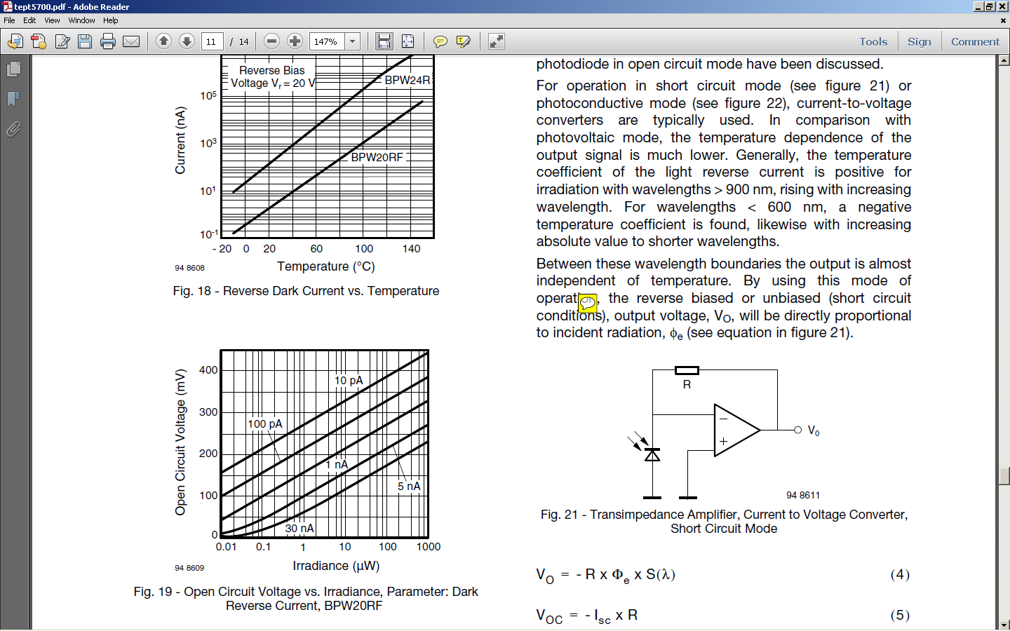

There is some signal transmitted by the lamp to the optical sensor and it is this I'm looking at. What saw on the I posted is about 5% distortion. That's too much for such small signal. So I will try something else. The linearity of the device I used depends on the wave length of the source according to the data sheet IIRC. There is either a positive or negative tempco also dependant on the wavelength of the source.

At 1KHz the output from an AD536A is quite acceptable. All harmonic appear to below -130dB. I have to confirm this once I have the Twin T built and my EMU0204 arrives.
Then I have something to compare the QA400 to.
