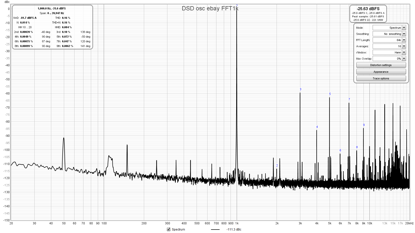

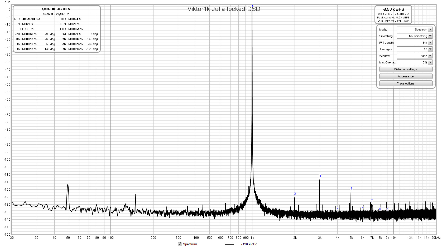

I repeated the test Low-distortion Audio-range Oscillator and intentionally chose high distorted ref clock - cheap ebay dsd generator.
pic1 - dsd gen distortion at 105mVrms, measured by Juli@
pic2 - viktor1k distorion at 750mVrms locked by gen from pic1, measured by Juli@

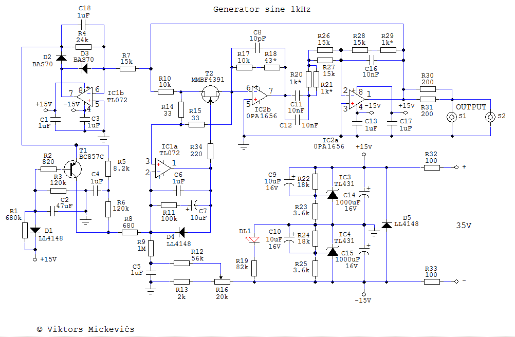

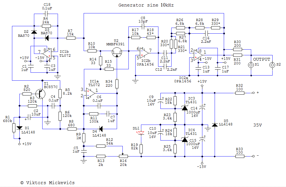

The latest schematics:
https://content21-foto.inbox.lv/albums/e/elterra/OscillatorNew/Gen1kHzN8.png
https://content21-foto.inbox.lv/albums/e/elterra/OscillatorNew/Gen10kHzN8.png
Simplest way for to get the 100Hz is to increase values of the 1kHz version capacitors C4, C6, C7, C11, C12, C16, C18 ten times. I recommend little different frequency instead of 100Hz for better separating the oscillator frequency harmonics from the power line voltage harmonics.
Vic.
Hello. I m about to finish a through hole prototype to use your sine wave oscillator for testing amps and preamps and i have some questions:
Can T1 (BC857C) be replaced with BC557C?
Can you suggest a TO-92 package jfet replacement for T2 (MMBF4391) ?
Any other DIP-8 package opamp to use for IC2 like OPA2134 , ΝΕ5532 or they will degrade performance?
Can BAS70 be replaced with BAT41?
Power supply is a +35V,Ground and not a dual rail +35V, -35V, Ground?
Most questions are easy so I can answer instead of:
1. Yes, BC857C and BC557C is almost the same transistor.
2. Don't know. Possibly, J111 (MMBF111)?
3. OPA2134 will definitely degrade performance a bit. I don't know why people like to use them. There are a lot of much better opamps, many of them cheaper or cost the same. NE5532 is so-so (I won't use).
4. BAT41 - yes.
5. Power supply is 35V total, definitely not +-35V.
Yes.
As Vovk Z suggest - J111
LM4562 or LME49720, but must be tested for noise. Many of them have the "popcorn" noise.
Yes.
35V DC must be single isolated (floating) supply.
Vic.

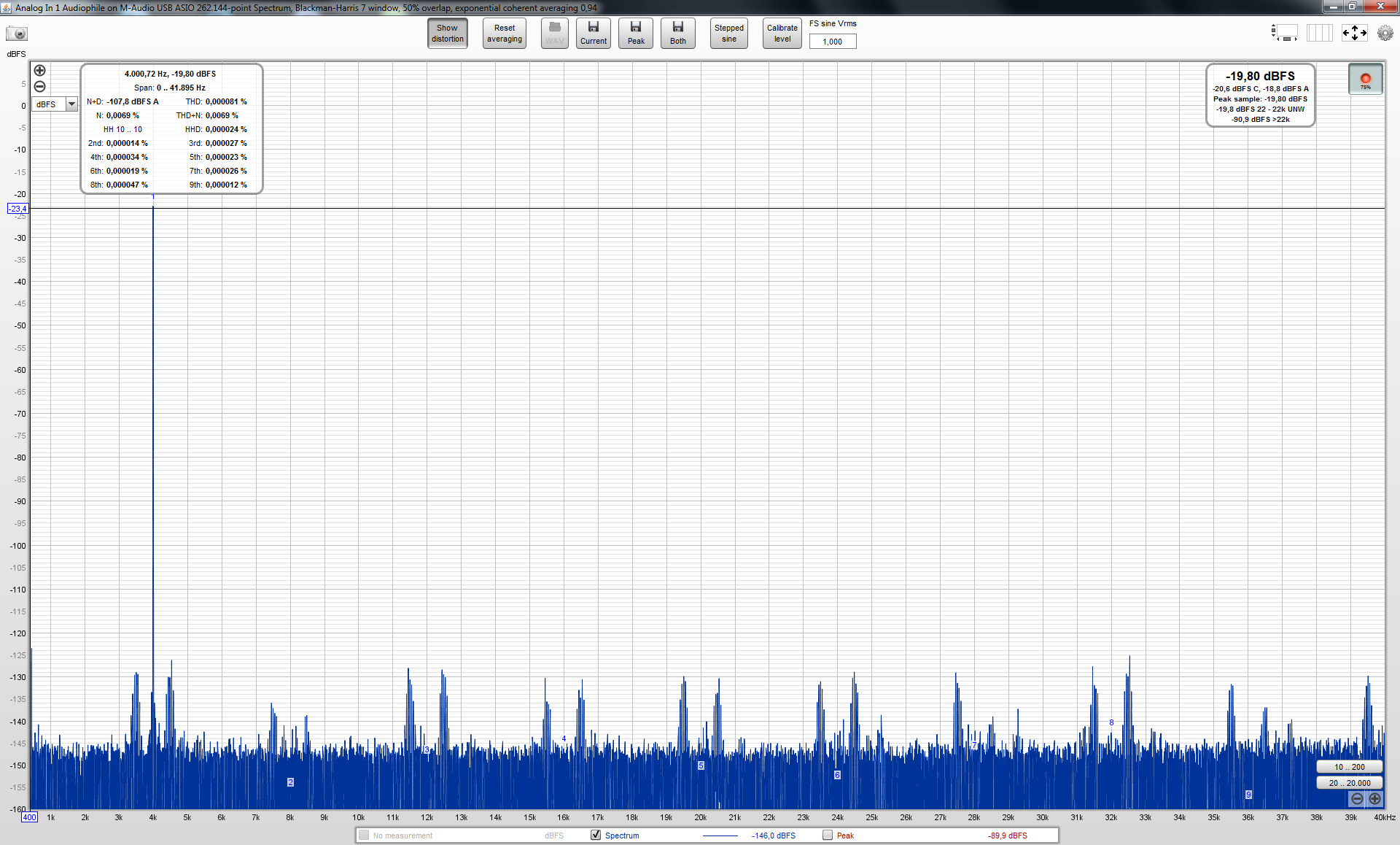

I made a simple opamp oscillator with LME49720, signal passes 2 opamps, no amplitude stabilisation.
With 65mV voltage swing of first opamp, REW shows me a bit unstable THD 0.0001% to 0.0005%, coherent averaging, no notch.
According to datasheet curves its 0.005% for such low output voltage.
Will it be much better at 3V ?
I possibly can not go > 300mV, what can I do ? Force opamps into classA ?
Thanks, it looks just like normal noise to me.
LME is classA ? But older NE5532 is not ? because sometimes suggested to tie a resistor to V- to force into classA.
From LME datasheet, THD is getting better with higher output voltage until peak at 3V, then worsens again.
Can you confirm this ?
