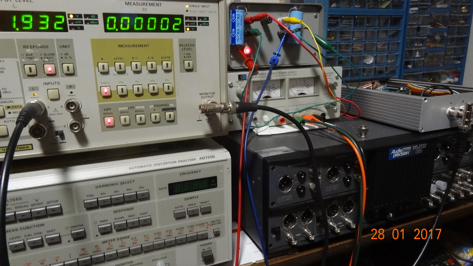

How low do you want to measure? -160 exists off-the-shelf. I saw 4-5 ShibaSoku 725D for sale on ebay at low price. First time in years. Probably all gone now. But, it is crammed full of electronics to do the job. Way beyond DIY IMO.
The Panasonic goes to -140 and is avail for about 1200-1500 USD frequently. Its internal osc measures at -135-ish. Does IM also.
Just as we did with the HP339A, they can be improved with opamp upgrades and selected parts changes.
The osc are generally worse than the analyzer capability.

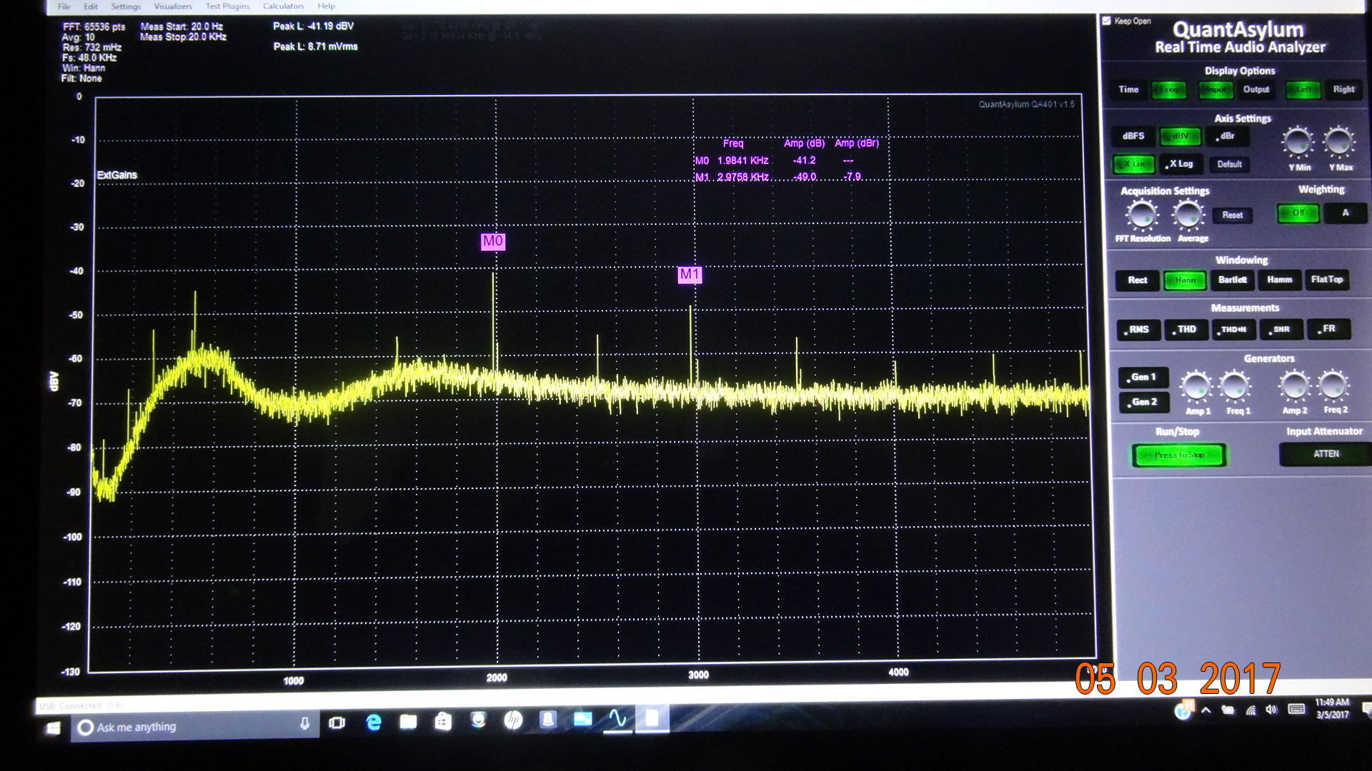

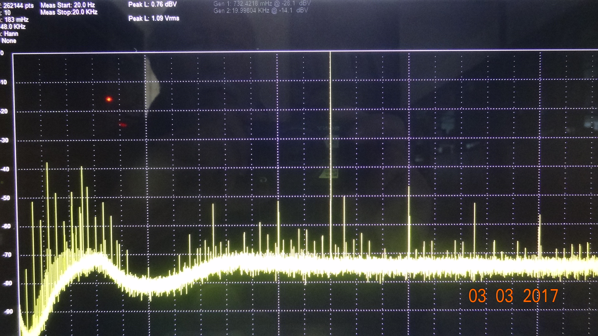

Here it is being tested by the Panasonic. It couldnt accurately measure it, so I went to the ShibaSoku and QA401 on the monitor port.
