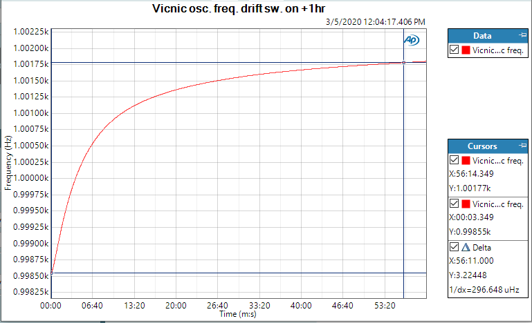

AP recognized the issue and solved it in software. My 2722 has that function but the newer models seem to have lost it. Instead of moving the hardware oscillator to 'bin center' it moves the samples to fall in bin centers, allowing high resolution windowless FFT. Anyone with some proficiency in say MathLab or Octave should find this a trivial exercise ;-)
Isn't this just a software SRC? For long averages the temporal drift still matters.
Yes it is. After warm-up, the Vicnic is relatively stable during a measurement period.
Jan
The devil must really be enjoying his ice skates! (Semi inside joke.)
I have been running more resistor distortion tests and one option is to lock the FFT to the signal source. It takes a bit for the label acquiring signal lock to go away and the measurement to begin. Not sure how stable it stays for all the 1024 measurements as I see the test signal leakage increase in level with changes in test frequency. I am using the AP system 2 internal signal source.
All the resistors match to better than 1 part in 1,000 so even at low test voltages I am able to look below -160 dB.
All this is after three days of warm up in my office. Might just need to turn off the room's set back thermostat.
