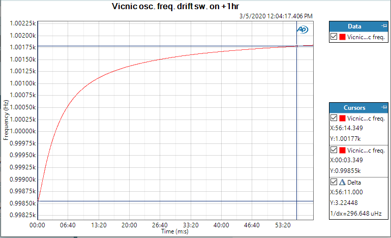

Vicnic's 1kHz oscillator cold start, initial freq. drift. Ambient was 22C, osc. in hermetically closed metal box together with SilentSwitcher.

Interesting to know. Did you happen to measure the THD level during that time period?

No I didn't check THD at that time.
BTW I run my Vic oscillators from a SilentSwitcher (currently sold out but coming end of May to the diyaudio store again!)

Thanks, Jan! Good work. On the other side, how confident are we in your measurement clock? The maddening things that happen when we add too many zeros to our goals. :)
I can't remember what sort of bin size you were aiming for, but might be a case of needing to go to heroic insulation to get the drift down to nothing. Drill a couple holes in a styrofoam cooler and fire the thing up in the morning before afternoon experiments. :) Hopefully by then you'll be in wobble-land rather than a clear exponential decay regime.

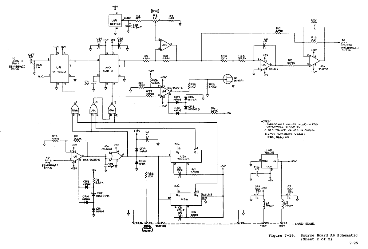

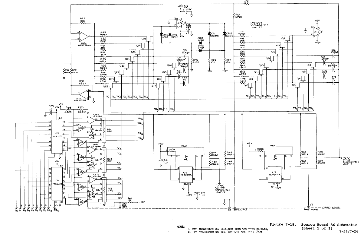

FWIW attached are the schematics of the Boonton 1120 (21, 10) source board. its a state variable oscillator with a very precise leveling loop as you suggest. It uses analog multipliers for both level and frequency trim. There is a Z80 and a TXCO for measuring the frequency and a DAC for the fine tuning.
Its an older design and shows some of the limitations from the 1980's when it was designed. There are a number of limitations but still had great potential. Biggest issues are the analog multipliers. need to find better ones that can be retrofitted. Then the nonlineatity of the Jfets. Early 1120's used a PN4391 with 30 Ohms RDS. Later use a J108 with a lower RDS and the distortion contribution is clearly lower.
I just did some measurements on some J108's as switches. With a 4.7K resistor to source and a 600 Ohm 3V source I get about .1% 2nd @ 20 mV across the fets. Lower Rds on (ranges from 4 to 5 Ohms on the samples I'm testing) correlates with lower distortion. If used with a 5K resistor the nonlinearity should be attenuated by 60 dB or below -120 dB. Still selecting will be important.
