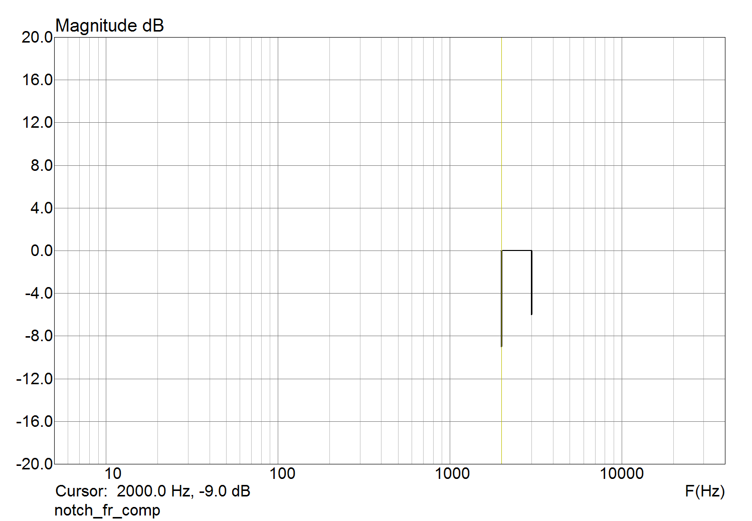

I've been playing with a post-notch amp that amplifies the second by 10dB and the 3rd by 6dB, then returns to 'flat'. Not sure it is worth it.

This actually sounds like a good idea. I've toyed with this idea as well, but have not done anything with it. A highpass filter with a peak at 2 kHz might be one approach, but I'm not sure if the Q could be adjusted in such a way that the needed gain at 3 kHz was achieved without additional shaping circuitry. A useful objective is to achieve the overall shaping without degrading the notch depth. There is a decent chance that the peaked high-pass filter would actually improve notch depth. It also seems reasonable that achieving overall flatness at frequencies other than the 2nd and 3rd harmonic may not be that important.

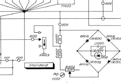

This is the harmonic generator in the Radiometer CLT-1 used for checking the harmonic level calibration. The whole circuit is spread across several scans and can be quite hard to follow. Its quite similar to Victor's implementation. The key is standardized levels for both fundamental and harmonic. When I was checking the Shibasoku it was clear that the impedances and mixing networks were critical to get an accurate harmonic level. Not working it all out can easily get an unintended 6 dB error.

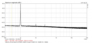

This simple schematic probably can be used for to test the harmonic measurement levels, directly or via the notch filter.
The simulation shows these harmonic levels across the D1 diode rated to the input signal 2,7V RMS (my oscillator max output):
Fundamental -11,6 dB
Second -27,4 dB
Third -27,5 dB
So, the second and third have almost the same levels. These levels can be adjusted more equal with the resistor R2 via the direct measurement, if needed.
The levels at "out1" would be for -80dB lower, and "out2" for -40dB else. Finally, the second and third would be around -147,5 dB.
Now the simulation was tested on the real prototype. It looks like extreme "High End" 🙂 I needed to remove all copper traces, exclude ground, on the prototype board to eliminate the parasitic capacitances :
https://content23-foto.inbox.lv/albums/v/viccc/HCT/HSimP.jpg
I placed one capacitor in the final schematic for to remove the DC from the output:
https://content23-foto.inbox.lv/albums/v/viccc/HCT/HCF.png
The measurement results are perfectly the same as simulated. That was good test for my measurement set up, and for to know how the real things work.

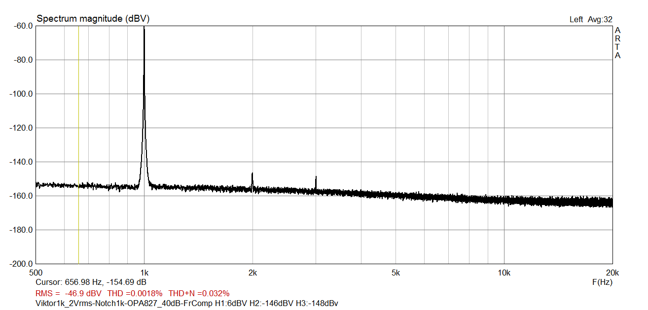

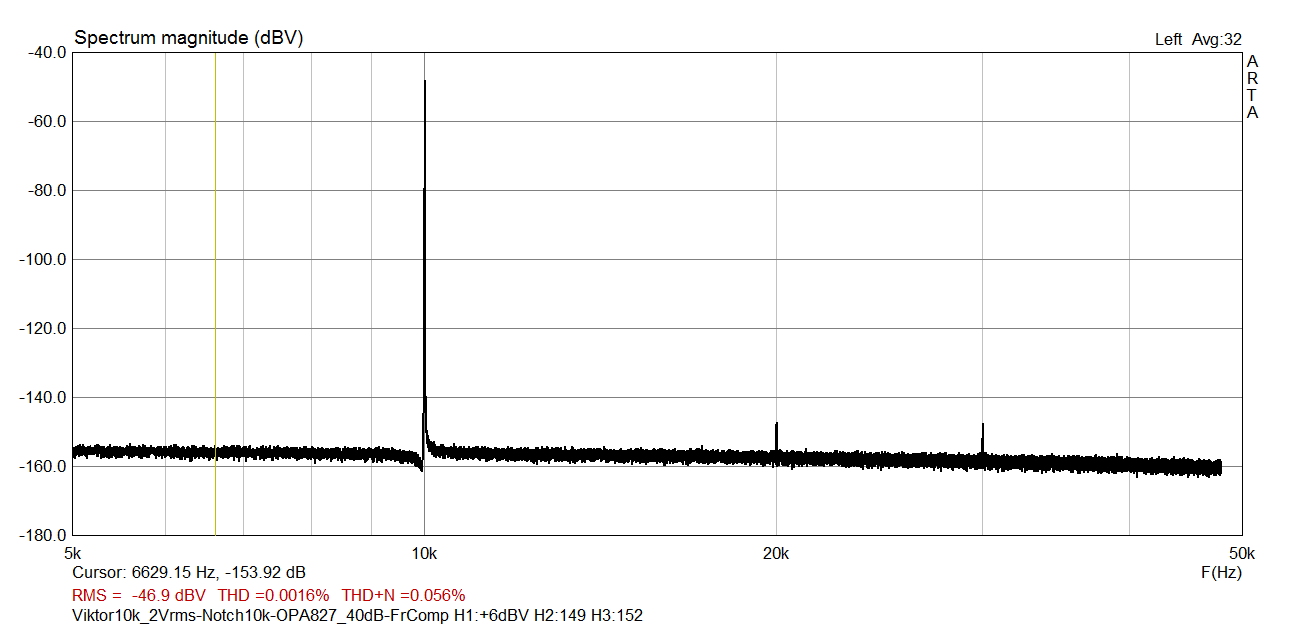

The measurement with the notch, FFT length 524288, 3 times averaging, sample rate 96kHz (the scale was adjusted to read the third harmonic without calculations):
https://content23-foto.inbox.lv/albums/v/viccc/HCT/HSimN.jpg
In the same measurement chain without the notch (removed and shorted):
https://content23-foto.inbox.lv/albums/v/viccc/HCT/HSimD.jpg
I have not seen any smoothing or smearing effects. The oscillator was warmed up before the measurements, of course.

same measurement as here
Low-distortion Audio-range Oscillator
but H2 H3 compensation is used in Arta

You never stop learning.......no, check arta user manual, page 22

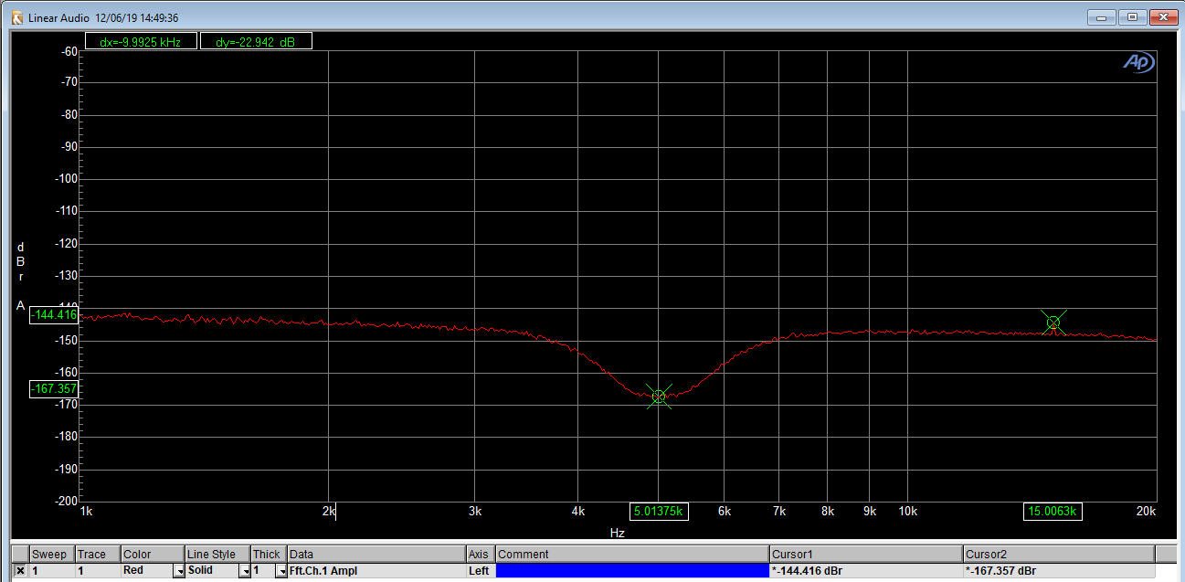

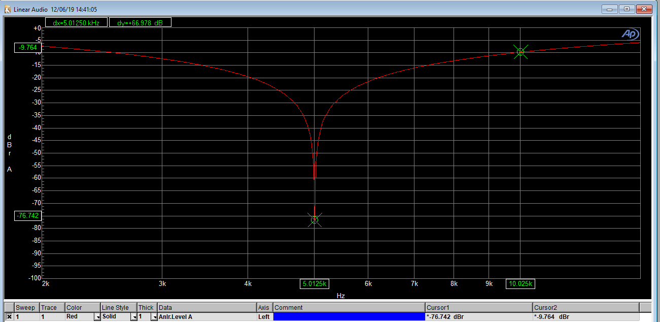

Build up a 5KHz twin-tee on one of LKA's PCB. Attached the freq response.
Also measured Vicnic's 5kHz oscillator with the 5kHz twin-tee in the line to the AP. The 2nd is invisible below the noise floor, the 3rd just peaks out at -144.5dBr, 1V out.
Vic is this what is expected?
Jan
Jan
Jan, do you try the osc. in the balanced mode?Build up a 5KHz twin-tee on one of LKA's PCB. Attached the freq response.
Jan
I found my measurements of your 5kHz board (second needs +4dB).
Maximum output. Probably the measurements was done on each output separately:
https://content26-foto.inbox.lv/albums/v/viccc/JanD/5kHz2.jpg
https://content26-foto.inbox.lv/albums/v/viccc/JanD/5kHz2A.jpg
No, the second graph probably is averaged.Jan, do you try the osc. in the balanced mode?
I did use it in se mode, 32 averages. Possibly I see the AP residual distortion of the A/D converter. I will further investigate.
