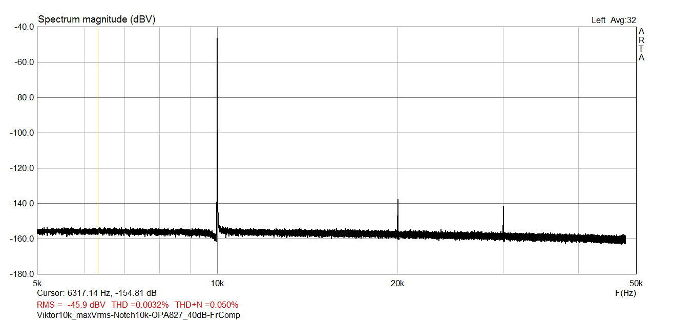

Low-distortion Audio-range Oscillator
Viktor10k@2Vrms -> Passive_Notch10k -> OPA827_40dB -> ARTA_H2H3_Compensated
H1 +6dBV
H2 -149dBV
H3 -152dBV
ARTA
FS:96K FFT:128K Wnd:Han Avg:Lin
🙂 Better than I measured by myself. The output level is the difference. At maximum output the 10kHz boards with LME49720 typically show H2 little lower than -140dB. The new boards with OPA1656 for app. 5dB better.
10k osc (bought Sep 2019) at max output
unbalanced

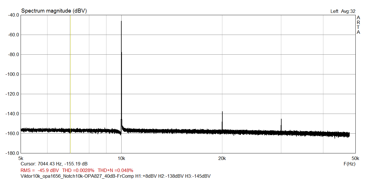

I just replaced LME49720 with OPA1656 in my 10k osc. Confirmed, little better thd and noise.
H1:+8,+9dBV (osc max output, not measured exactly)
H2:-138dBV
H3:-145dBV
(notch h2,h3 compensated graph)

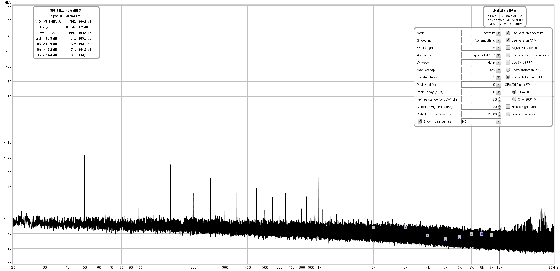

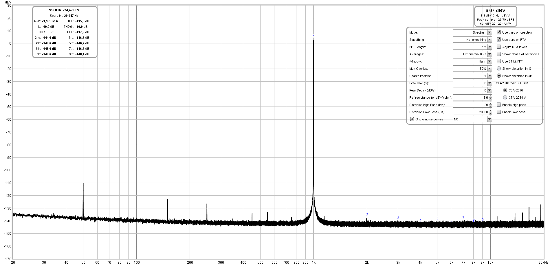

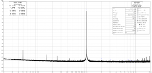

After initially troubles with Victor's oscillator and Victor's "witchcraft" finally measurements es it should bee:
2V 1kHz signal without a notch (on RTX6001 30dBV input) exhibits almost no visible harmonics content and THD of -135dB.
And the same 1kHz signal at max. level-almost 3V, measured with notch on most sensitive RTX6001 input (0,1V), exhibits no visible harmonics. According to Victor, notch harmonics attenuation is app. 9dB for the second harmonic and app. 5dB for the third harmonic, so in the worst case 2H is at app. -156dB and 3H at app. -159dB down.
Oscillator was powered with Jan's SilentSwitcher (abused from AutoRanger) and measured unbalanced and unshilded!
It is interesting how mains harmonics content is now also lower than measured before.
Victor, thanks a lot:xmastree:
