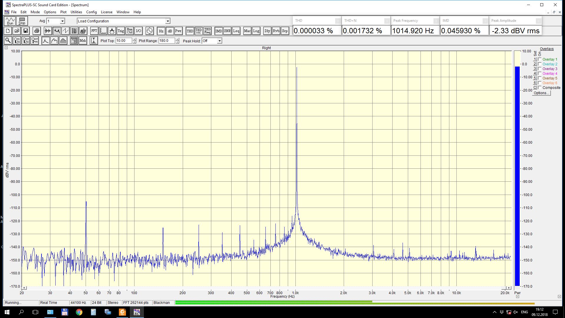

I would propose that you measure the connections in the adapter. There are numerous ways to connect them internally. Typically pin 3 is left unconnected inside which will compromise measurements.
I would connect pins 2 and 3 to the RCA and bring pin 1 out on a separate wire for a ground connection to the source chassis.

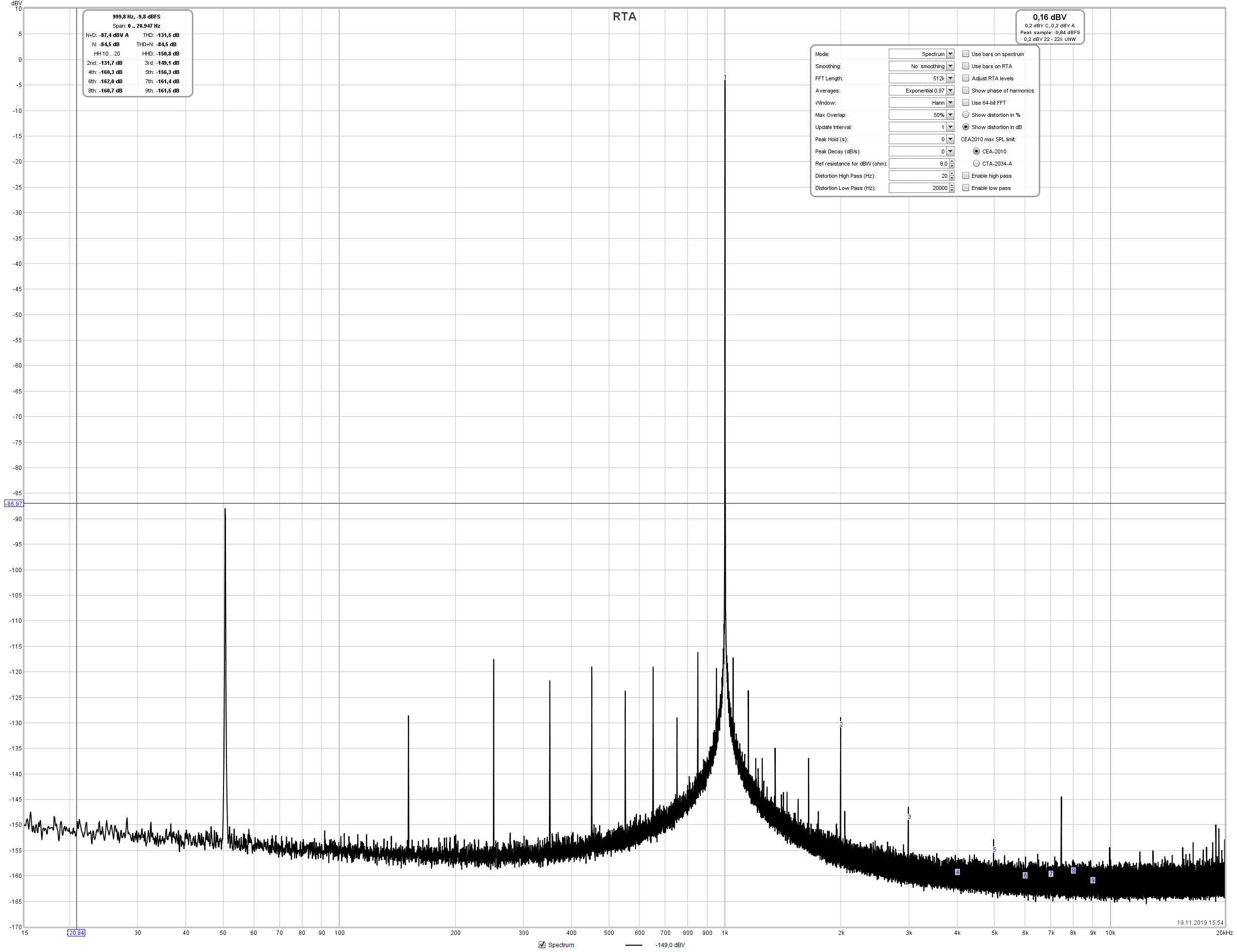

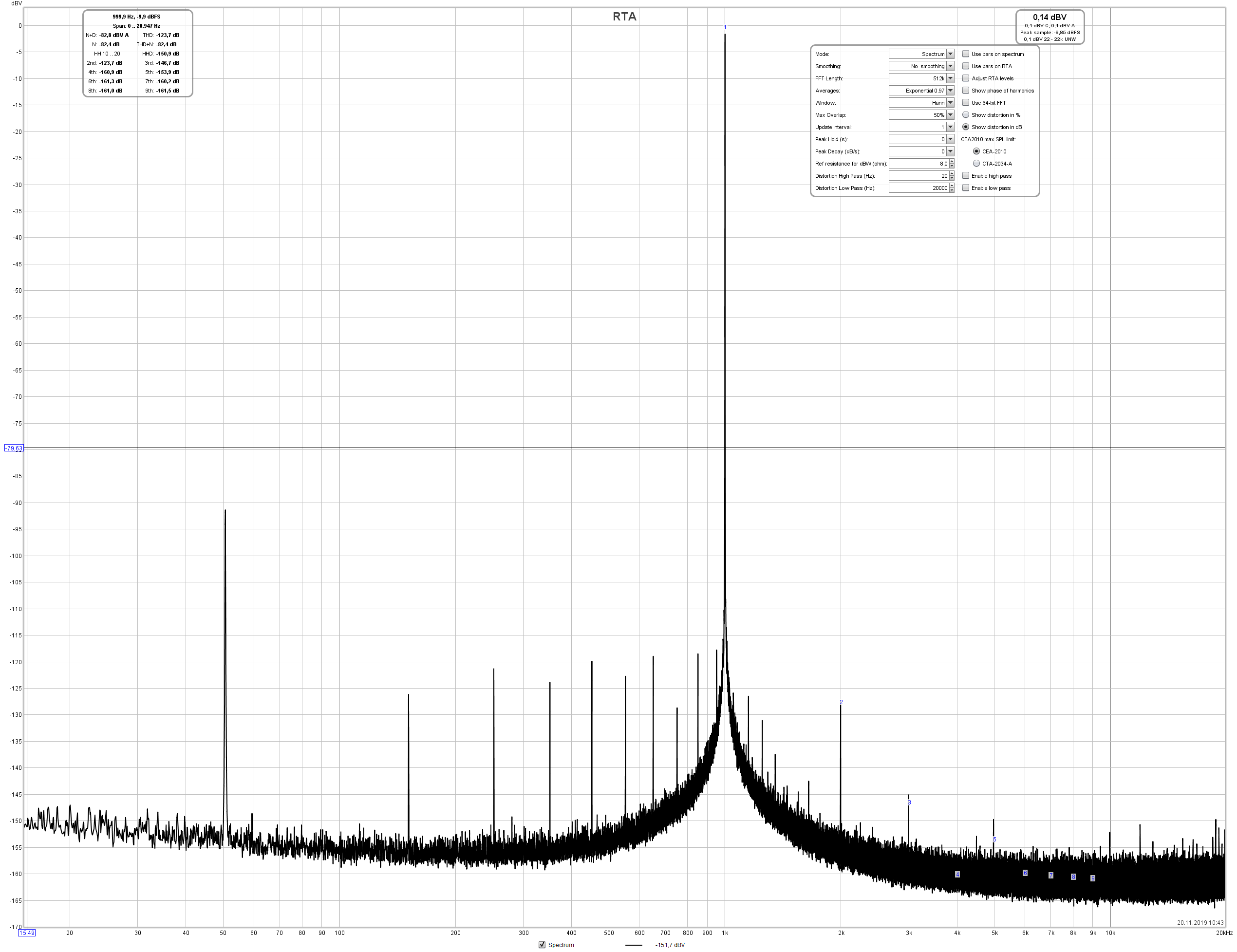

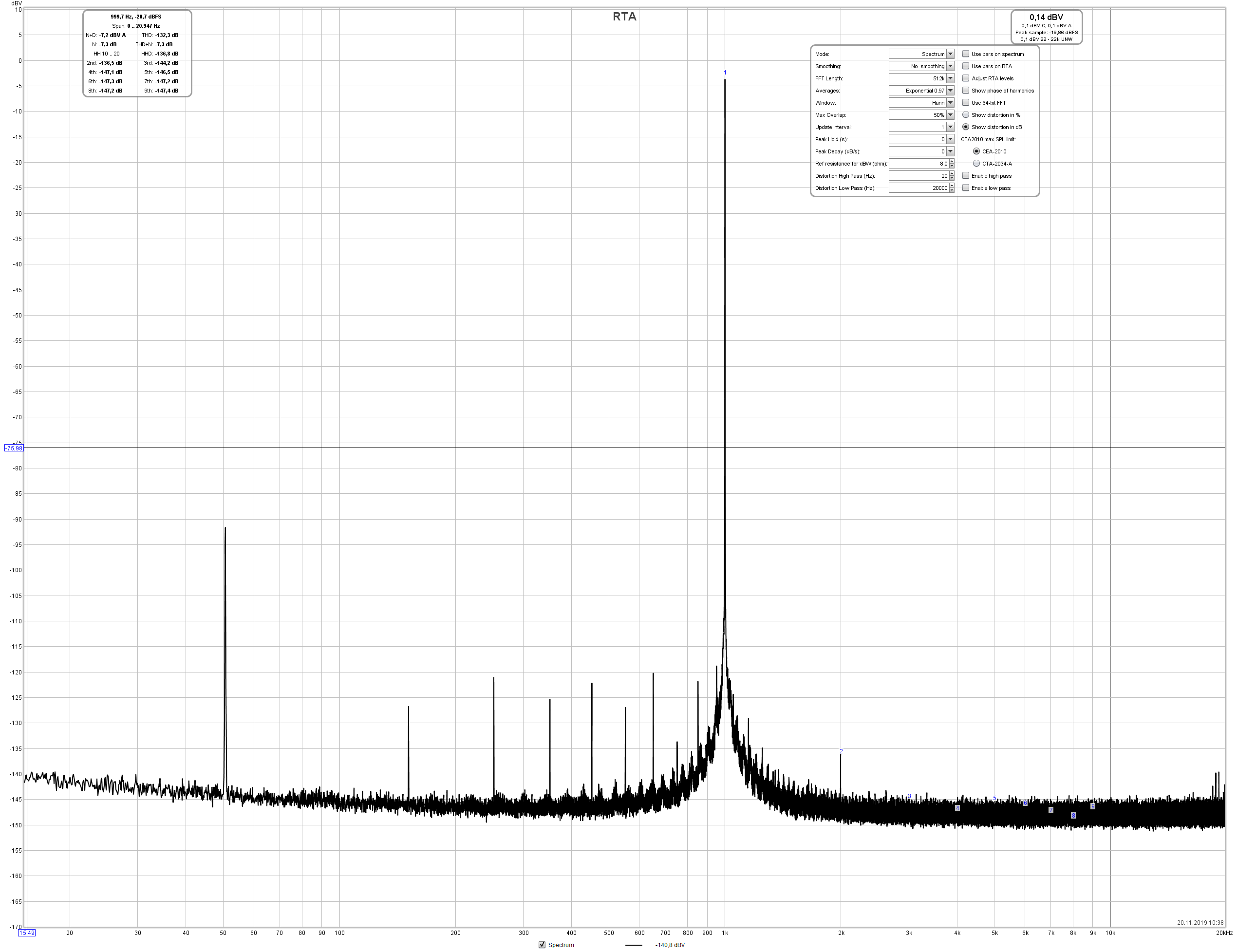

I have followed Demian's and Jens instructions and have made a new cable + separate grounding.
Interference pattern is maybe a bit quieter now, but THD and harmonic intensity is more or less the same.
On 3,16V range and 1V signal THD and harmonic intensity remains the same
-123dB for THD and 2H.
https://www.diyaudio.com/forums/attachment.php?attachmentid=796233&stc=1&d=1574249877
https://www.diyaudio.com/forums/attachment.php?attachmentid=796234&stc=1&d=1574249877

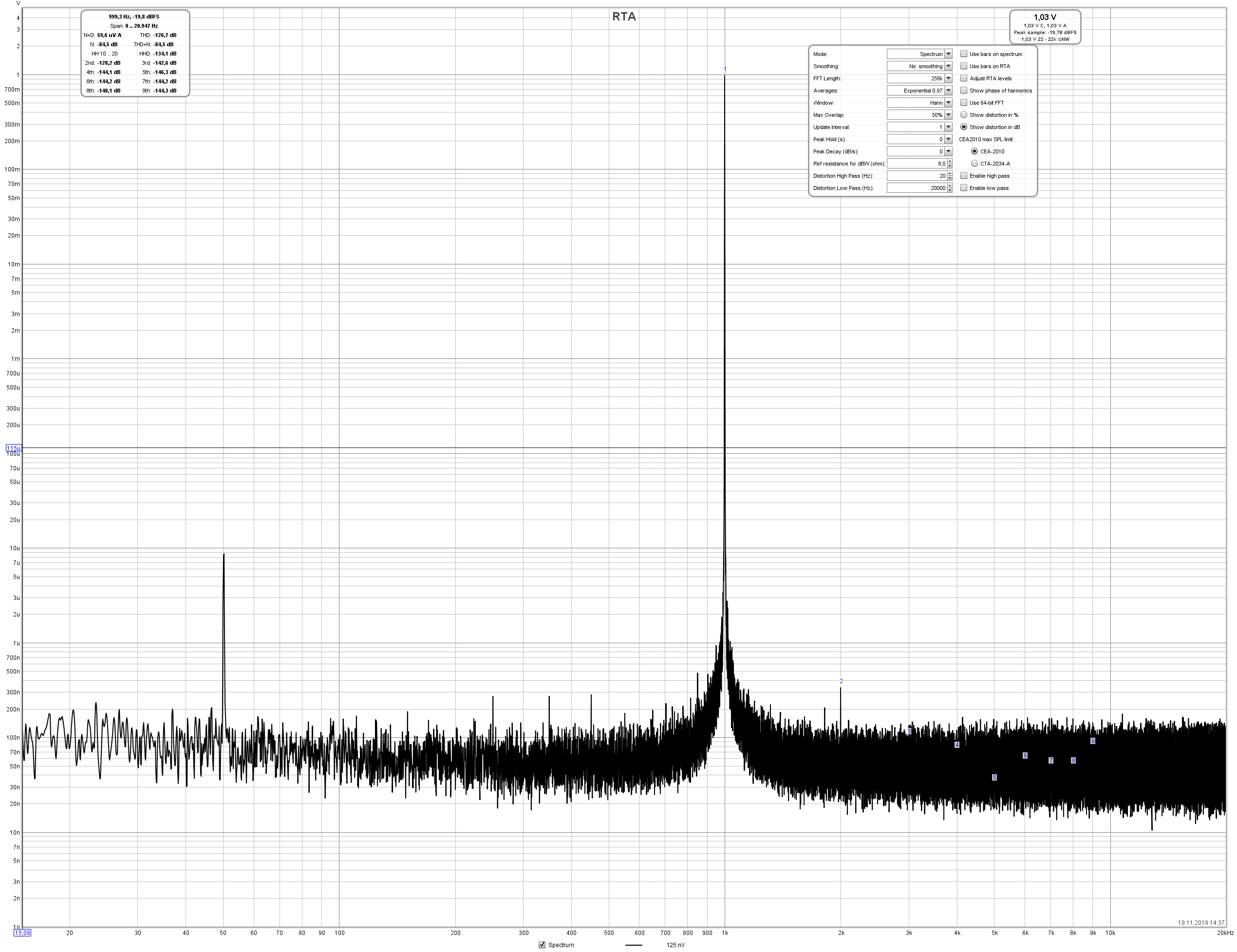

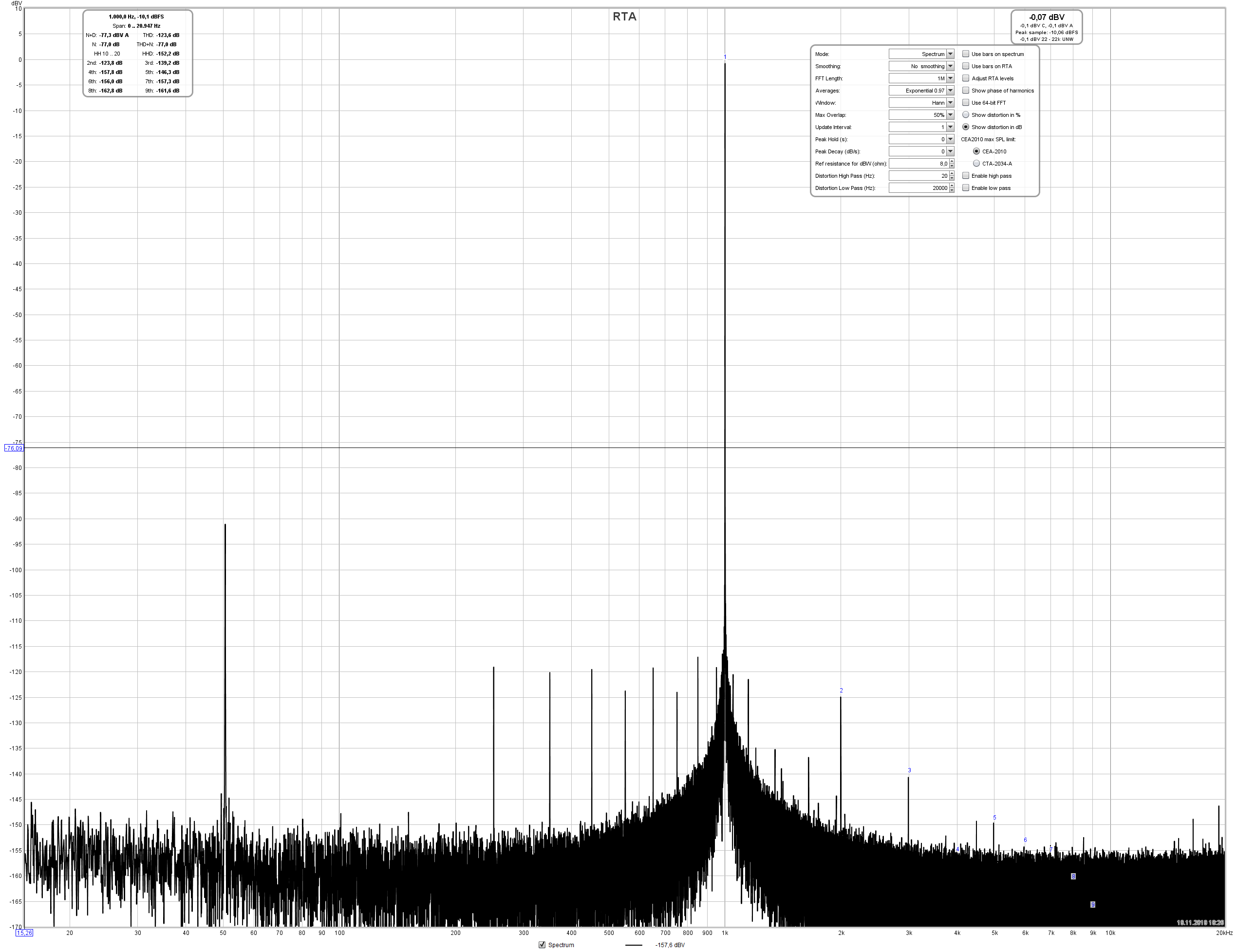

Only on 10V input range and 1V signal, pattern become improved, THD was -126dB now is -132, 2H was -128dB now is -136dB (I have made averages time longer, so that could be the reason for better result)
https://www.diyaudio.com/forums/attachment.php?attachmentid=796235&stc=1&d=1574249995
https://www.diyaudio.com/forums/attachment.php?attachmentid=796236&stc=1&d=1574249995
It seems that I have still problem with to many interferences, but also with osc. itself-harmonic content is simply to large.

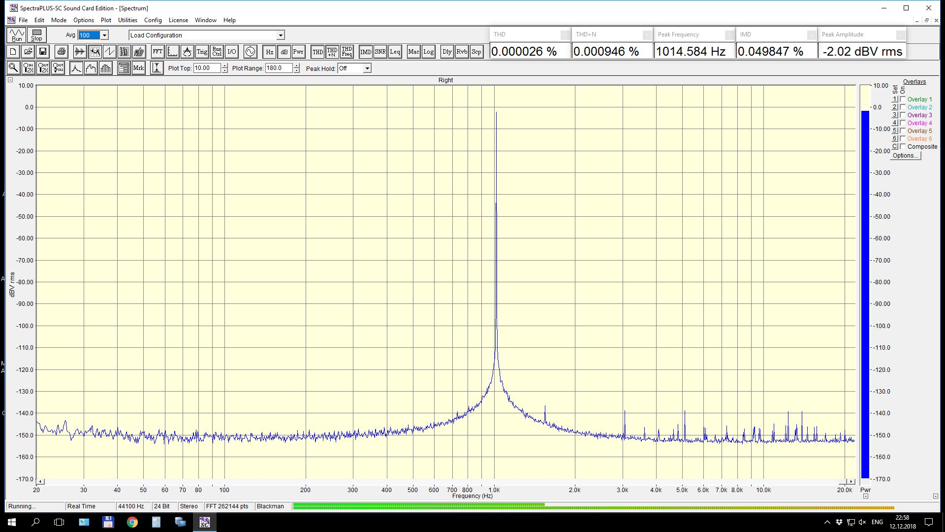

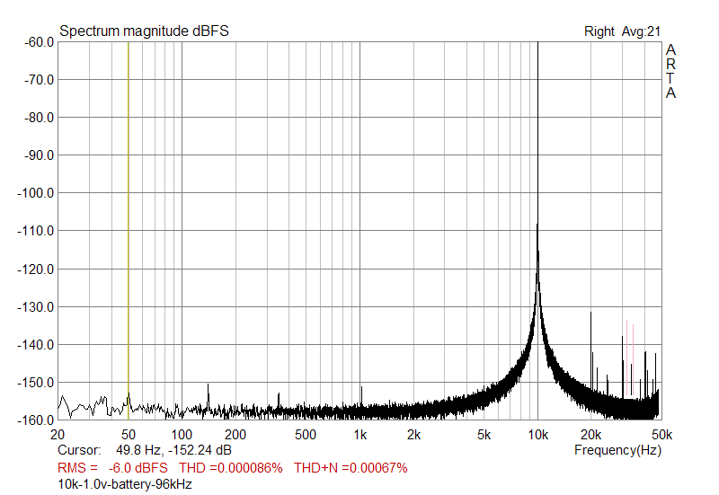

10 kHz Victor's oscillator
Here is an exaple of one of my old spectrums, 10 kHz original Victor's osc, unbalance cable of cause (1.5 or 2.0 meters of RG58 or RG59 coaxial, I don't remember exact type, about 6 mm diameter), battery powered, aluminium 1.5 mm case:
