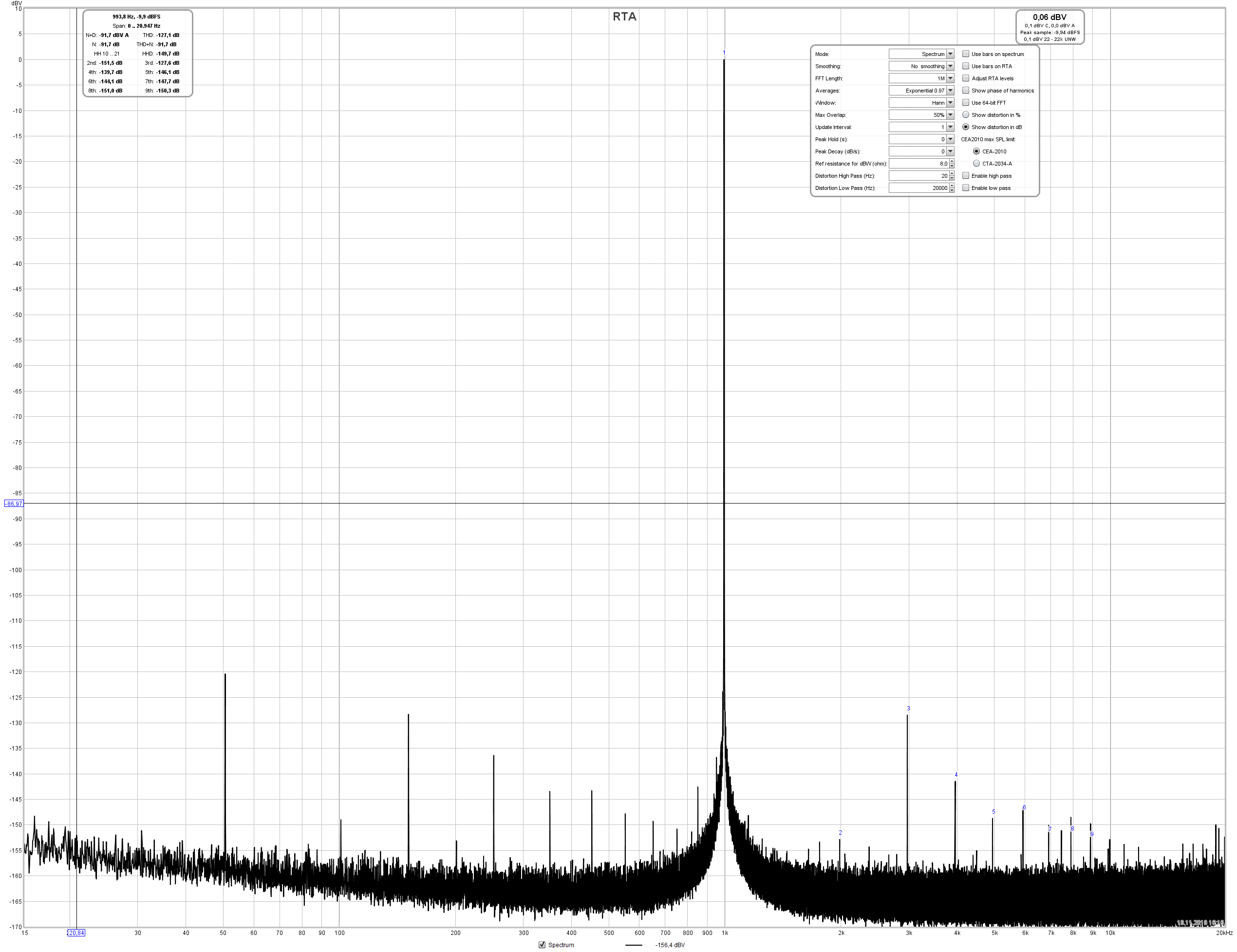

Thank you. The performance of the 1kHz oscillator is limited not only by the opamp, but of course all the new boards now are coming only with the OPA1656. One of the advantages of the OPA1656 is little lower noise around the all measurement region. The LM4562/LME49720 works also very good. The reference source in these measurements is my old hand made PCB board which runs with LME49720. The schematic is the same as the new boards have. The harmonics performance of the serial boards are in -152dB...-160dB or little lower region. This old board runs on the top.Do I surmise correctly that your oscillator now uses OPA1656 in the reference trace you posted in #8033? Reference measurement without the follower before the notch-
https://content23-foto.inbox.lv/albu...lowers/Ref.jpg
Your distortion residuals are astonishing! Since it's absent in the oscillator output, the very small distortion shown in the last voltage follower trace probably arises from common-mode distortion errors? They are not present in the oscillator because the opamps are inverting?
Outstanding work!

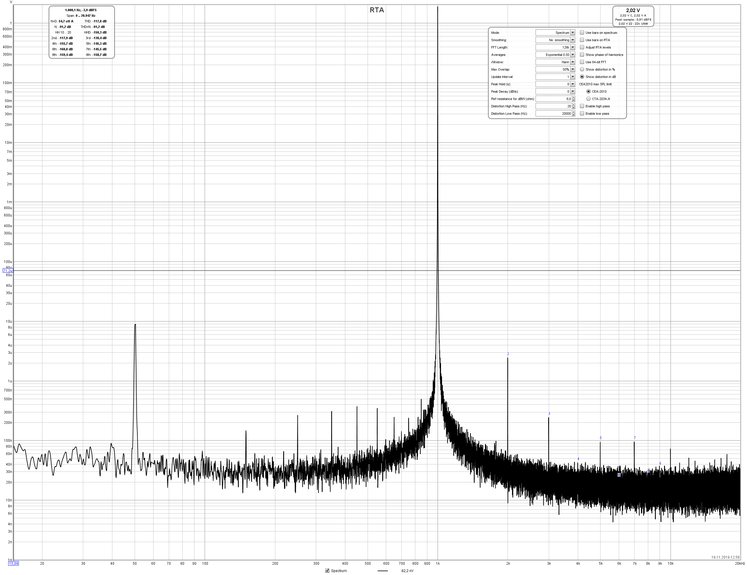

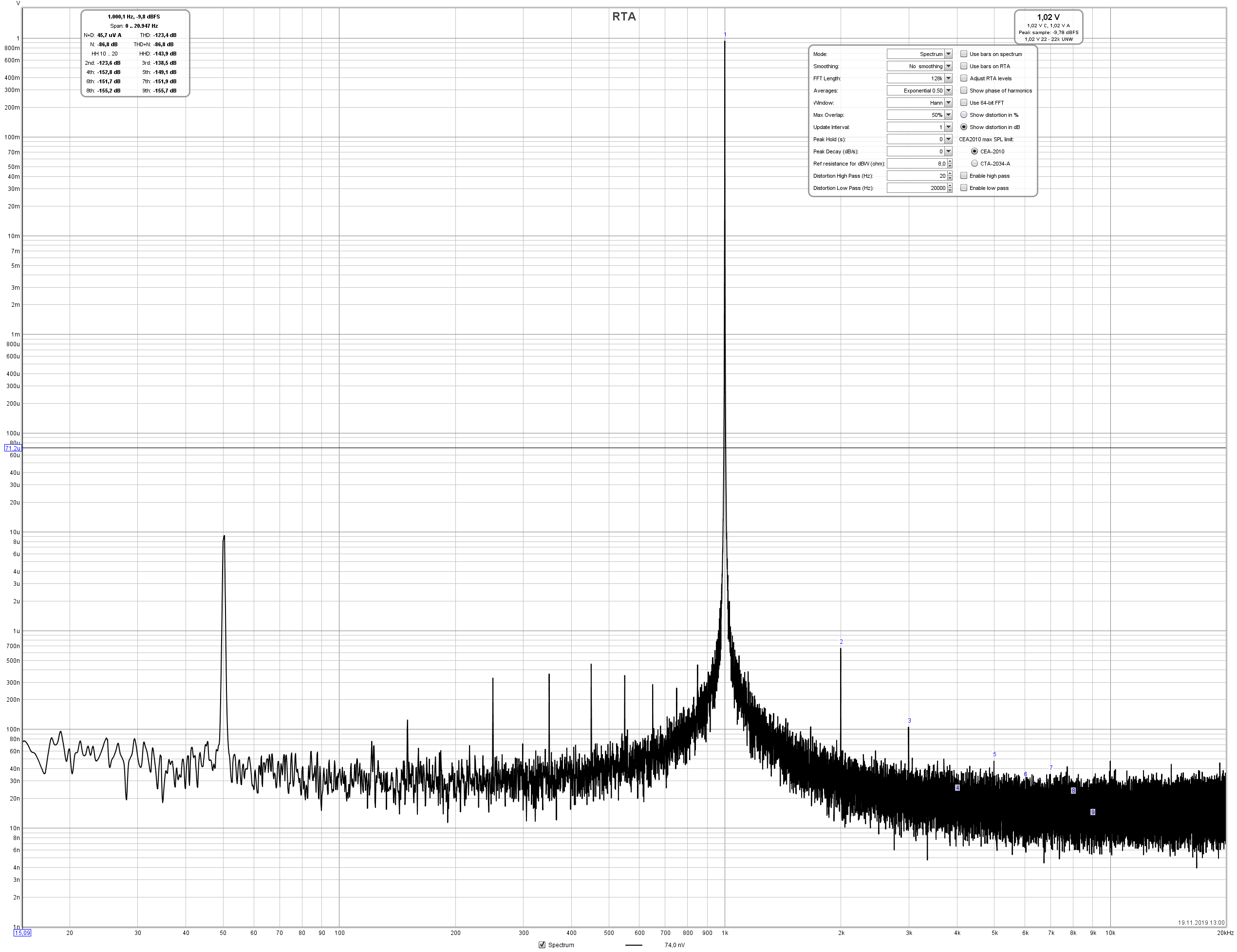

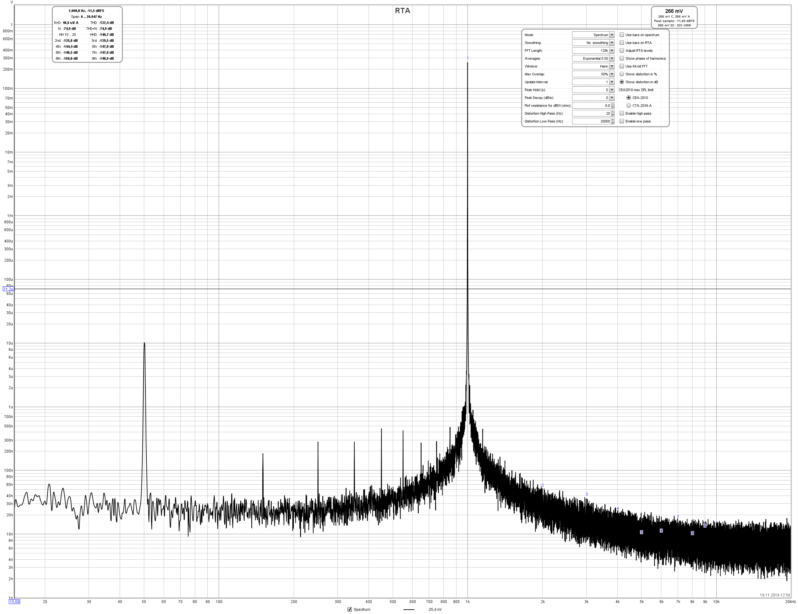

Here are the plots of my 1kHz Victor osc.
Only by 266mV output is max THD (-132,4) achived.
By 1V or 2V THD is significulti higher (-123.4 and 117.8),
second harmonic is to high.
Anny clue why is that so?
Powerd is by Silentswitcher,the same is with batteries.
Osc. is measured direct on RTX6001, without anny noch.

You might get a slightly better result at 266 mV by increasing the FFT window size, since the harmonics are buried in the noise.
At the higher levels I agree that the limitation is probably the ADC.
If you want to measure in the order of -150 dB, you will need a notch filter.

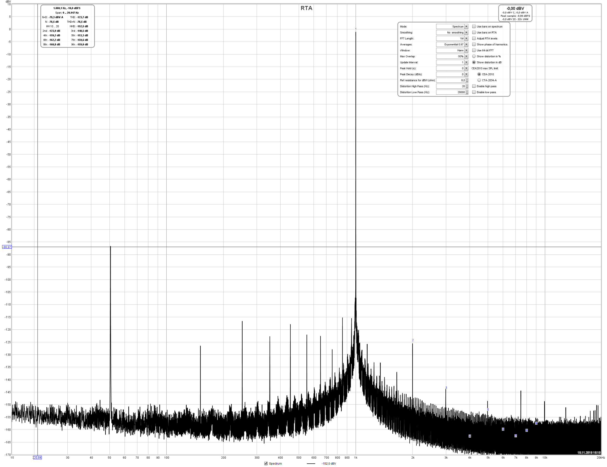

Tnx Jens,
now I have made 1M FFT on 3,16V input range with 1V signal:
Victor osc. have shown THD -123,7 nad 2H was -123,0dB
339A osc. have THD -127,1 and 2H on -151,5dB
So, it can't be limitation of DAC
Probably is something wrong with my Victor osc.?
Any help or advice on troubleshooting will be highly appreciated.

50 Hz noise level is a little bit too high. If you say that with batteries you have the same than it can mean that your connecting cable isn't good enough.Here are the plots of my 1kHz Victor osc
I made my cable with RG58 (RG59?) and have better picture.
