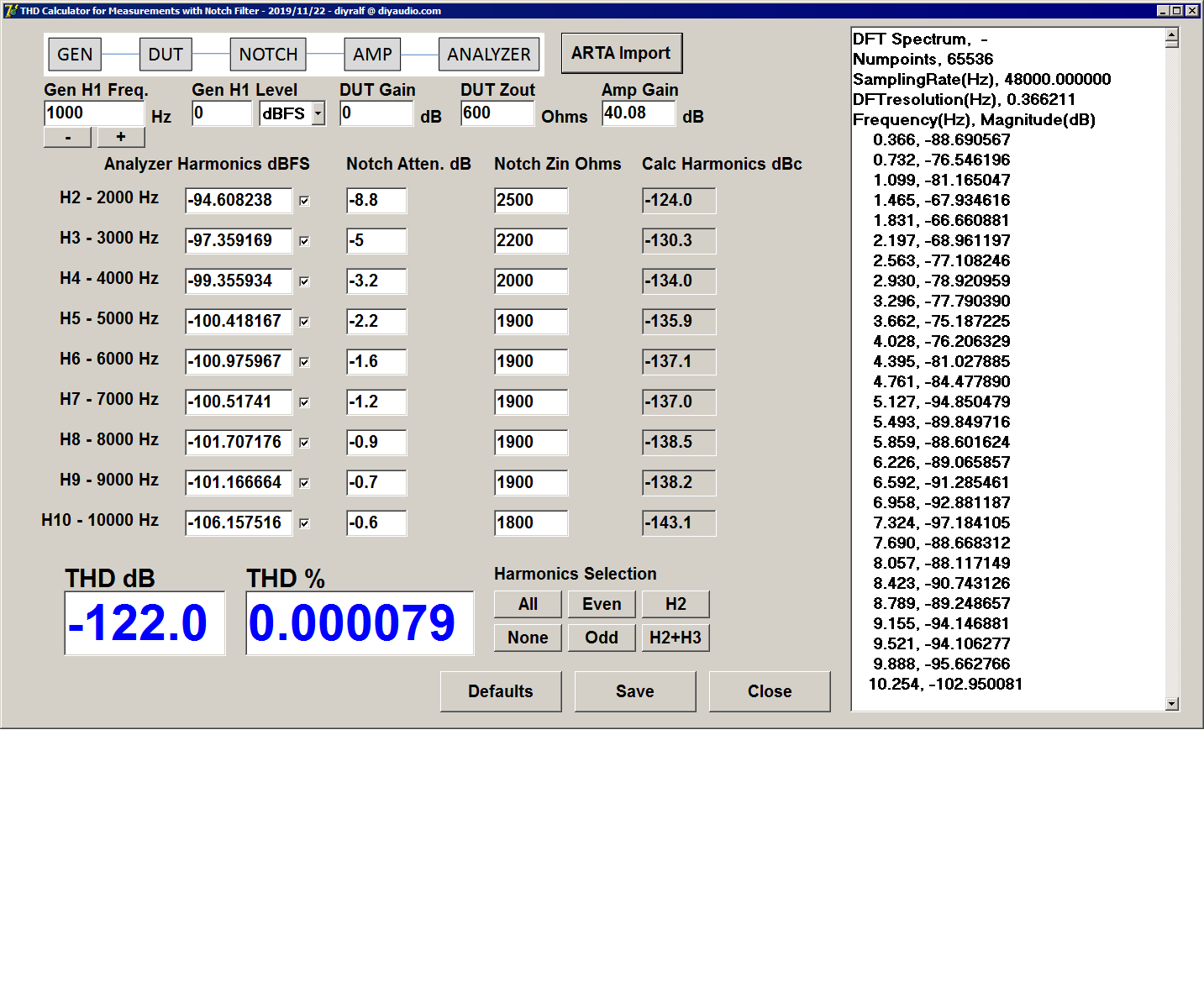

Latest version of my THD calculator
Latest version of my THD calculator. What's new?
- Import possibility from ARTA
- Selection of harmonics

Ralf, I'm trying to figure out the calculations.
For H2, the measurement (I think) is -94.6dB. The notch atten for H2 is -8.8dB. So the actual H2 is then -85.8dB, right?
The amp gain is 40.1dB. That gives me -125.9dB. But the calculated column says -124dB. Maybe I miss something, but I can't solve it.
How do you do it?
Edit: if I figure in the atten from 600R Zout and 2.5k Zin I get the missing 1.8dB. But that would be for both the (notched) fundamental as well as the harmonics, so should make no difference. I think ...

Your conclusions are correct. The value of the attenuated fundamental doesn't matter in the calculation. I do the calulation with the unattenuated input fundamental. This has the advantage that I don't need to know the fundamental attenuation of the notch filter. In addition, if the oscillator frequency deviates from the notch frequency, then the attenuation is different again.
But my point was that you have to (and I think you do) take into account the attenuation from DUT Zout and notch Zin, the 600R - 2.5k. Right? It is a fixed factor in your test setup.

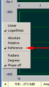

Edmund, could you enter the fundamental attenuation manually? What I did was plot the attenuation curve for harmonic correction and adjust for the loss/gain in the Shibasoku output which is fixed.
Yes it can. After an analysis you can select the option "Reference" (see pic), in which case the amplitude of the fundamental is substituted by the Output level as specified in the Distortion menu. Now the harmonic amplitudes are referred to this level. That's what you want, right?

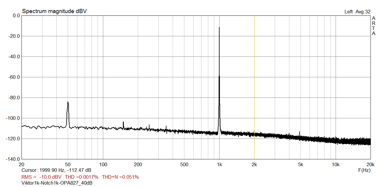

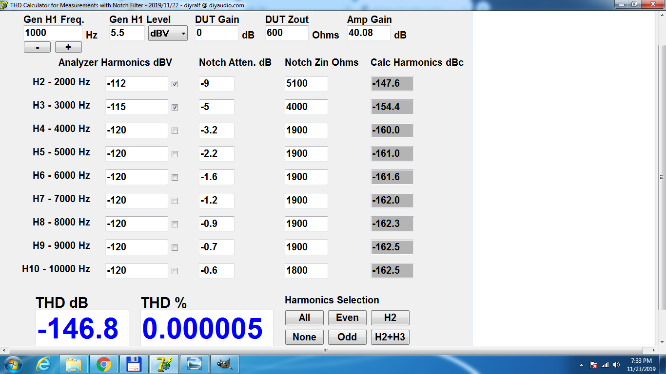

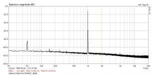

I tried your calculator. The chain was:
Gen - Viktor1k, output 1.9Vrms, +5.5dBv
Notch - passive twin-t notch 1k
Preamp - OPA827 +40dB
Analyzer - XFi USB HD modded

I suspect a measurement error / misunderstanding here. Can you connect the oscillator directly to the ADC and adjust the level so that it has about 0dBFS and then insert the DUT + notch and not adjust the level. And set the level also to 0dBFS @ calculator.
Moreover I suspect you are using the notch circuit from Victor. Has it really an input impedance of about 5100 ohms @H2?
there is no DUT, DUT is a generator itself
analyzer 0dBFS = 0.5Vrms, -6dBV
notch H1 imp cc 5k
notch H2 imp cc 4k
notch H3 imp cc 3k5
The calculation is correct, let's see
