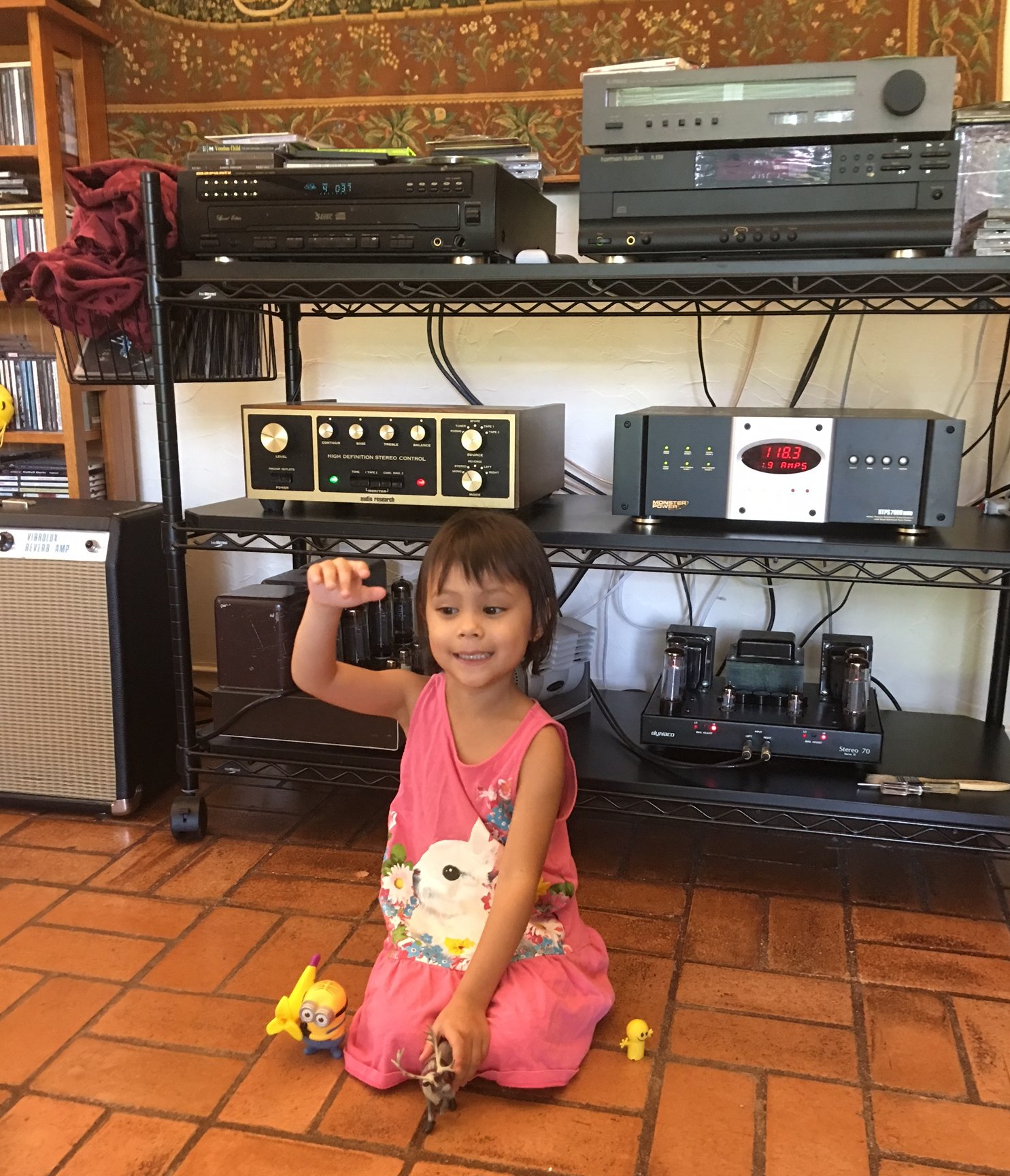

Here is a pic of the system, Tiffany had to bring her toys and play.
I can wheel in my Measurement rack to the large room. It and it's filters
and tools and scope are mounted on one of those food service racks. To that
is doable too.
