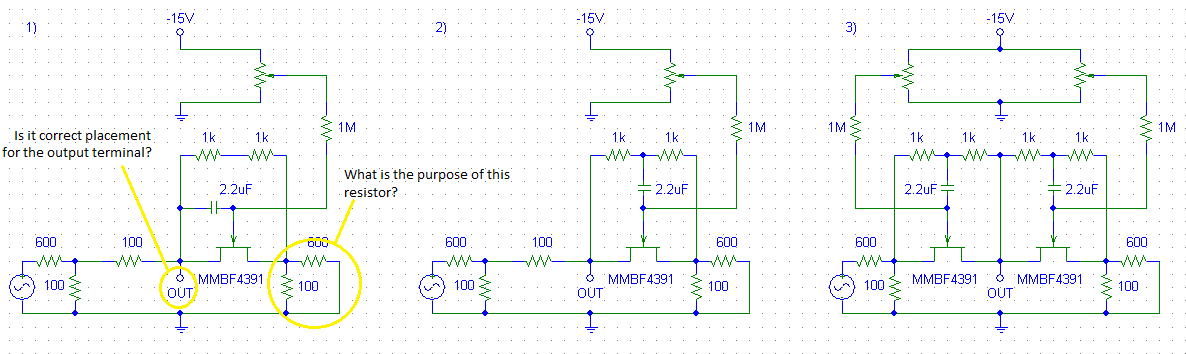

Dimitry, are you interested in the simulation results or the practical measurements? My last posted pictures was the PRACTICAL results measured on the table today.
Sorry Victor, words spewed out faster than thoughts. Here are my questions (see attach). What was the input voltage?
Thank you for the clarification.
Overall all are correct. First and second schematic is not balanced type, and the 1Mohm resistor at the gate isn't a big problem.
Both sides of the balanced schematic must have equal impedances. My oscillator has 600ohm output impedance - you can see this in the schematic. The second 600 ohm resistor imitates this impedance on the other side of the schematic (I have no 85,7ohm resistor :) ). I measured only voltages across the d-s of the FETs and the 100ohm resistors instead of the one FET in the two first schematics, and these voltages were app. 60mV rms.
Also you can check this balanced schematic in a simulator for to see if it is correct.

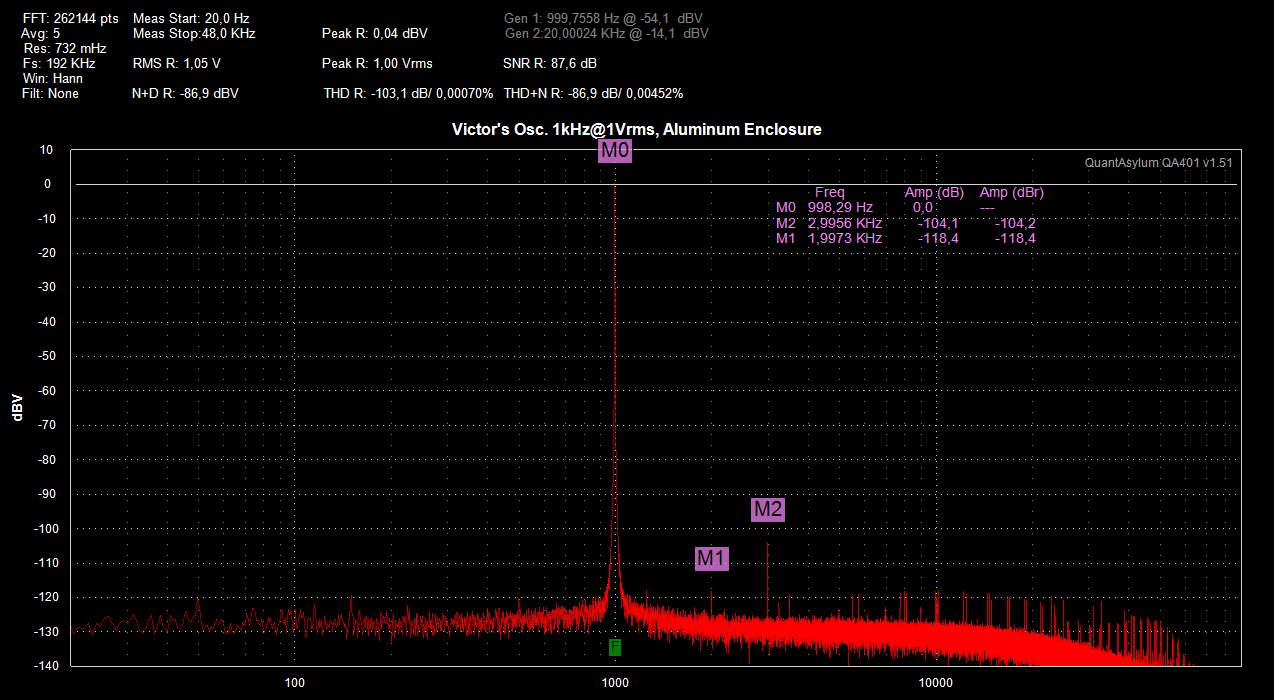

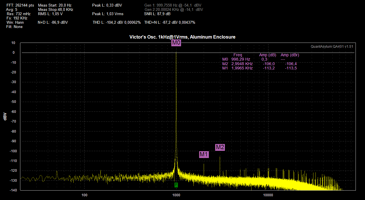

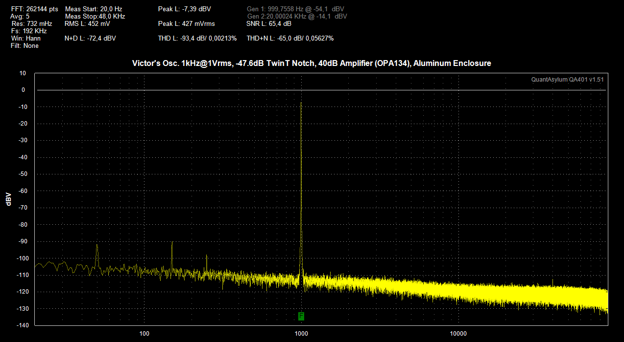

Now, having finished the assembly of the enclosure for Victor's LDO during the weekend, I was able to conduct some measurements today.
I've added a BNC-output and included a passive twin-t notch filter and a post-notch amplifier with voltage gain of +40dB built around a OPA134 (my THT opamp stock is very limited). Everything crammed in a diecast aluminum hammond enclosure, supplied by external LM317 regulated linear PSU. PSU-cabling is unshielded (2mm banane type). All signal cabling via 50 Ohms coax.
The Notch has a depth of approx -47.6dB, the 2H is attenuated by -9.2dB and the 3H is attenuated by -5.3dB.
1) left channel of QA401
Osc. straight into to pos. Input:
attachment.php
With notch and post-amplifier:
attachment.php
2) For Reference the same setup with swapped channels. (see attachment)
I need a deeper notch... practically no harmonics visible :). In other words, this seems to be the dist. limit of the QA401 only (1Vrms!).

I am not sure if I really understand your question but the setup is as follows:
LDO -> -47dB Notch @1kHz -> +40dB@0...20kHz Bandwidth OPAmp -> QA401
For sure the Q of the passive Notch is not high enough, and the depth is not sufficient for a valid characterisation of Victor's oscillator. But it is a start.
Or am I mistaken?
