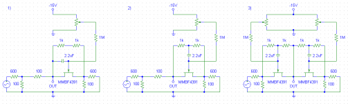

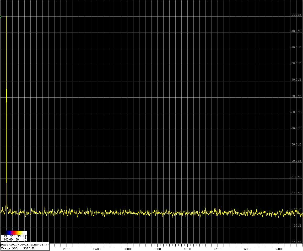

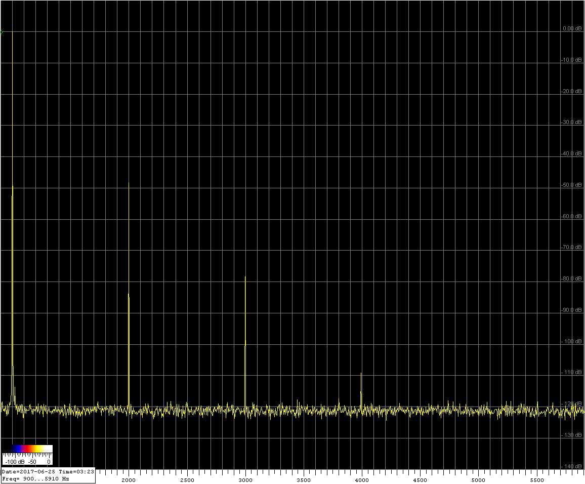

Of course, the simulator models are not ideal, but the basic effects can be well seemed. And, not need to simulate for to understand that the balanced schematic is as the divider with the identical impedances in both sides, and this means, that when the balance is done, then no harmonics voltage will be in the middle point.
Here are the practical harmonic measurements of the different regulators with the FETs.
The 1kHz signal across the every FET (MMBF4391) s-d was app. 60mV rms.
1) Regulator without 1/2 s-d on the FET's gate.
2) Regulator with 1/2 s-d on the FET's gate.
3) Balanced regulator. FETs was matched for similar Vgs off. For to minimize the harmonics the small offset was needed.
Victor.

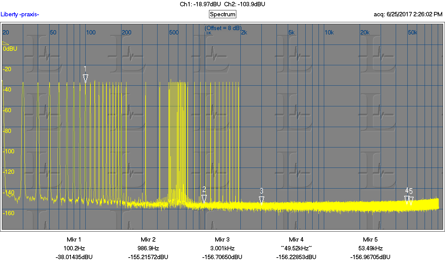

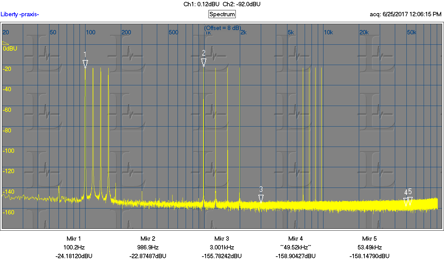

Like this? Its a triband spectral contamination file (loopback on the RTX analyzer at 192 KHz). 1 million point FFT, 10 averages.
Lots of tones gets really difficult if they are not to have harmonics or IM products on top of other tones. Another similar test would be white noise with notches. Again I'm not sure if you would learn something new. The underlying non-linearity would be the same. These IM tests do have the benefit of working in band limited systems.
This is a good test for drivers. Lots of coherent averages will unmask noises and other garbage you would otherwise miss.

Victor, can you please add without to your simulations? Thank you
Dimitry, are you interested in the simulation results or the practical measurements? My last posted pictures was the PRACTICAL results measured on the table today.
Probably simulator will show no harmonics in your case, but the practical balance will be very sharp and hardly done, because of the more higher overall distortions in every side of the balanced regulator without the 1/2 d-s on the gates.

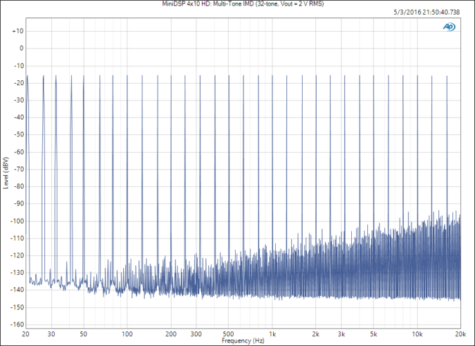

although this mini-dsp plot does look like something's wrong:
http://www.diyaudio.com/forums/ever...-24-listening-test-opamps-11.html#post5113352 (just a few posts later there's a clean soundcard loopback plot)
622183d1498049069-hires-96-24-listening-test-opamps-minidsp-4x10-hd_-multi-tone-imd-32-tone-vout-2-v-rms-687x500.png
but I see more complete measurements that confirm my expectation - rising THD from 1 kHz, classic 1st order rise:
https://www.neurochrome.com/minidsp-4x10-hd/
clearly 2 tone IMD is powerful, there may be further resolution of some types of nonlinearities with 3 tone tests - but so far I haven't seen the value of high numbers of test tones
