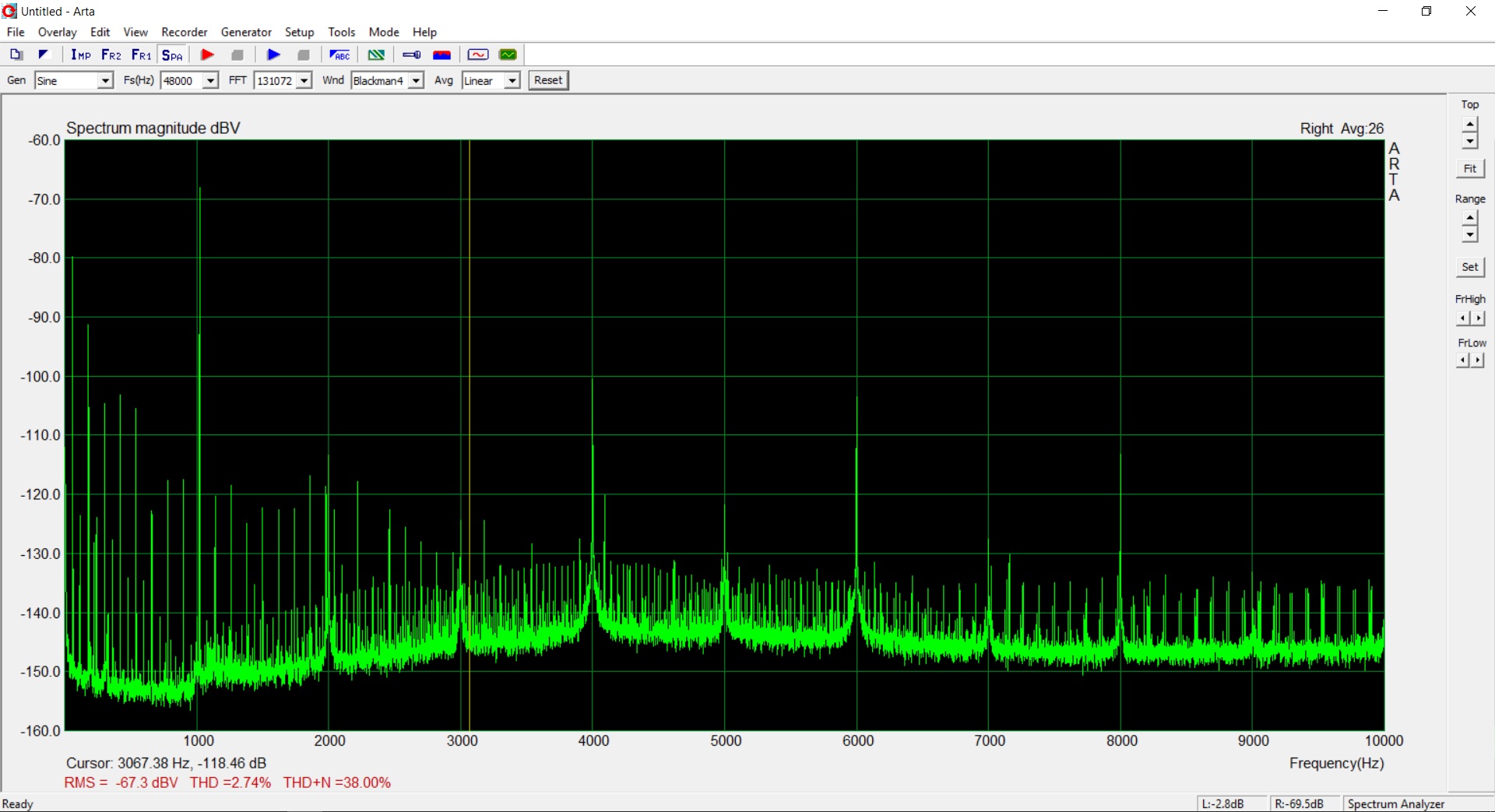

This is what I was able to get with the Asus Xonar Essence (single ended I/O), notched at 1022.46Hz. The notch depth is lower (only 70dB and change) compared to the original SA measurement (-87dB), since the Asus generator output impedance and the Asus input impedance are slightly de-tuning the TwinT.
Input signal level is -3dBFS (some 1.5Vrms), Y scale is in dBV, cursor is on the 3rd harmonic (the highest). See the ubiquitous multiple 1KHz artifacts discussed above. The noise grass is definitely much higher, nothing can be done to avoid this without balanced I/O hardware, which the Xonar essence sorely misses.
Don't know how to measure the M-Audio Audiophile 192 with balanced I/O with a single ended notch, it automatically converts to single ended, with the noise penalty.

I think your notch is too deep. The converters non-linearity is greatest near the max and min levels. A more modest notch --- 40db (?) places it in the middle of the range for better accuracy.
And the spurious unwanted freq are excessive (IMO) and make it harder to see the data.

No you were not paying attention your scale factor was wrong, you made a mistake, no big deal. Waly must be channeling me again, listened to "Thee Psychick Sacrifice" just this morning. BTW the converters non-linearity does not matter when there is little or no fundamental.

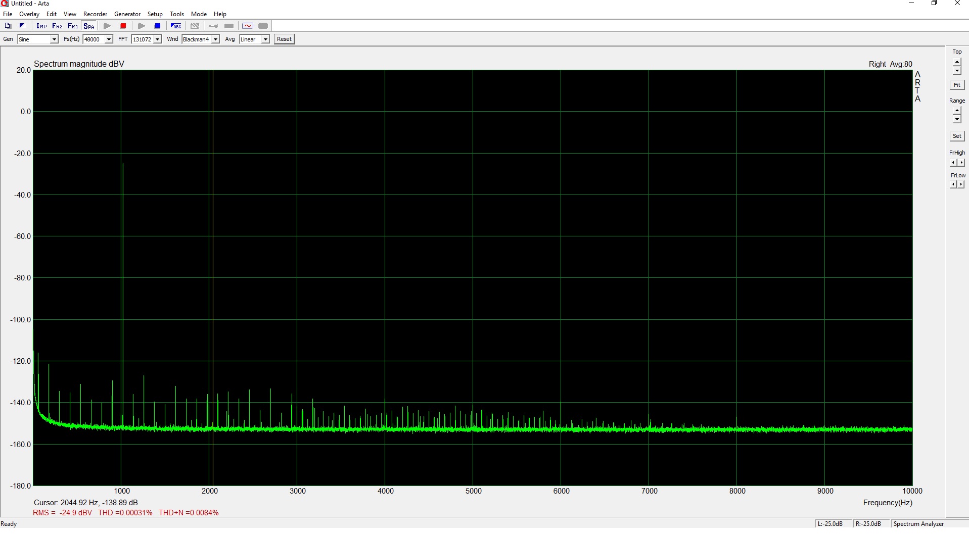

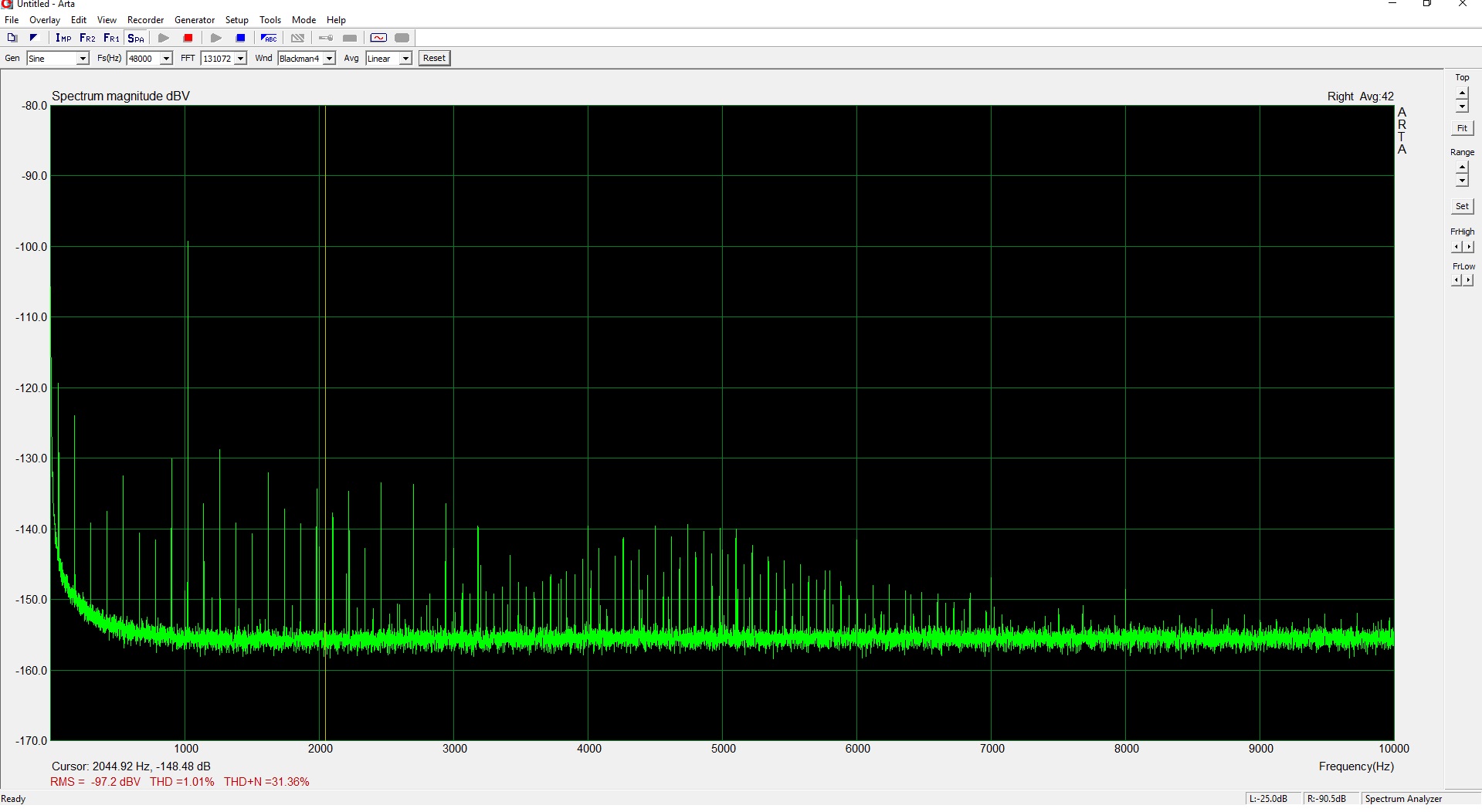

And finally, this is the best out of the Asus Xonar U7 MKII USB card. Remember, the owner replaced the original CS5861 ADC with the CS5381 flagship (it is pin to pin compatible) and this change pays for, in terms of performance (in particular when you got the CS5381 as a free sample 😀). The USB card is 2 meters away from the computer radiating the USB related 1KHz harmonics, these are largely gone.
0.0003% (-110dB) THD and 0.0083% (-81dB) THD+N, which is pretty good. However, and this is where the trouble starts, you have to keep the input signal very low (not more than 80mV) and the optimum input signal for getting these numbers is very small (50...80mV). This is in stark contrast with the Asus Xonar Essence and the M-Audio Audiophile 192 results shown before, where there is a rather wide optimum around 0dBV (-10...+3dB). I guess it's the price to pay for a USB powered (+5V) device. With the owner blessing, I may eventually try to replace the LME49726 rail to rail dual op amps (in MSOP packaging) if I can find a better suitable device (TI doesn't seem to have one).
The notched results are similar to the Asus Xonar Essence, but with much lower 1KHz harmonics and showing a dominant H2 (the Xonar and M-Audio had H3 dominant) likely this difference is due to the different opamps and much lower signal level.

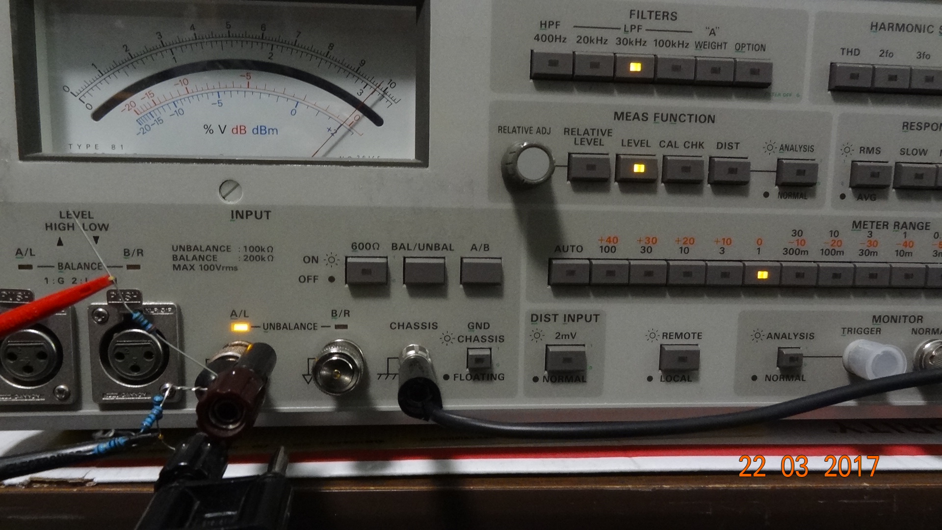

To avoid confusion, did you fix the scaling on those figures after David himself pointed out the 20dB (IIRC) discrepancy with the Shibasoku output? Waly is measuring a sound card BTW with its own noise and artifacts. Back of the envelope, a passive notch at an impedance level of 1k and in an noise BW of 1Hz should be able to resolve -150dB at the 2nd harmonic but not with 30dB of clearance from the noise floor. There are no Maxwell's demons.
Actually it was a 10db discrepancy depending on the input level. At 1Vrms input level there is no discrepancy. In level mode none for any range.
Point is we all need to test for error before conducting a measurement and not be complacent about it. There is a lot to go wrong.
Sorry I didn't go back and look, the fact is there is nothing about a Shibasoku or AP that can remove the noise from the basic components in the signal path. Be it a passive or active notch filter, for instance, the Shibasoku has 3k source resistance at the input, presenting a plot with 2nV of noise is simply wrong. These simple sanity checks should be instinctual.
addendum to above -- David's gen reduced to 1 v output:
No correction needed, then.
-RM
It seems some, like scott and waley, didn't pay attention that I had readjusted the output from David's 'factory' setting and trimmed it for lower distortion. So, as stated, my gen was out = .9v and was of course using the 1v scale of the analyzer. The above shown setup is with gen back up to 2+ v out but atten to one volt so I can still use the same 1 v scale and compare distortion levels .9v vs 2.x volts.
