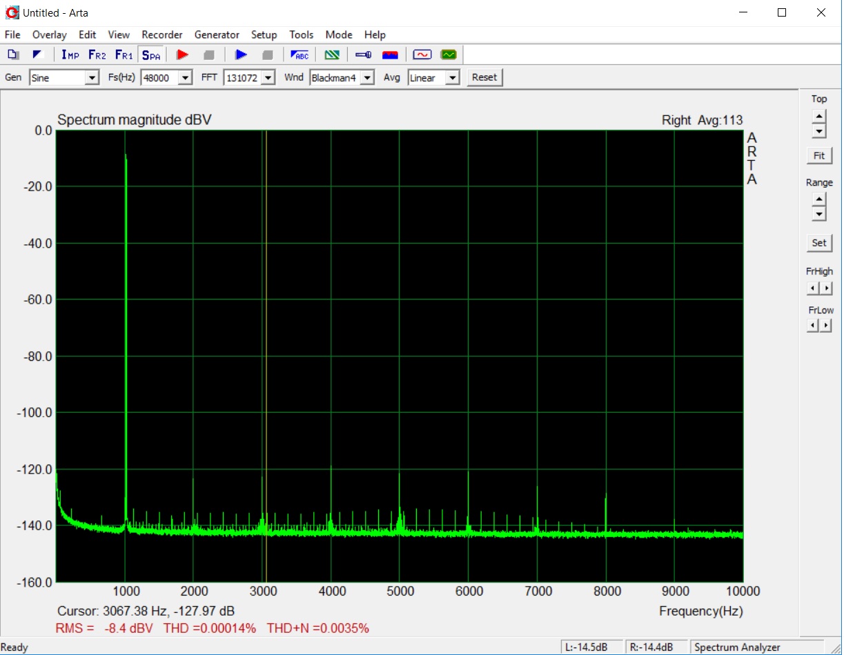

Trick #1 lower the level. I find -15 dBFS to -20 dBFS gets the best results.
Trick #2 get as much hum out of the card as you can. The balanced to differential helps a lot. The hum and noises dominate the distortion readings
Trick #3 waste a lot of time f'ing around with it. Even the host PC makes a difference if the supplies are poor or the noise level is really high. The three cards you tried I have not. The Asus Xonar DX is the first Asus and that only because of the low profile.
The pro cards tend to be better executed for whatever reason. Probably because they will get flack from users faster.
Man, you are even more right than I originally thought... It took me two nights of tweaking the best card I had around (M-Audio Audiophile 192) to get the best out of it. This card has balanced in/out, so I had to use balanced to single ended cables for calibration. Measurement is taken in full differential mode. Original op amps (the ubiquitous SOIC 5532, 11pcs) were all replaced with LM4562.
0.00015% THD (-116dB) and 0.0035% (-90Db) THD+N both @1022.43 Hz and 48KHz sampling rate and 131072 FFT. I selected this odd frequency because it matches the best TwinT I was able to put together (-87dB attenuation), using C0G 100nF sorted and 0.1% metal film resistors, not used here), also wanted to see other artifacts which are at even frequencies. Cursor is on the 3rd harmonic.
You can see the 1KHz multiple artifacts, originating/radiated from the USB 1mS frame rate (much attenuated, due to the balanced I/O) which seems to be unavoidable on this PC (got these artifacts on all sound cards I tried, PCI, PCIe, USB). Only placing the USB card 2 meters away from the PC makes these artifacts vanish in the noise floor. The rest of the grass (at -135dB) over the noise floor (-143dB), I don't know, all I can tell it's not related to the mains frequency. Since their amplitude depends on the input signal amplitude, they could be some intermodulation products, but I'm speculating.
One to another, not to bad for a 10 quid old card salvaged from junk (I think it was well over a ton when new and current). Other than the Asus Essence STX (which sorely misses balanced I/O, though) "they don't build like this anymore", at least not in the same price range. The Asus Essence STX gets the second prize (-108dB THD -82dB THD+N also after replacing the JRC op amps with LM4562 DIPs), everything else (USB cards) are an order of magnitude worse.
Last comment, to my surprise, although the M-audio ASIO drivers have a horrible reputation (and the 64 bit version for the Audiophile 192, in particular) it worked for me like a charm with Arta in Windows 10. Asus ASIO drivers are excellent, while the Creative ASIO drivers are indeed a nightmare in terms of stability and usability.
Not going to be able to measure david's generator, yet.

To avoid confusion, did you fix the scaling on those figures after David himself pointed out the 20dB (IIRC) discrepancy with the Shibasoku output? Waly is measuring a sound card BTW with its own noise and artifacts. Back of the envelope, a passive notch at an impedance level of 1k and in an noise BW of 1Hz should be able to resolve -150dB at the 2nd harmonic but not with 30dB of clearance from the noise floor. There are no Maxwell's demons.
If moving the USB card away from the PC reduced the interference it may not be from USB.
Double checked, this one is, and it is radiated. It happens only on this stand alone PC, which has a cheap no name PCI-USB 4 port extension card, doesn't happen on a laptop with an USB sound card attached, away from the offending PC. I tried and pulled the USB extension card from the PC and the 1KHz hash goes away, THD+N goes down to .0006% (-104dB).
guess you weren't paying close attention.
-150 wont get to it either. Need -160 noise floor.
THx-Richard
My woraround is high resolution FFT's. The real noise floor is an issue and it seems soundcards are not going to get there in terms of THD+N. Current SOTA SNR/Dynamic range on sound cards seems to be around 122 dB or so. With a good preamp on the output of a passive notch you can get a much lower noise floor but I'm not sure how low. The notch's input impedance needs to be taken into consideration. If it matches the source at the null and increases on either side you get an additional 6 dB of gain on the harmonics over the fundamental, which could lead to incorrect conclusions.
If a source is 600 Ohms what values would get a decent passive notch (bridged T, twin t or Hall?). Its a worthwhile experiment.
