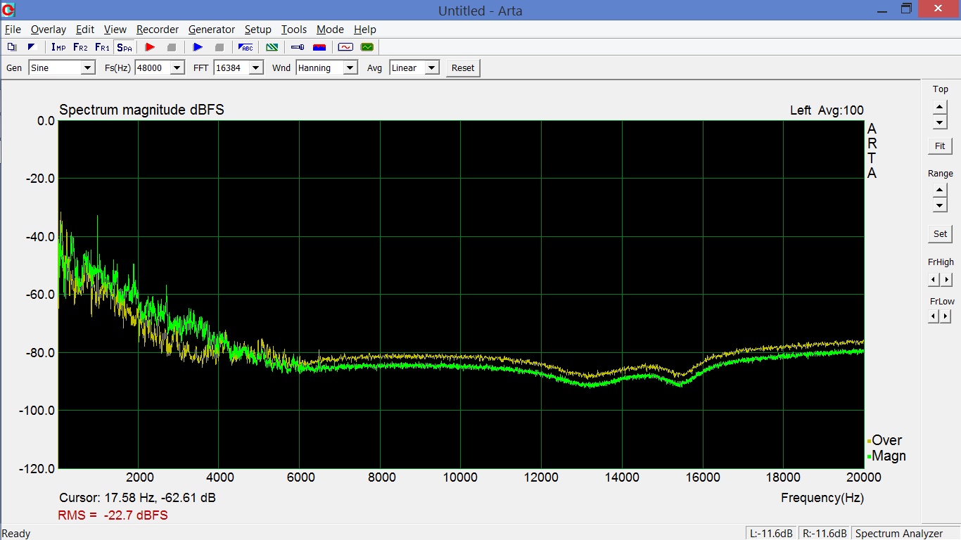

Useless ARTA Pic
Well, now at least I have a useless ARTA image post.

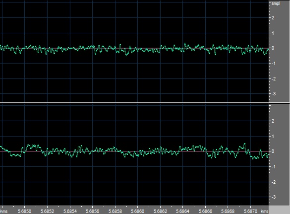

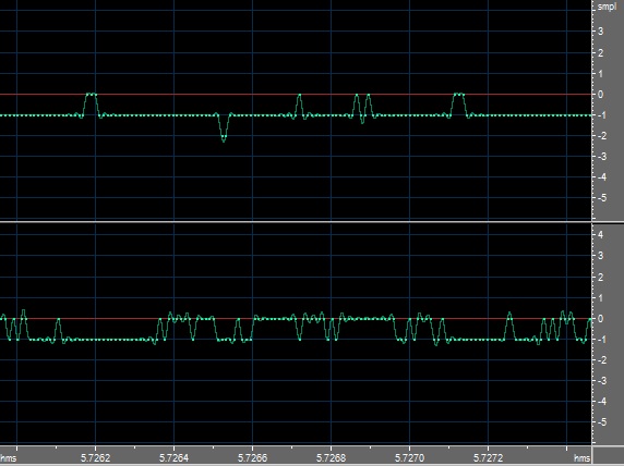

Which unit
has the labview requirement, or are you using LABview to look into
the data stream?
Because you asked, this is my test for 24 bit data. Simply measure noise on a shorted input, most soundcards these days are near one 16 bit lsb or better, then display on a scale normalized to 16 bit lsb's the difference is obvious. As you can see if you were archiving your LP's on the left you would have good old 80's undithered 16 bit.
You can be fooled by 16 data with 24bit dither added after the fact but on close examination the histogram is all wrong.

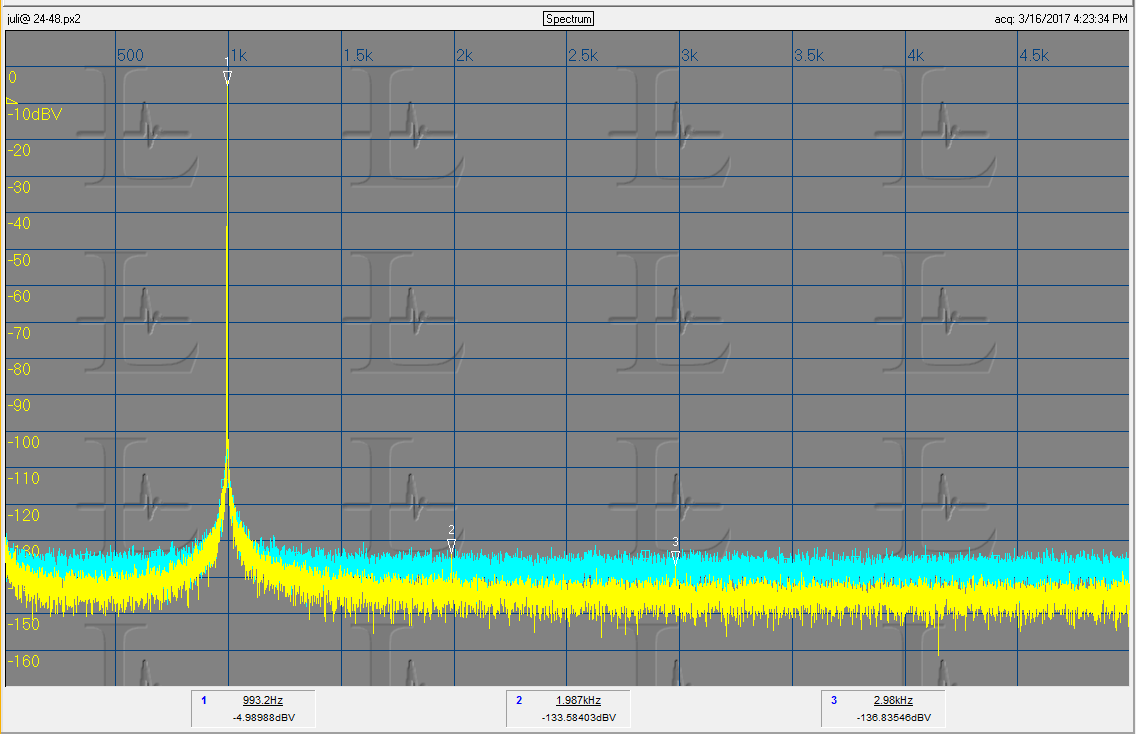

To confirm- is that Audiaity at max vertical zoom looking at the waveform?
I have found that looking at an FFT gets similar results on 16 bits with a flat noise floor and lower noise floor and details at 24 bits.
The FFT below is 48 KHz and 262144 points. Signal is about -14 dBFS. Yellow is 24 bits and Cyan is 16 bits of the same (Victor oscillator) source. The stock Juli@ card is pretty good. 16 bits limits it.

No it's CoolEdit/Audition I prefer its zooming and FFT features to Audacity. Adobe did one good thing in adding X and Y zooming features to the FFT window. BTW the SoundBlaster's latest driver update now lights up WASAPI and I can do 24 bits in Audacity. The behavior is still not what the developer's guidelines would say but the settings are available.
