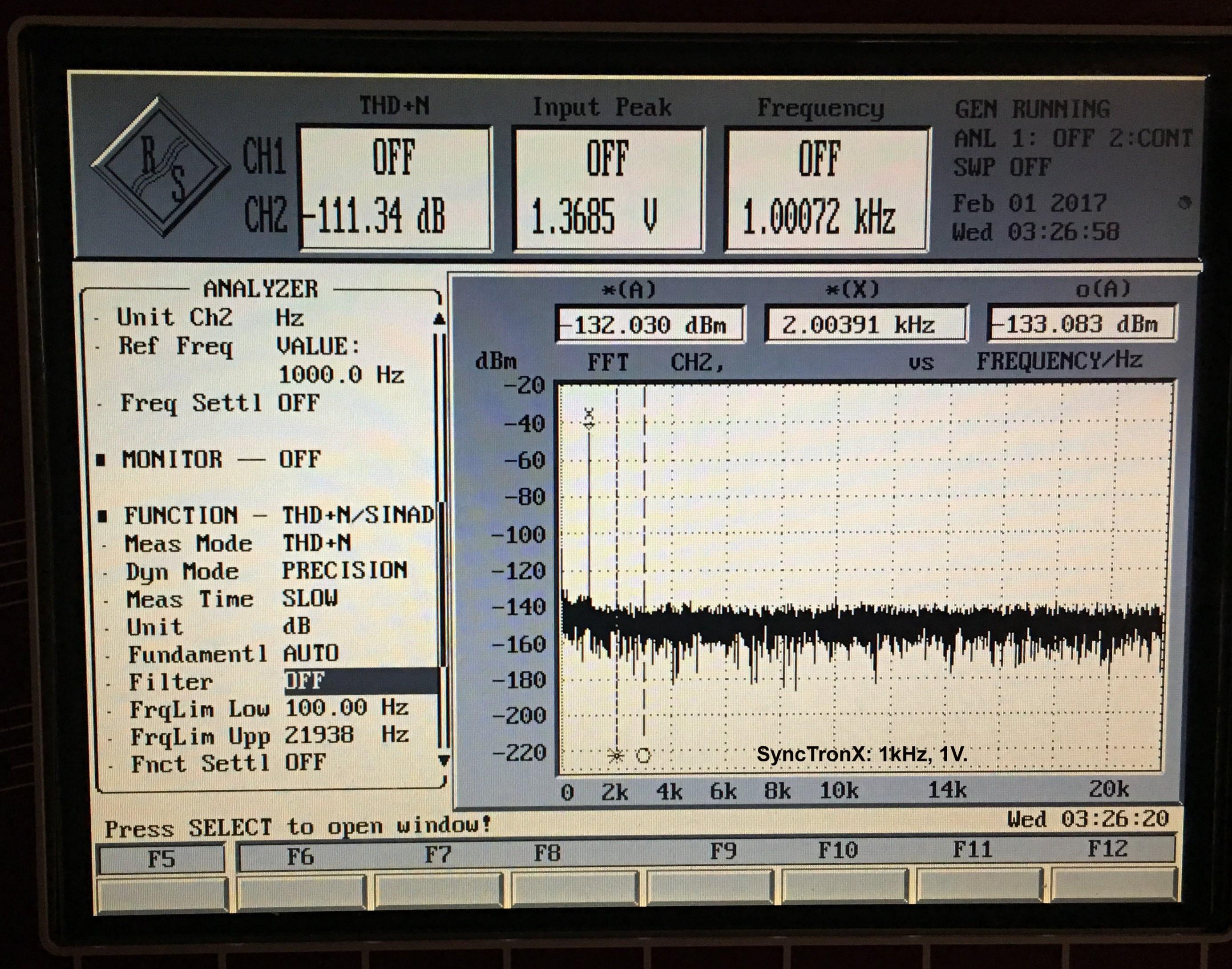

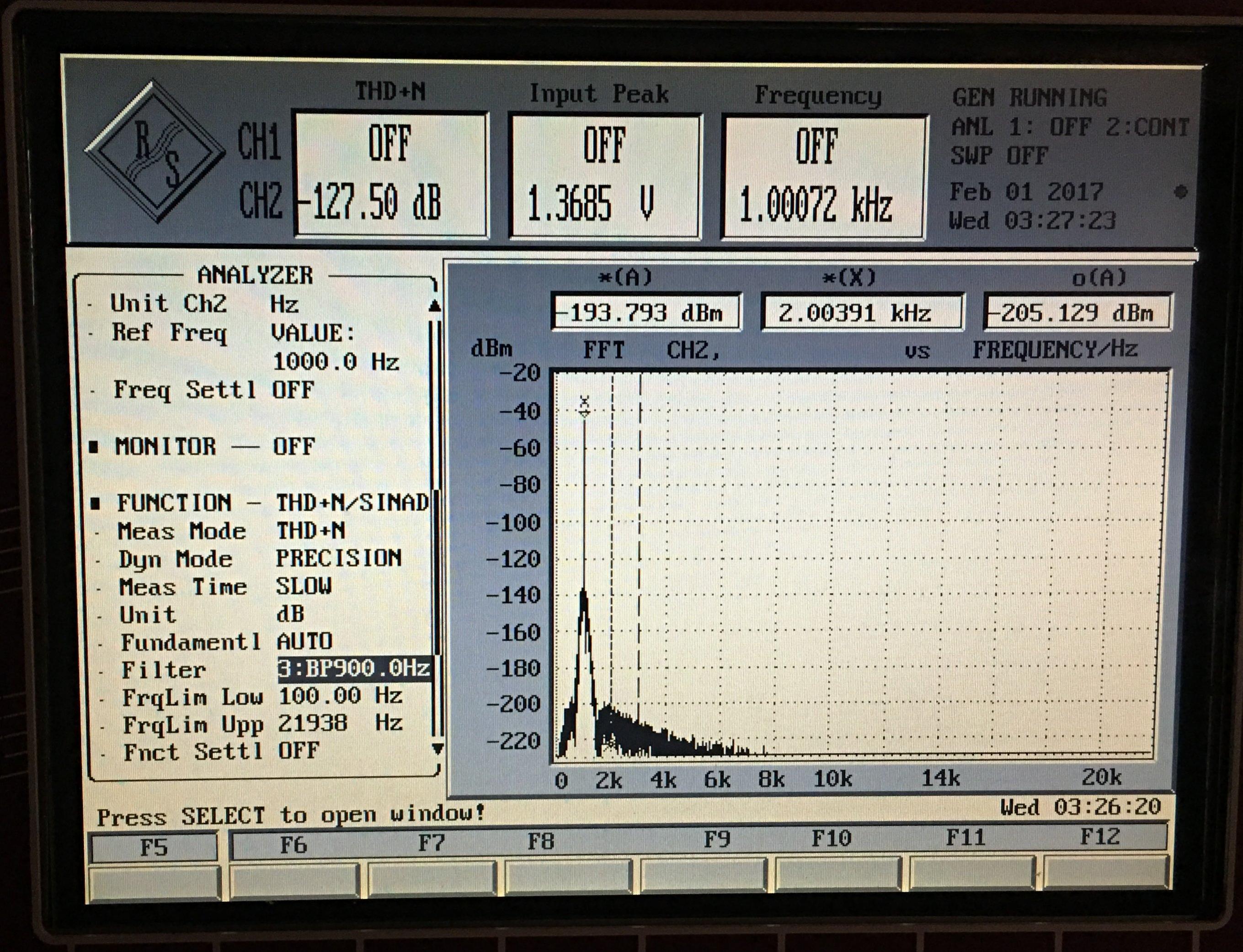

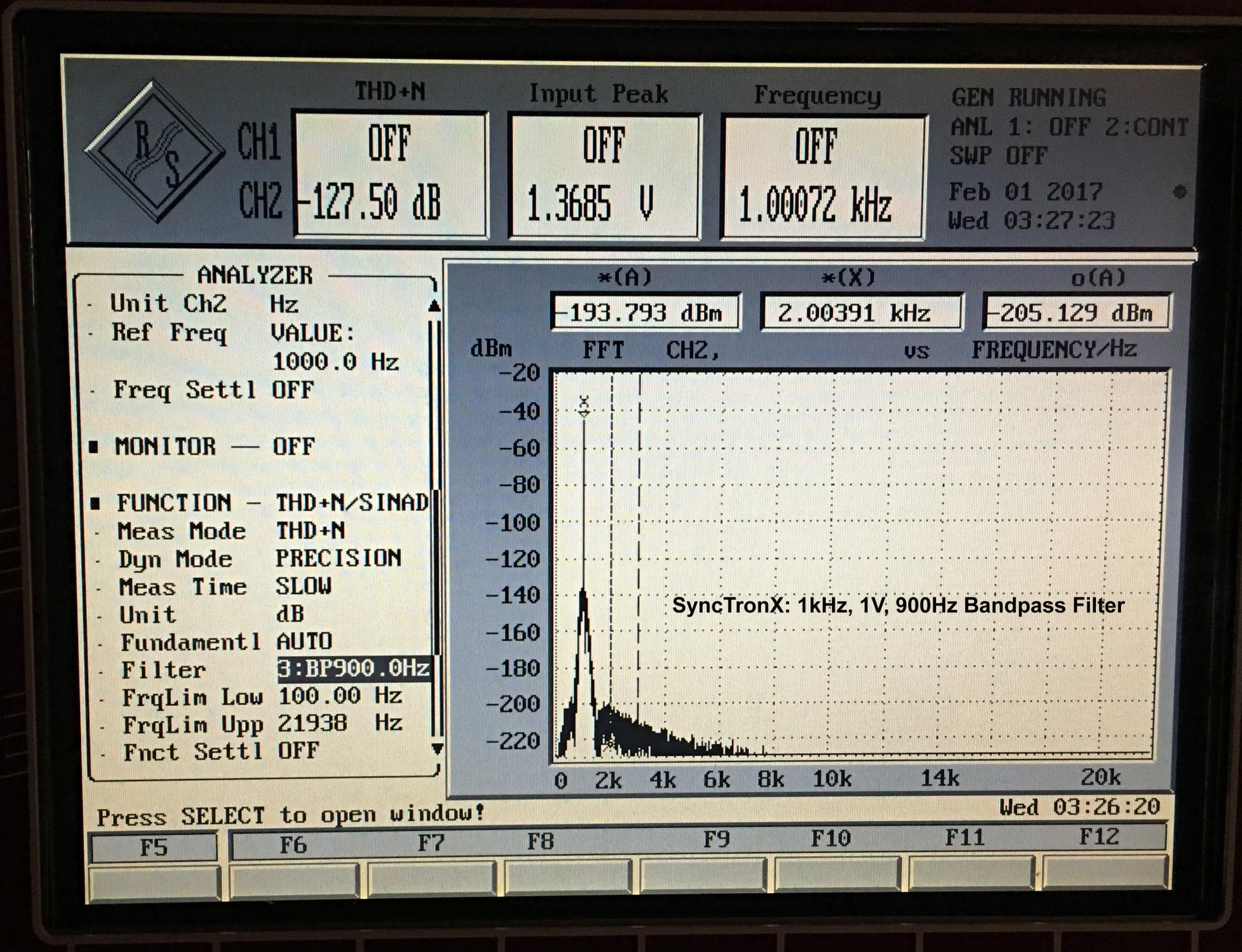

Affect of Band Pass Filtering
After I read what Richard has accomplished with
his work there I wanted to see what if, instead of
learning what diodes actually do.
Yes, I know those are the basics in my Solid State Devices...
...but really what are the affects of using Richards method
with this to see what it might look like...and being one for
simple too, hey, simple is good, but sometimes simple is
dis-eveing (spell check can't find it) too.
Why is it that way? For something to be simple in a complex
system it takes a lot of leg work and time to get to where things
are simple. So, it's taken me since my last post thinking, okay
I'll put up or shut up. Imagine that--me?
At first though, I didn't believe my eyes.
Sync
Post Script:
* = 2kHz
o = 3kHz
It's kind of funky the way it works, it is what it is. The symbols are so you
can ID two points, then zoom between them, or make other measurements
with them, add or subtract etc.

I was thinking if the miniDSP was that good, we could write some software for the DSP to generate test signals, sending them out through that -130dB DAC and get rid of all the other boatankers. 😉
Probably wishful thinking. ...
Jan
@Jan,
It just might be that good. Look at what I did with my boat anchor.
And that is based on a 30 year old anachronistic technology right?
Who in their right mind uses an IBM AT 'puter? What were those
chermans sinking, ja? Nicht Schlecht fur alte puter.
@everyman, Demian might be on to something also. So we have
the low oscillator, then we have a low box for them, then we have
Richards Proof, then my what if on Richards Proof, then wow,
it goes so low I don't think I can read it. So ADGR made the
4 box for Victors Oscilator, make four band pass 900Hz filters
centered around each of the four Fo - Bangholius
We Be Done - Done - Done!

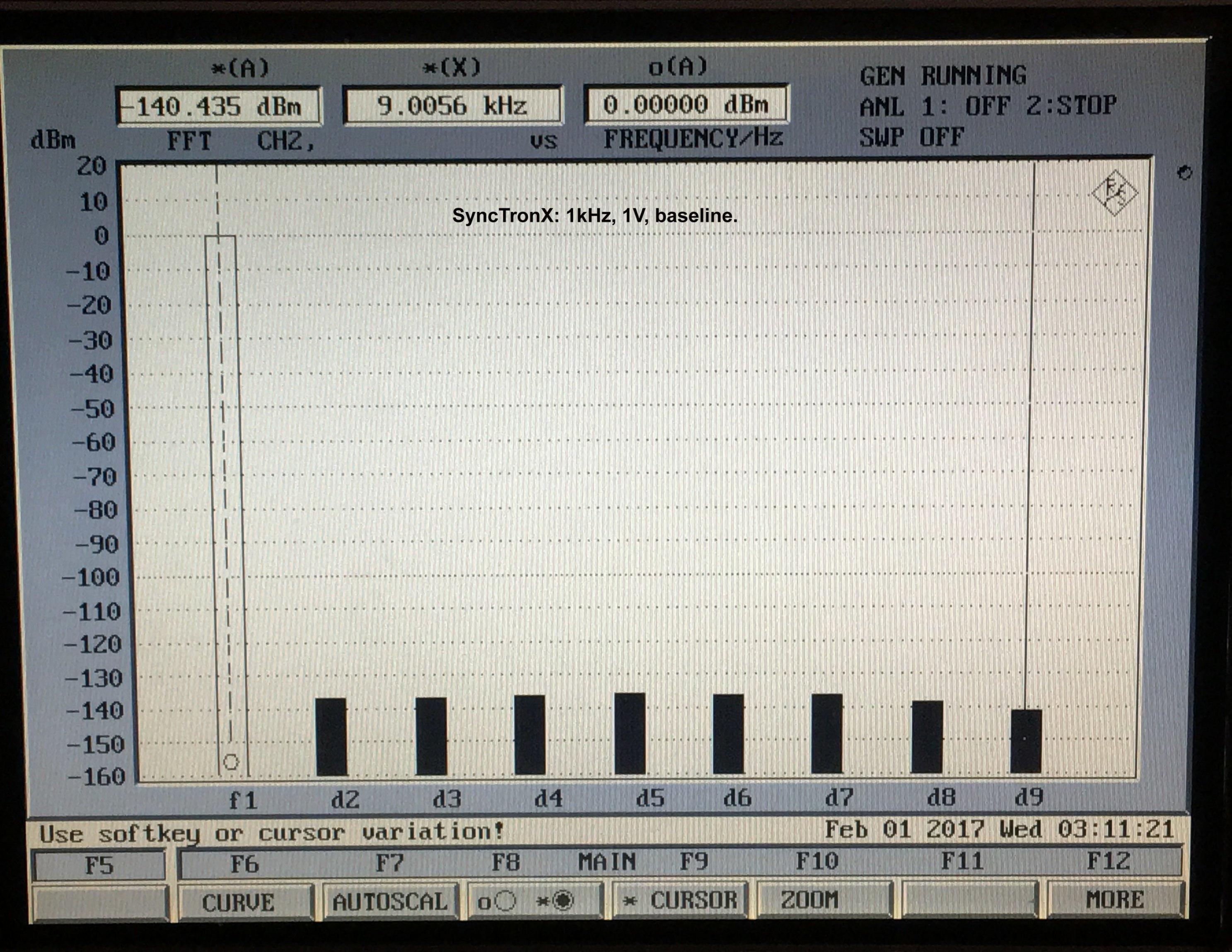

Still for gear this old cranking out this kind of 1kHz, 1V sine....

Sure, but the fact that we cannot do much better than 30 years ago is in itself somewhat depressing, ja? 😱
Jan
Richard is there a possibility in the stock DSP software that lets you generate a test tone that you can look at after its DAC?
Jan
Not that I know how to do with it.
BTW - the spec is for -100dB for THD +N. With FFT = THD ?? 24b.
But better exists. I used a gen that had high enough harmonics to see the filtering effect. But an ultra-low distortion gen might be a harder thing to do a LP filter. However, I am sure it can be done.
-RNM
