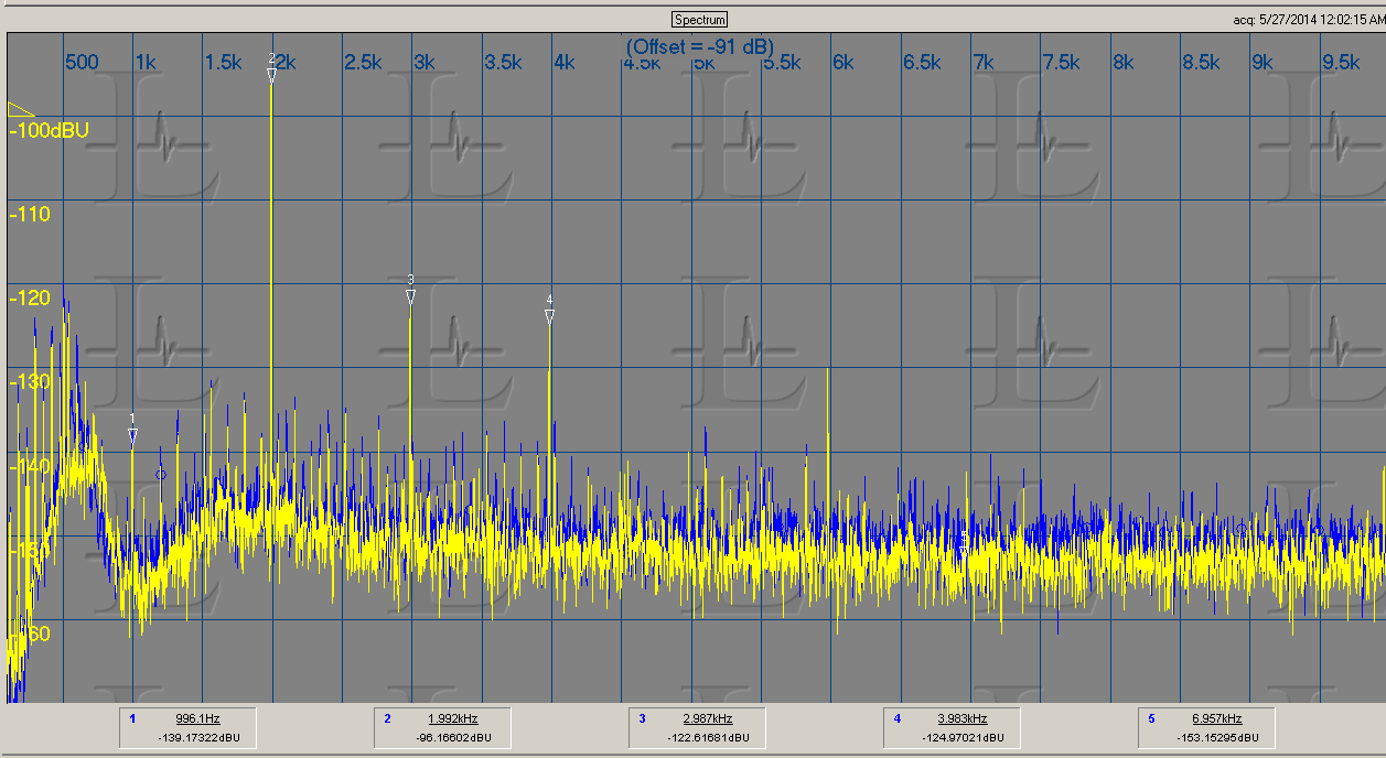

The TPA6120 is pretty good but you need at least 30 dB distortion reduction from its native performance. That's a tall order even though its bandwidth makes stabilizing easier if you don't need ultrawide bandwidth. These are measurements I made from the TI demo board a few years ago.
There are two other candidates for this- the LME49600 (That Jens is using in his interface) and the OPA1622. AD may have some candidates I'm not aware of as well. The LME49600 would be the easiest since its targeted at this application. I have the TI demo board for it somewhere but have not measured it. I just got the demo board for the OPA1622 as well. I'm looking at the OPA 1622 as an upgrade in the KH4400. That will not be simple.
Still -150 dB distortion into 50 Ohms is a major undertaking.

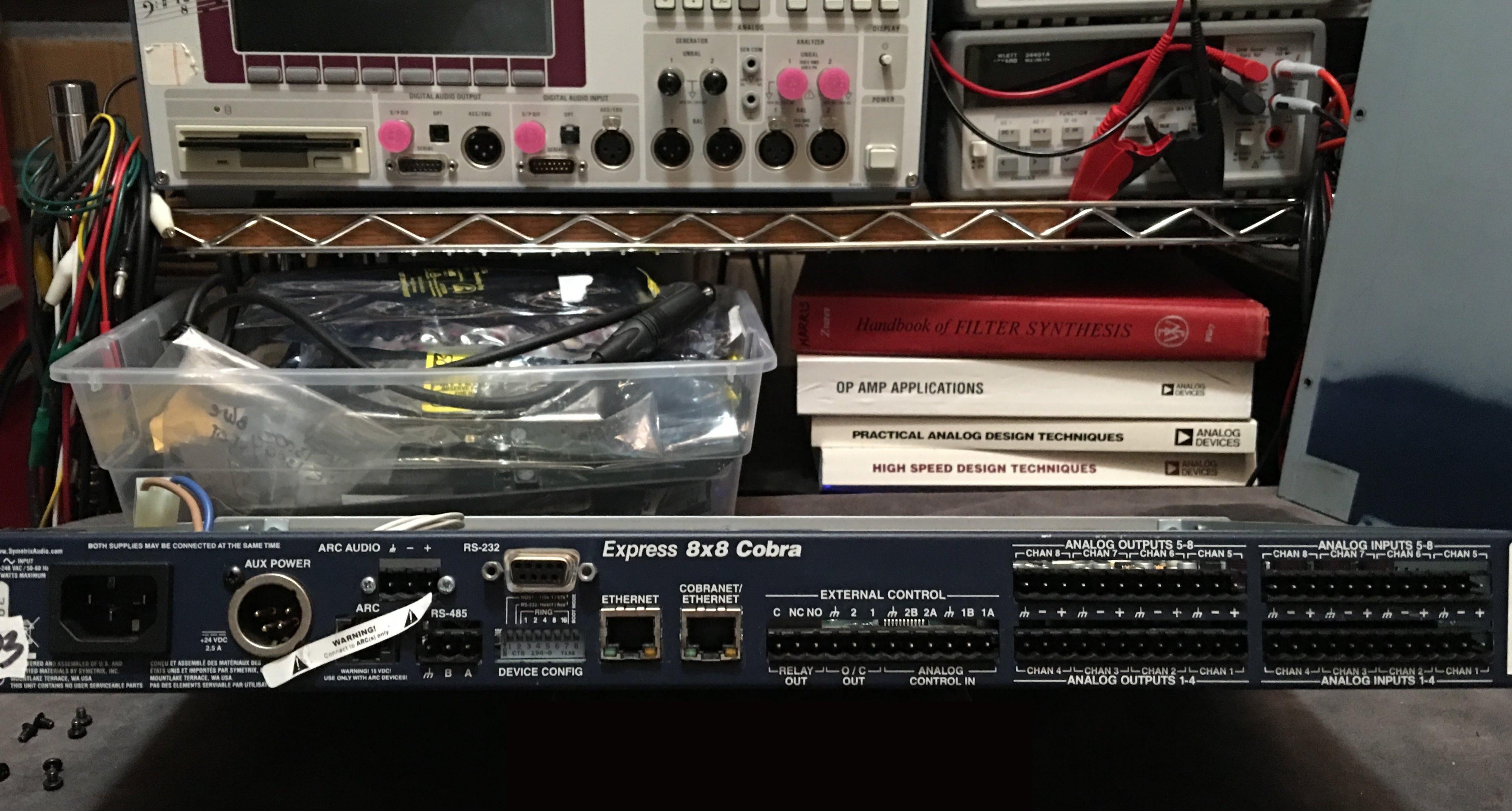

Here is what was recommend to me.
"I would go with SymNet if I were refabbing the speakers and using separate amps/XOV. At the current used prices, they are a almost a giveaway. These boxes were designed by the engineers at Lucid, a company that made some of the best digital audio mastering electronics available. Symetrix bought Lucid for their digital audio chops. I used SymNet boxes in many studios and high-end Home Theaters I designed. 8 outputs leaves you the ability to incorporate Bass Management and EQ for a Subwoofer output, if desired."
One box solves a lot of problems.
The first is there are plenty of components and parts for them.
Along with a robust website too.
So for a reasonable amount buying a used symnet express or cobra
4x8 (four by eight) that gets you four analog inputs and eight analog
outputs.
The other nice thing is once you open up the box...you'll find its designed
nice and broadly laid out, easy to work on with a bunch of stuff in there I don't
understand.
I'm sure with Demian's lock in method you can have some nice digital inputs
and out puts along with a lot of control for what ever you wanted to do.
With the software control capabilities it's will be a good tool for dual tone
output generator, bursts, or whatever mix we can dream up.
I don't know how this fits in with the EMU stuff. I bought one of the 1616 units and as I recall I had the same challenges as Demian getting the thing apart, and trying to finagle it back together again.
Demian or Richard, there are a number of the units I see for sale in The City.
check them out on fleabay. Also here is a link to their website.
I talked with them and their helpful people. This isn't a consumer junk company. The physicist/acoustician recommended it to me because as I ended up with his original Mastering Studio Speakers that he just couldn't toss out. Sadly, I'm in the process of doing the reserection on them and will end up tri-amping them.

These are really Maker Space type boxes for professional tinkerers.
And check out the friendly resources.
I'm thinking of using one of these as the front end for any manner of
instruments, for a DSP Function generator
OR
I'll post some pics...inside is like a cross between a Panasonic & ShibaSoku.
AND
It has those little connector sticks sticking up that we can affix gator clips
to easily and get into all kinds of trouble.
Maybe it will give someone and idea and save on some hacking around.
The symnet express box has four analog inputs and 8 analog outputs.
Sync

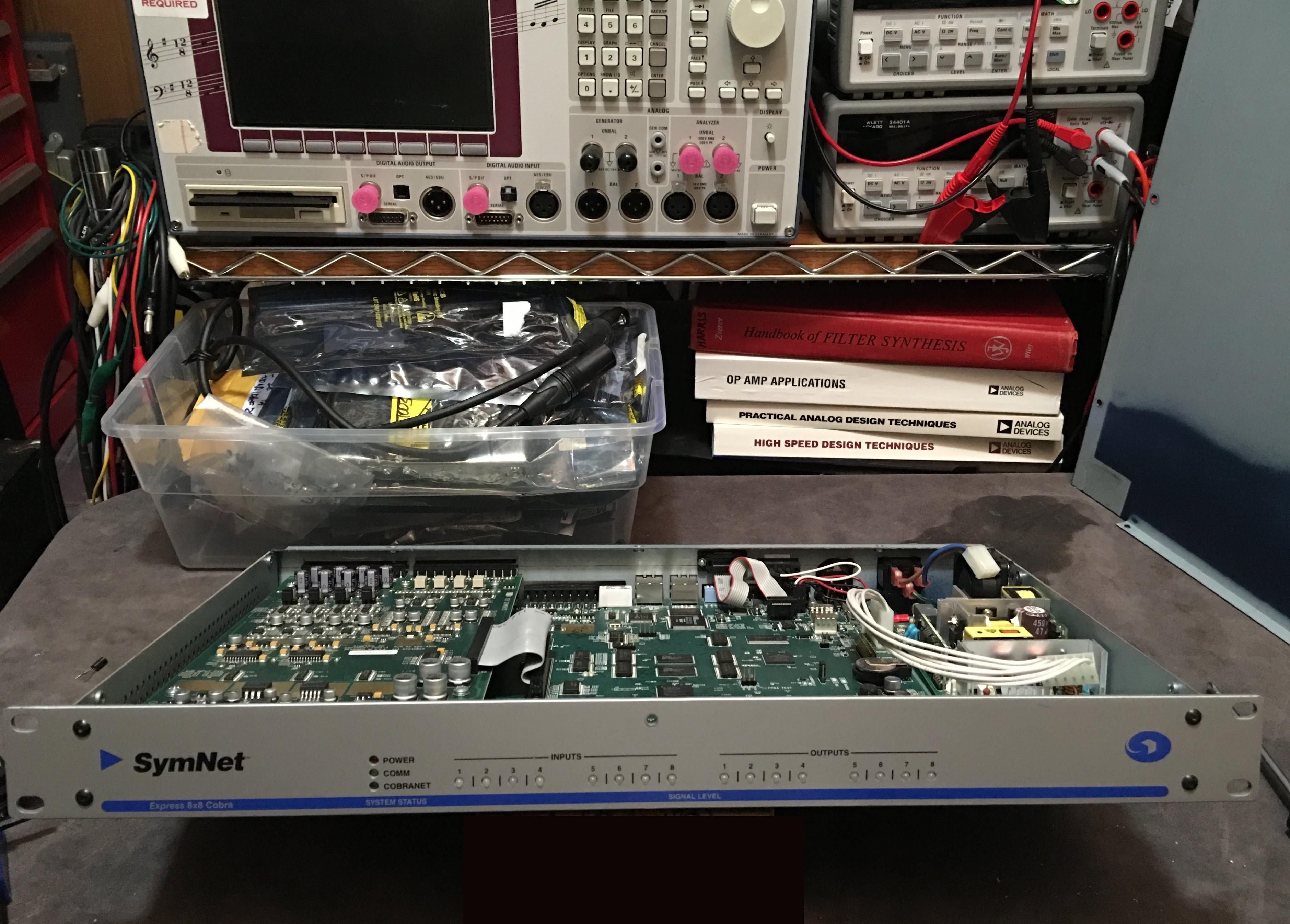

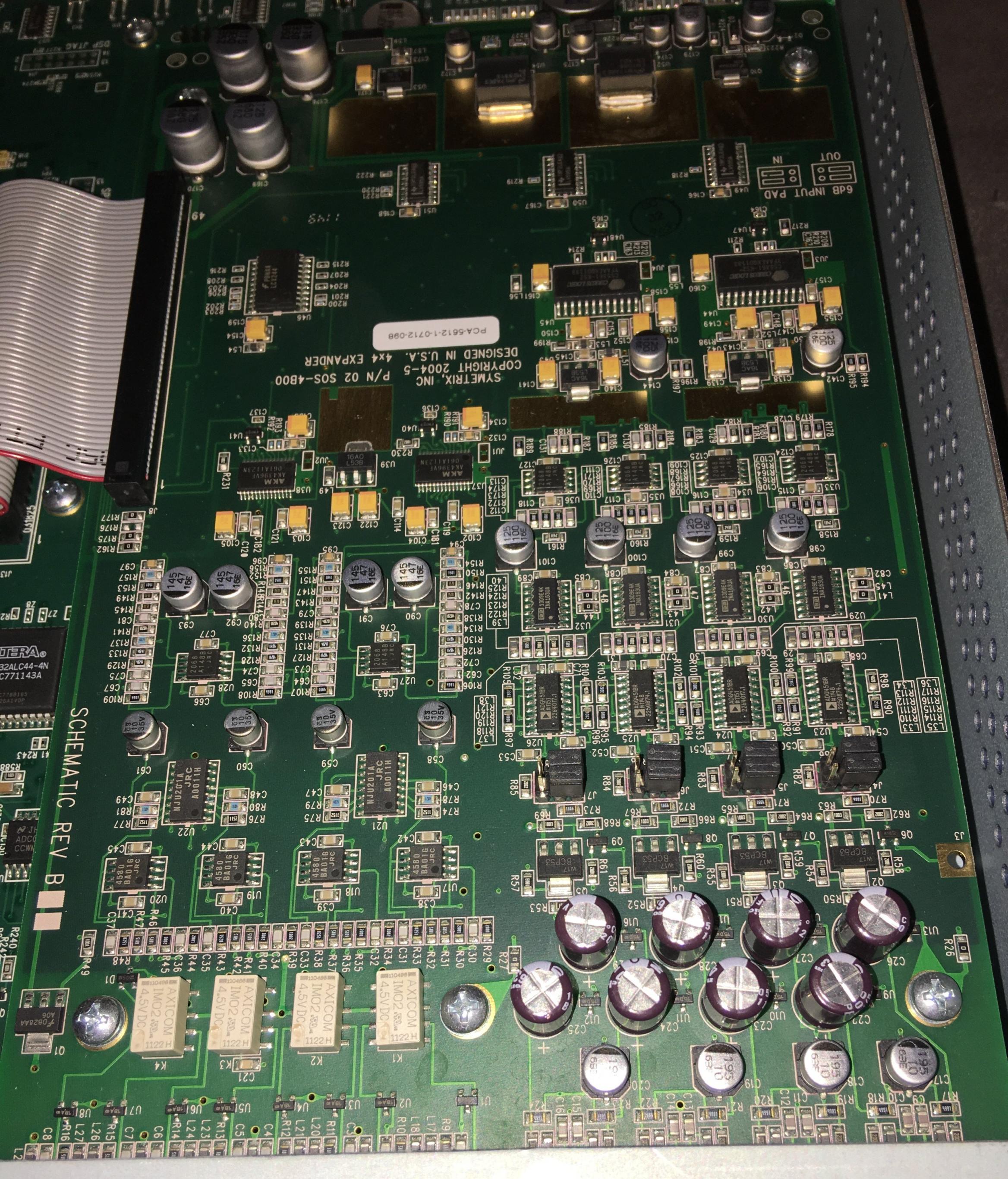

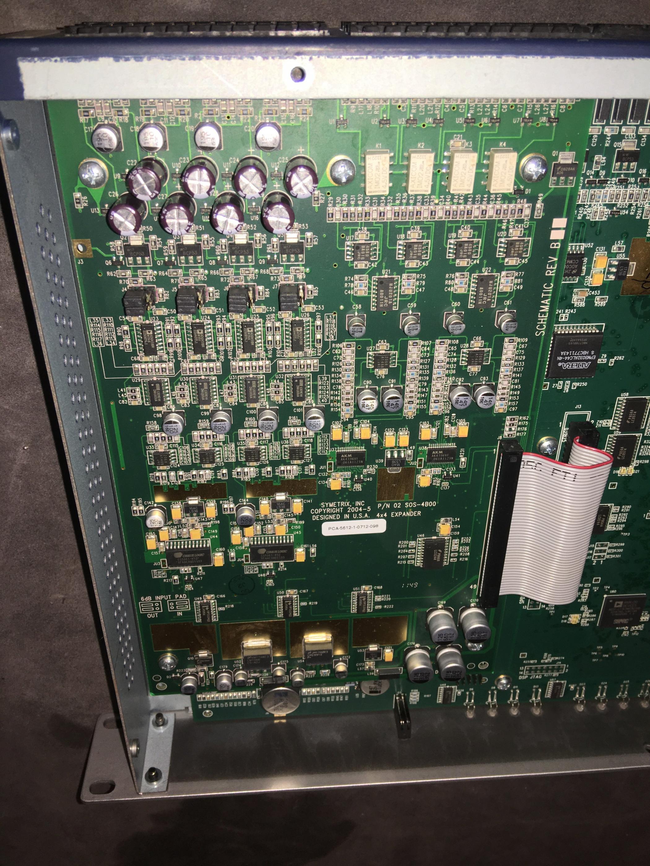

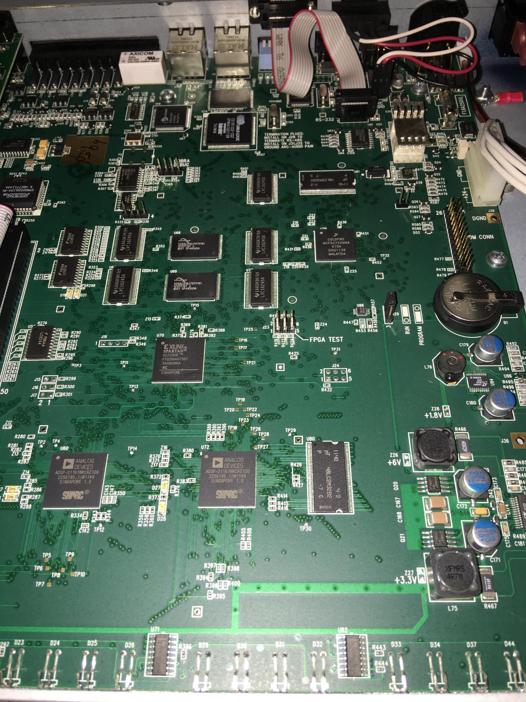

Okay,
I took it apart, I had to remove 8 screws to get to the board.
Not to shabby really. And there are multiple network types
available.
Pics are attached they are large so y'all can zoom in.
Demian, check it out, no folding the cards over eachother
and snapping them together.
I've got the software on the other two computers. I really
need to make a dedicated bench computer with a large
server with RAID. It looks to have some good chip stock.
the SHARC are supposed to be top shelf yes?
You guys tell me?
Heck, I got a schematic for it too, somewhere.
So for a couple of C-notes, on a good used piece
of gear. Free software downloads and a bunch
of support. I'm trying to think out of the box.

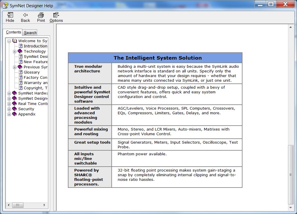

Look at the system solutions...I think any of these
boxes has a signal generator, meters, Oscilloscope, and
test probes all in it. (it may be virtual).

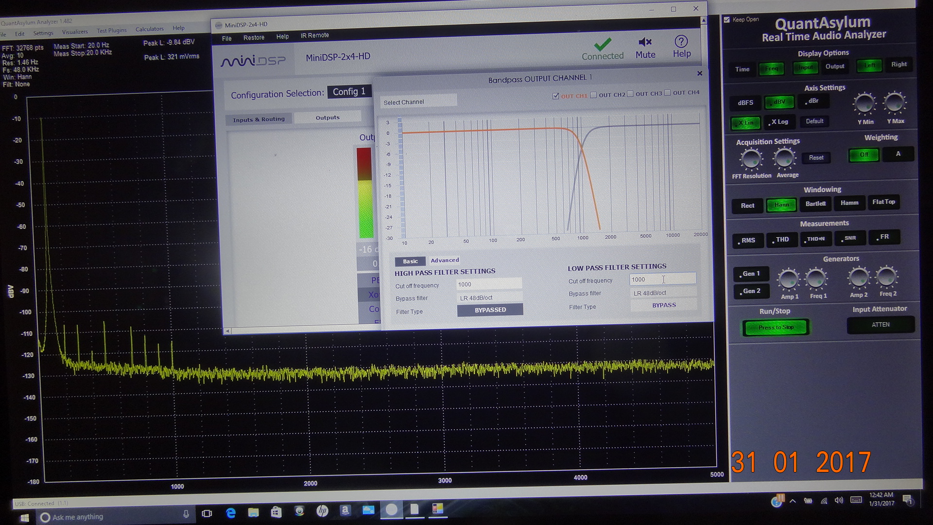

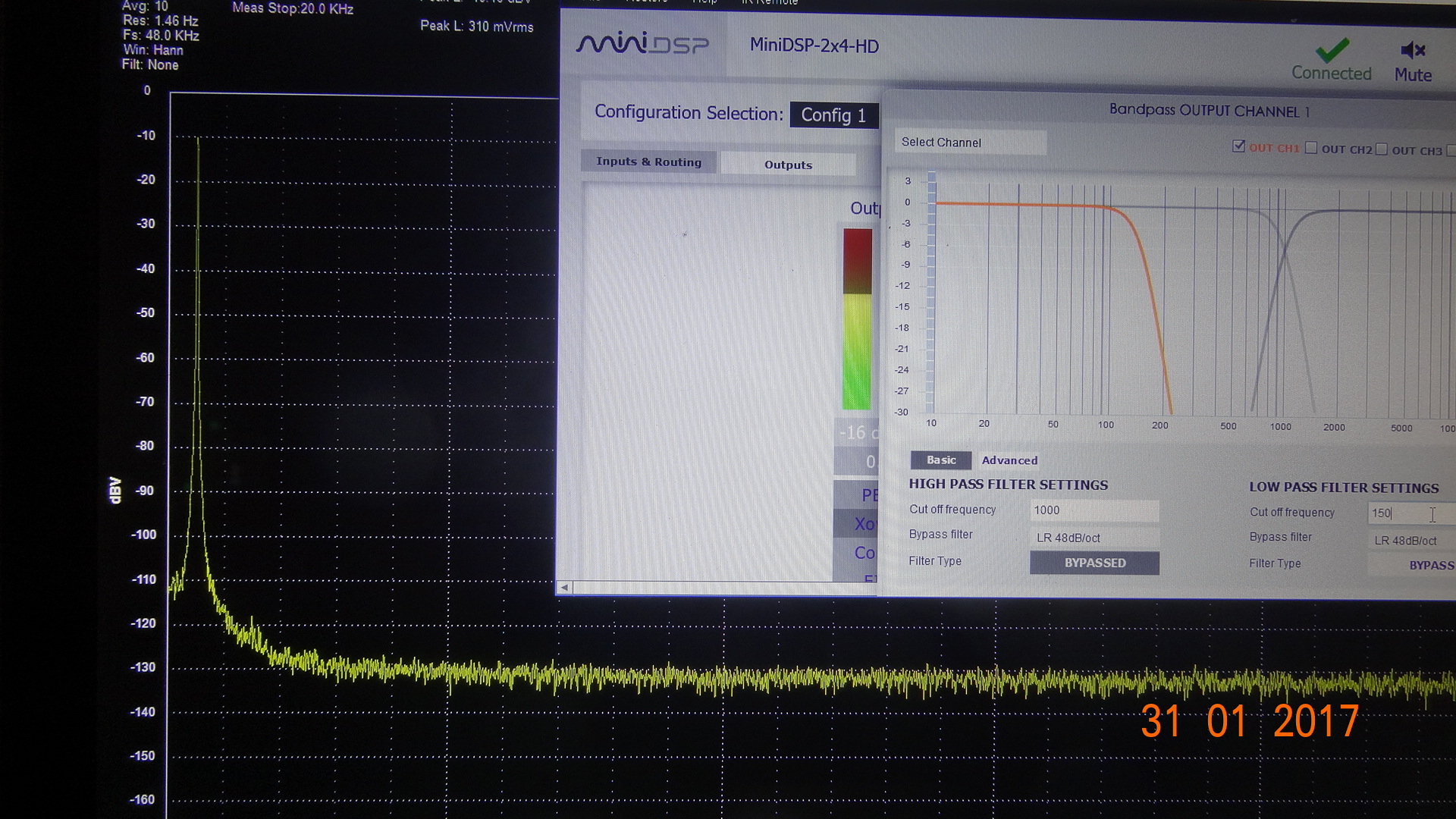

I like simple solutions ----
Here is a GP generator set to 100Hz and -10dBv. A General Purpose gen.;
The filtering is shown set for 2KHz and 1KHz and 150Hz. You can see the harmonics/noise dissappear beyond the filter setting.
Now all we need to do is find a way to sync a variable LP filter with the variable freq ultra low thd generator. Voila ! No harmonics.
