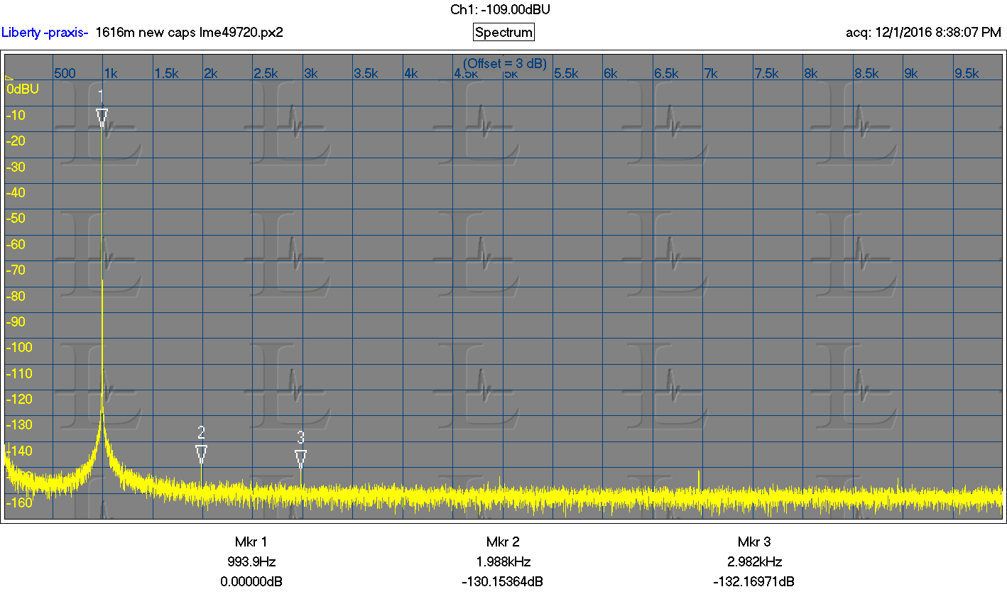

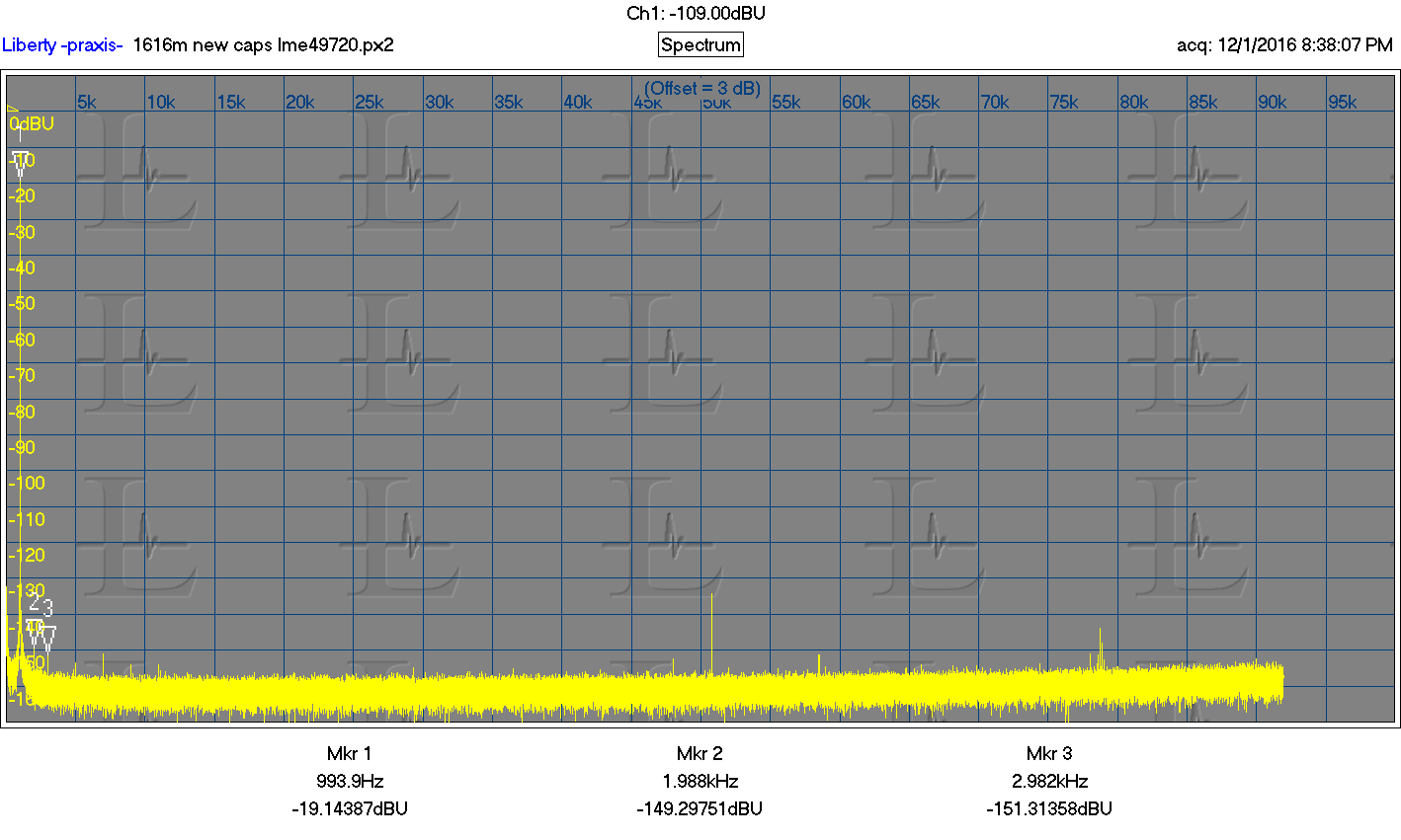

A note on power supplies for these sources. The supply Viktor uses on his oscillator provides pretty good noise isolation. I think the real key is that it doesn't connect to the circuit ground at all.
Two events I just went through confirmed this. First I was replacing some failed caps in the "0202" analog interface board for an EMU 1212M. This board has the AK5394A and a Cirrus DAC. I had upgraded the opamps to LME49880 but I noticed the caps were bulging. There are 4 470 uF caps on the ref bias for the ADC. They had deteriorated to about .47uF so replacement was due. With new 470 uF Polymer Electolytic caps (less than 100 mOhm ESR at 1 KHz) I wanted to verify the performance.
My oscillator array runs on 9V batteries and goes through them pretty quickly. Of course the batteries were dead when I went to test. I had obtained some cheap DC-DC converters from China: LM2587 DC-DC Boost Converter 3V-30V Step up to 4-35V Power Supply Module MAX 5A | eBay $2 ea. to see if I could make this run off of cheaper or rechargeable batteries. So I patched the cheap switcher in with the output at 34V and varying the input from 3.5 to 6V on my bench supply. It all works quite well. The first picture is the distortion residuals of the board at about -130 dB for 2nd and 3rd. This is at the optimum input level (-16 dBFS) and these do vary from channel to channel and chip to chip. The second picture is the full band (20 Hz to 100KHz) and the only spurs are at 52 KHz and 75 KHz. Those are there regardless of the source (and also on the 1616M) so I think they are not related to the source. However no power supply noise anywhere to be found. The notes on the supply say its switches at 100 KHz so there may be some higher frequency junk but its not showing anything in this measurement. I ordered some AC-DC 30V supplies ($3 ea) so see how well they work. Basically I'm less reluctant to use switchers now than before.
