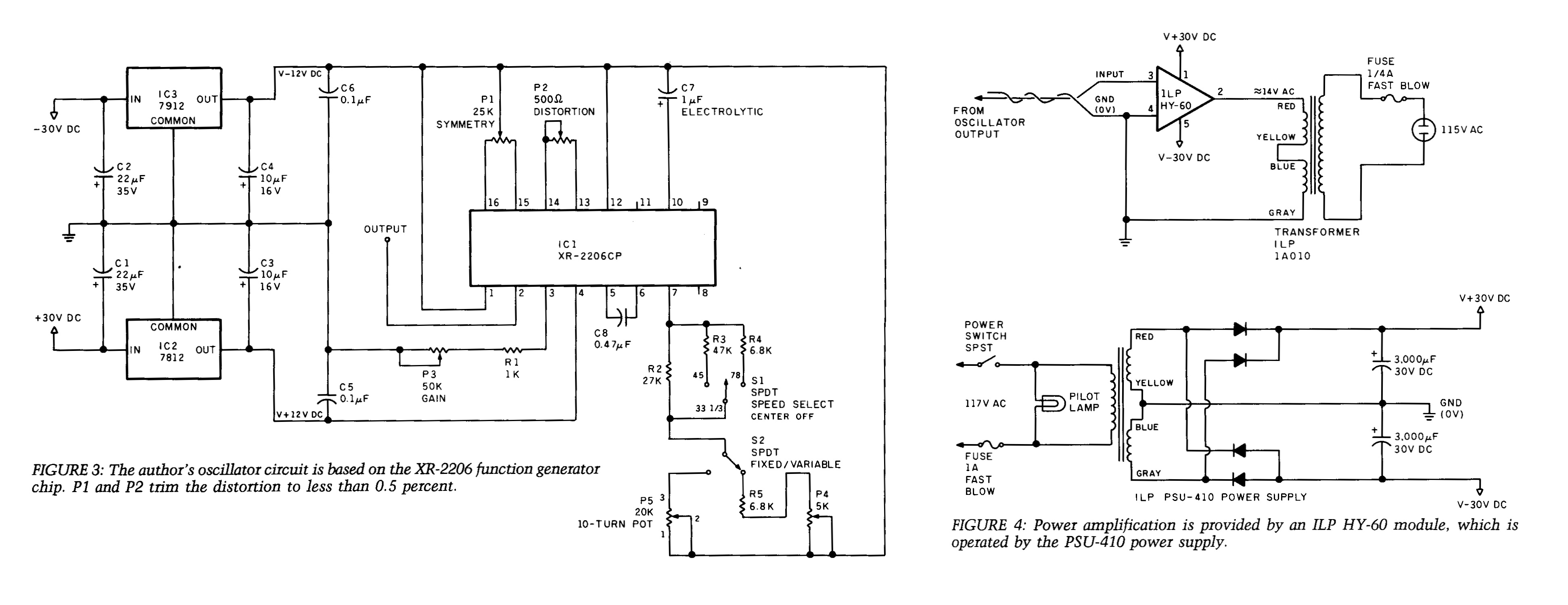

I am looking for a low-distortion oscillator than can output at least very low-distortion 60Hz and 81Hz, which I can use as the heart of a turntable electronic supply.
A digital chip might do the job, but setup should be easy. No programming, please! Something like a "digital XR2206" might work.
Anny suggestions?

A friend of mine suggests exactly that arrangement you mentioned. But I prefer a metal box holding it all.
As I would need a power amp to feed the AC transformer, using mains AC for the amp would demand AC input for it too.
This is the arrangement I'm thinking of, based on a Gary Galo's project from '86 in The Audio Amateur.
My idea is to find an oscillator with lower distortion to feed into the amp. Analog or digital.

And that transformer would move the Thorens motor?
I doubt those cores will do 60Hz, I mentioned surplus 12.6 because it was designed for 60Hz you just need a power rating (and it's a couple of bucks). The Hurst motor I had was 15W.

Filament transformers do not seem to work driven by amplifiers: the chips or transistors overheat and burn. The transformers have to be toroidal.

What matching transformers types are you thinking about? As I said above, for the load to work with the chip amps, the transformers have to be toroidal.
The Thorens would need two 16v AC outputs to feed each phase.
In the Galo's supply, the phase split was still done with capacitors. What you changed was the 110v supply, which was now electronically controlled 60Hz.
I don't see how that would happen without some parasitic oscillation causing it. This can be worked around. The telescope drive worked with a Radio Shack filament transformer.

Not true. Why would you say that? EI core transformers can work just fine at those and even higher frequencies. The core inductance needs to go up at lower frequencies. So as long as the transformer is designed for the frequencies you are running at, either type will do just fine.The transformers have to be toroidal.

For two speeds you need the two drives for the motor at 90 degrees. You can switch caps and other kludges but 2 phase drive is a cleaner solution. Any filament transformer would work. There are lots o options on ebay.
Resetting the oscillators is a matter of scaling the caps for the target frequency. Something like .01 uF to .22 uF for the two tuning caps (in head arithmetic so its not really correct) and the AGC needs to be larger as well.
You don't need 120V to spin the motor either but you do need more for 81 than for 60.
