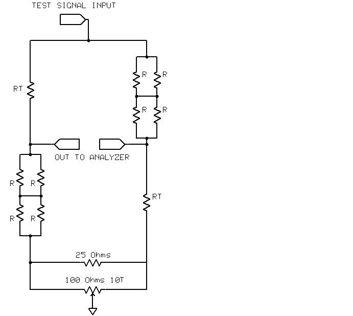

As to measuring resistor distortion fancy test gear is no longer required! Using the bridge method to suppress the fundamental makes it fairly easy. But you do need 10 resistors to test. For not as good resistors you can of course use reference resistors but you loose the ability to use reciprocity to advantage.
BTY the input signal must be balanced and floating. A transformer for this is fine if you don't have a balanced signal generator.
If you take two say Vishay S102 resistors in series and drive the top with your oscillator and force the center tap to ground with a second identical amplifier connected to the bottom you should get a pretty good balanced output. 🙂

I meant the variance in the distortion, anyway seems like a lot of work. And what about mechanisms that don't follow the parallel series rules?
The work is easily done by a spreadsheet. If the mechanism is related to the voltage drop then one device sees V and the others V/2.
What kind of mechanism do you see where this doesn't hold? If the behavior is the same at V/2 as at V then how could there be distortion?

Power goes as V^^2, but in any case what about a distribution in TC of +-X ppm/C. A lot of maths to de-embed all the resistors.
Simple enough if you use say 3 fours vs a single. Of course with enough parts you can use groups of 16.
Much more work than using a reference. But how do you get a reference? Change temperature and measure resistance? Change voltage? Then how do you measure temperature, voltage and resistance?
Reciprocity is neither fast nor easy, just able to be very accurate. The greater the sample size the better you can get.
