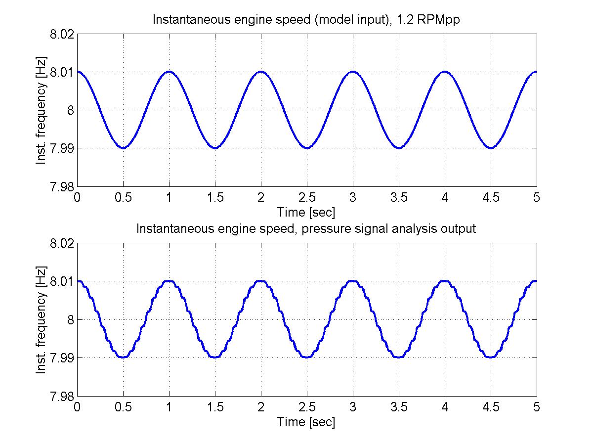

In effect, the post-processing solution mentioned above represents a software equivalent to a PLL locked to the fundamental.
For illustration, enclosed is a plot showing a variable-frequency argument used to generate a sine signal (upper curve) that consists of a unity amplitude 8Hz sine signal, frequency modulated by a 0.01 amplitude 1Hz sine signal.
The lower plot shows the instantaneous frequency recovered from the frequency-modulated signal generated as described. The original and the recovered signals agree in magnitude and phase; the latter can subsequently be used to perform the resampling of the acquired oscillator output.

P.S. Never mind the terminology used in the plot - I presented this to an audience of engine specialists, hence the terms "RPM" and "Pressure".

The problem of oscillator frequency variation smearing the spectral peaks of the harmonics

Looking at the Fourier series, the frequency of each harmonic term is a product of the respective harmonic number and the fundamental frequency. Now if the fundamental changes by a small amount DeltaF, the frequency of the k-th harmonic will change by k*DeltaF.
Since the DFT (Discrete Fourier Transform) has a constant absolute resolution, the energy of the k-th harmonic will be distributed (smeared) over more "bins" than the energy of the fundamental, hence the increase of the amplitude error with the harmonic number.
This is also of interest at the low harmonic numbers, for at the low levels even small frequency deviations can cause smearing that could lead to a particular harmonic being visible or buried in the noise.

I'll be glad to send you the Matlab script, but the original one is the company property and was written for a different purpose anyway. So I'll have to write a new one, and it'll take a few days time.@ DNi can you send me or post here the MatLAB file? We've got that at the

If you're interested I can send you the paper to your email address - the Conference Proceedings are unfortunately not downloadable.
Re. the terminology used to describe the results, since in the case of a varying fundamental there is no single frequency, we can only talk in terms a fundamental and the 2nd, 3rd, etc. harmonic. For lack of a better term I labeled the plot abscissas as "Harmonic order No." in the paper.
