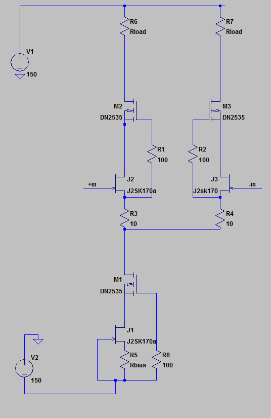

The Shibasoku amp circuit is not that difficult and I see no evidence of component matching in it. Just good traditional design. It would not be difficult to duplicate and even streamline somewhat. Using the JFETs to buffer the bipolar input pair and cascoding it all is involved but not difficult to replicate. I would use depletion mosfets for cascoding, it simplifies a lot the circuitry. It's still only good for a 600 Ohm load as is. Adding more oompf to support a 50 Ohm load would be worthwhile. And you need +/- 24V or more but you get 10V RMS with really low distortion.

Please send me you depletion mode cascode idea and I'll include it. Or post it here. Whichever. So what to use the for the Jfets?
No I don't think it's difficult and probably no matching of transistor except for the Jfets of course.
It's not difficult to beef up the output. I can think of a couple of way to do that.

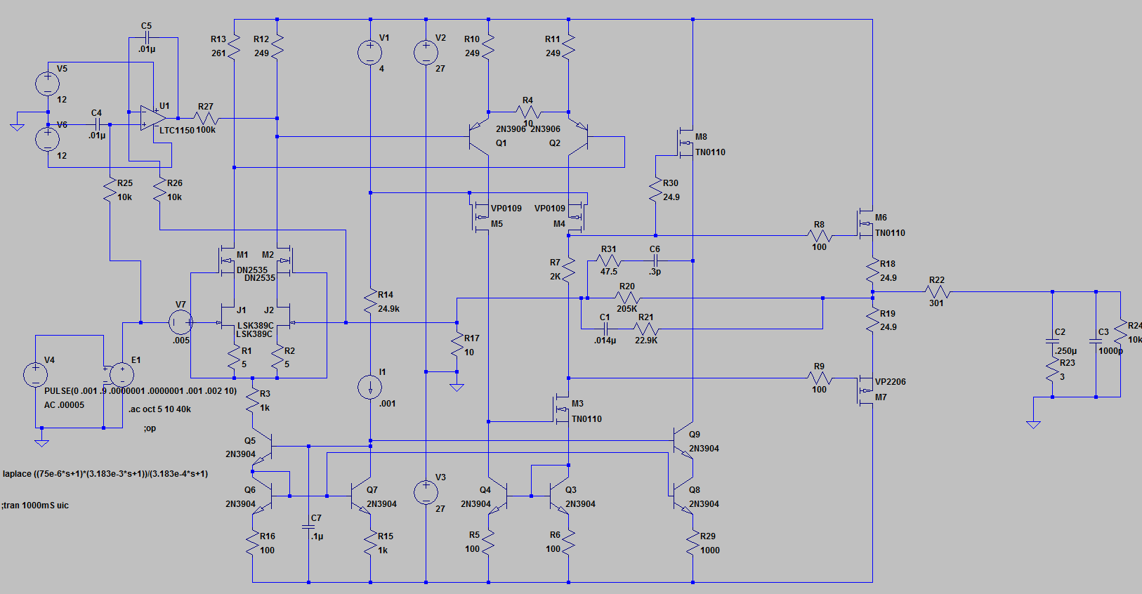

The circuit I used in the NuForce preamp is pretty close. This gives the basic idea. I can send you the complete simulation. Adding the bipolar pair will have higher voltage gain at the input. The low noise pair from Linear Systems worked fine in the NuForce with very low distortion.
I can send you the complete simulation but its a pain to get the transistors into the database. I may have some assembled boards around here as well. It uses more real estate and has more output drive than the Shibasoku.

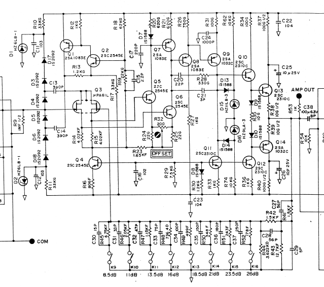

Demian, did you ever measure it? With all the circuits david tried and didnt get low enough, it's going to be a really big challenge.
IIRC, the 725 circuit used two Vas stages. Ultra-high olg.... surprised the composite opamp configuration didnt work well enough.

I did not have the Shibasoku when I designed that product. All the measurements then were limited by my equipment. The amp has 20 dB of gain and I measured .0006% THD, the limits of my hardware. I'll see if I can get a unit up and measure it again soon.

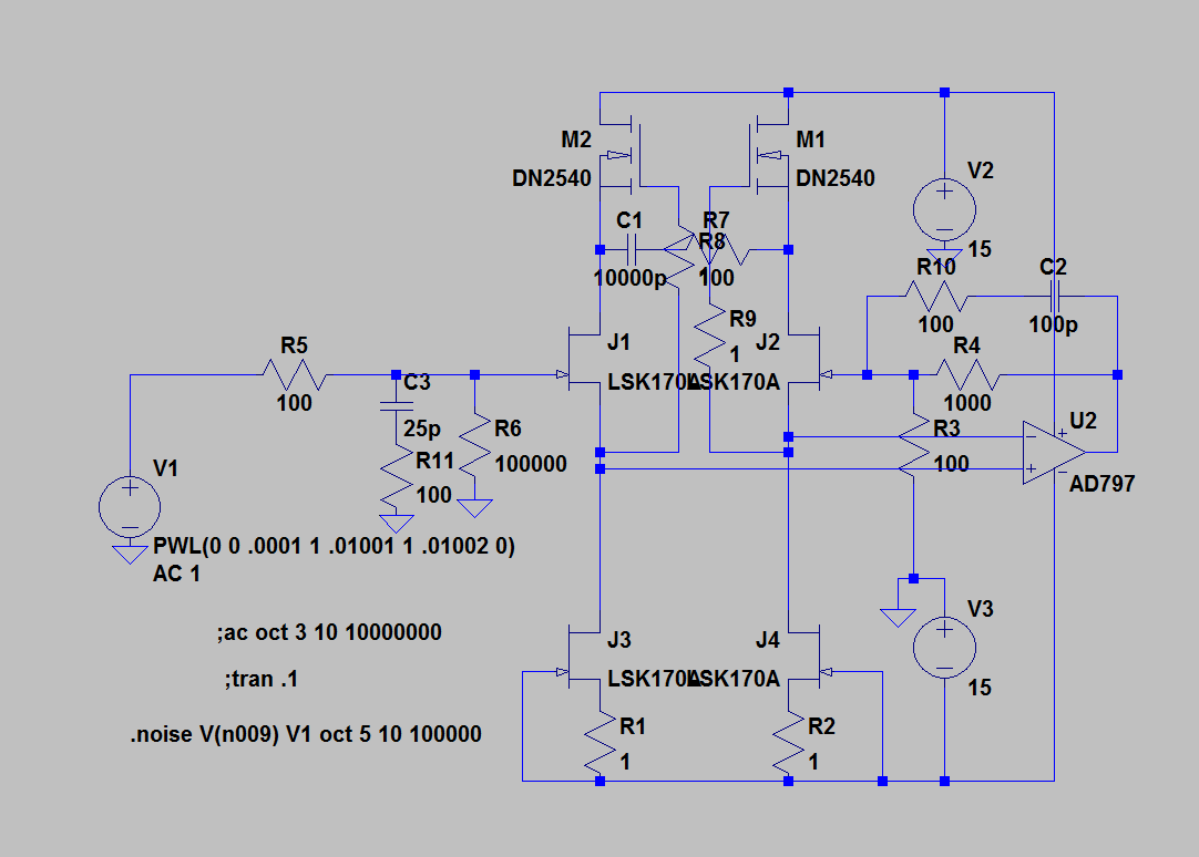

I don't see a second VAS in the 725 circuit (attached). I also attached the phono version of the amp I did for NuForce and a quick test of a FET buffer for an opamp. I can post the ltspice files and my modified parts files if there is interest.

Joined 2004
It doesn't show on the simulation but M8 drives an active shield around the high impedance output of the VAS. It also drives C6 as part of the stabilization network. I'm not sure now whats on the PCB. I may have used a gimmick https://www.youtube.com/watch?v=v1wWL6TGWOE . The sim is a mod on the original that had 20 dB of gain and a larger feedback cap there. The sim works with a pretty small error on the RIAA curve. I'm not sure I would make a phono preamp this way today. The FET buffered opamp may be a better choice. It would address the level dependent input cap on the opamp, which is the dominant remaining distortion source, probably for all of this stuff. And I would be tempted to use DSP and correct for the actual response of the phono cartridge.

I think Richard is looking at the current mirror. Kind of look like a VAS the way it's drawn.
