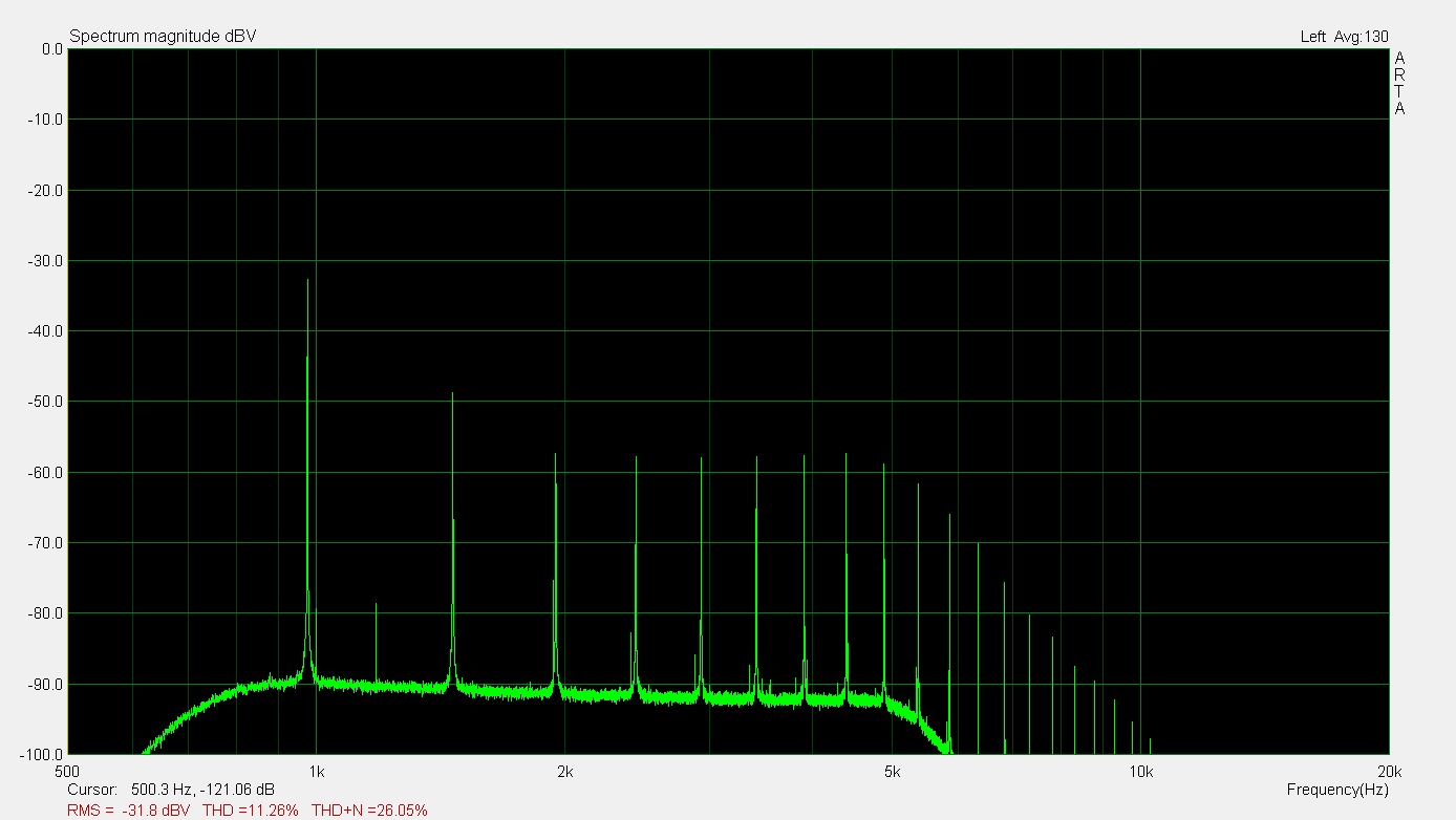

What passive notch does not need gain correction (second picture 2nd and 3rd harmonics are read directly off of screen). I might have missed one of Samuel's musings.

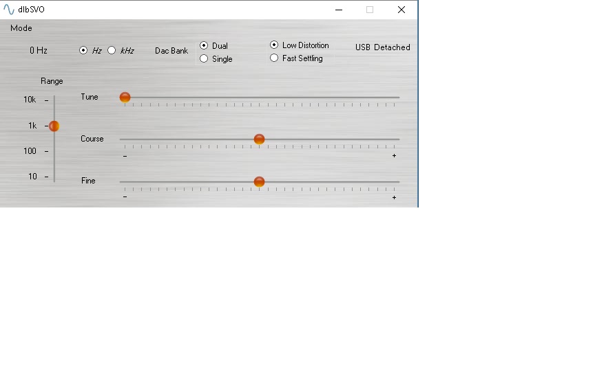

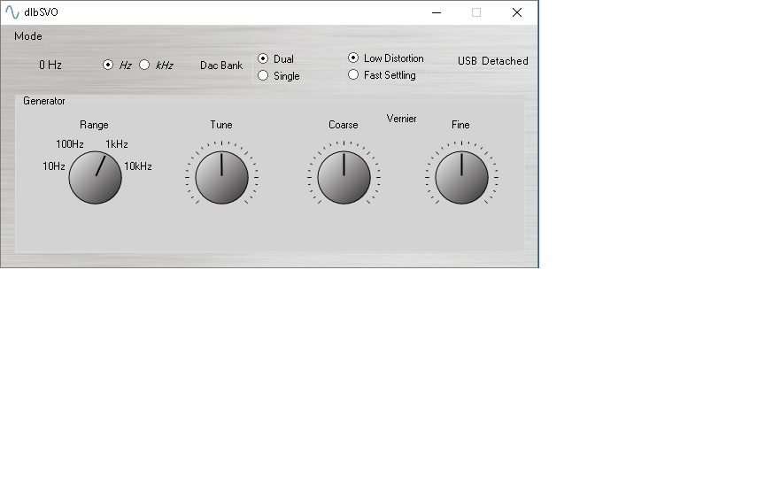

SVO UI
Hi Guys,
I made changes to my UI for the SVO.
The User controls on the original UI where a bit clunky in all respects.
I switched from rotary knob controls to slider controls. I'm still in the process of learning how to write my own controls so I don't have to depend on free offerings off the net.
I've added some functionality to the SVO which is included in the UI. I'm not quite ready to present performance data on these new functions but it's coming.
I've included a zip file of the UI. Please download it and give it a try. It won't do much without the hardware attached but you can still comment on the look and feel.
I no longer have an XP machine. I don't know that it will run on every platform.
It is written and compiled in C# for .NET on a win 10 machine.
I think the slider controls will work better on a touch screen as well.
Additionally, one person I send the old UI to for test had problem with graphical compression.Everything looked squished. I hoping this doesn't happen with the new controls.
A couple of pics of the old and new UI.

Hi Guys,
This is really nice..... cant wait to get my very own unit. The software GUI looks nice and straight forward for the user. Much appreciated.
THx-RNMarsh
On my touch screen the sliders work OK.
However I would prefer direct entry. One of the aspects of the Boonton is the synthesizer accuracy of the oscillator. It has a tuning/disciplining loop tied back to the master TCXO clock and its tuneable to 5 digit accuracy. That plus the direct entry of output with a .1% accuracy gets its performance close to that of a real calibrator. With a micro it should not be too hard to do.

Yes you've mentioned this before. It would be nice, very covenant.
But later on down the road as I have to R&D all that. The day job makes all this stuff really slow moving.
I have an alternative to this for the time being which allows for the tight tuning you're after.
I'll present this a bit later in the next two weeks or so.

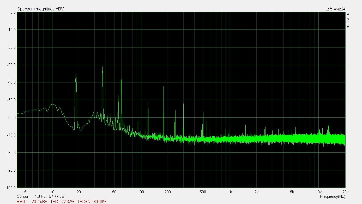

Well my SVO can settle at 20Hz to 95% in 2 seconds. But distortion at 20Hz is hard to measure because the harmonics collide with the power supply hum. Can we make 18Hz.
I recommend measuring at a frequency somewhere between 20 and 25Hz depending on your line frequency, and using a spectrum analyzer with pretty narrow bandwidth to look at the distortion output of your THD analyzer. It definitely takes care and patience to measure very low levels of such distortion in the presence of line and line harmonic frequencies.
This can also be a challenge in measuring power amplifiers. We usually talk about 1kHz THD and 20kHz THD, but one should definitely not ignore 20Hz or 50Hz (or thereabouts) THD in a power amplifier.
Bob
Hi Bob,
Here is the SVO at 18Hz 2.5Vrms measured on the Shibasoku 725D
The fist pic is in normal mode. The range is 0.001% (-100dB)
0dB on the ARTA scale is -100dB since the monitor output of the 725D is 1Vrms FS.
The meter is reading 9% of FS. So 9% of 0.001%. This calculates to -120.9 dbV THD+N.
To get past all the PS hum I switched the analyzer to analysis. In this mode the 725D suppresses the noise using synchronous averaging. This make it possible to measure the THD. In analysis mode the Shibasoku shows the first 10 harmonics. The fundamental is not visible
With all scaling the same. The meter is reading 3% of 0.001% which calculates to -130dBV
THD.
