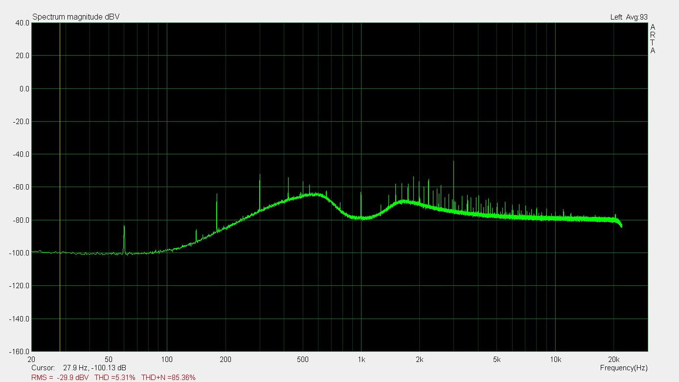

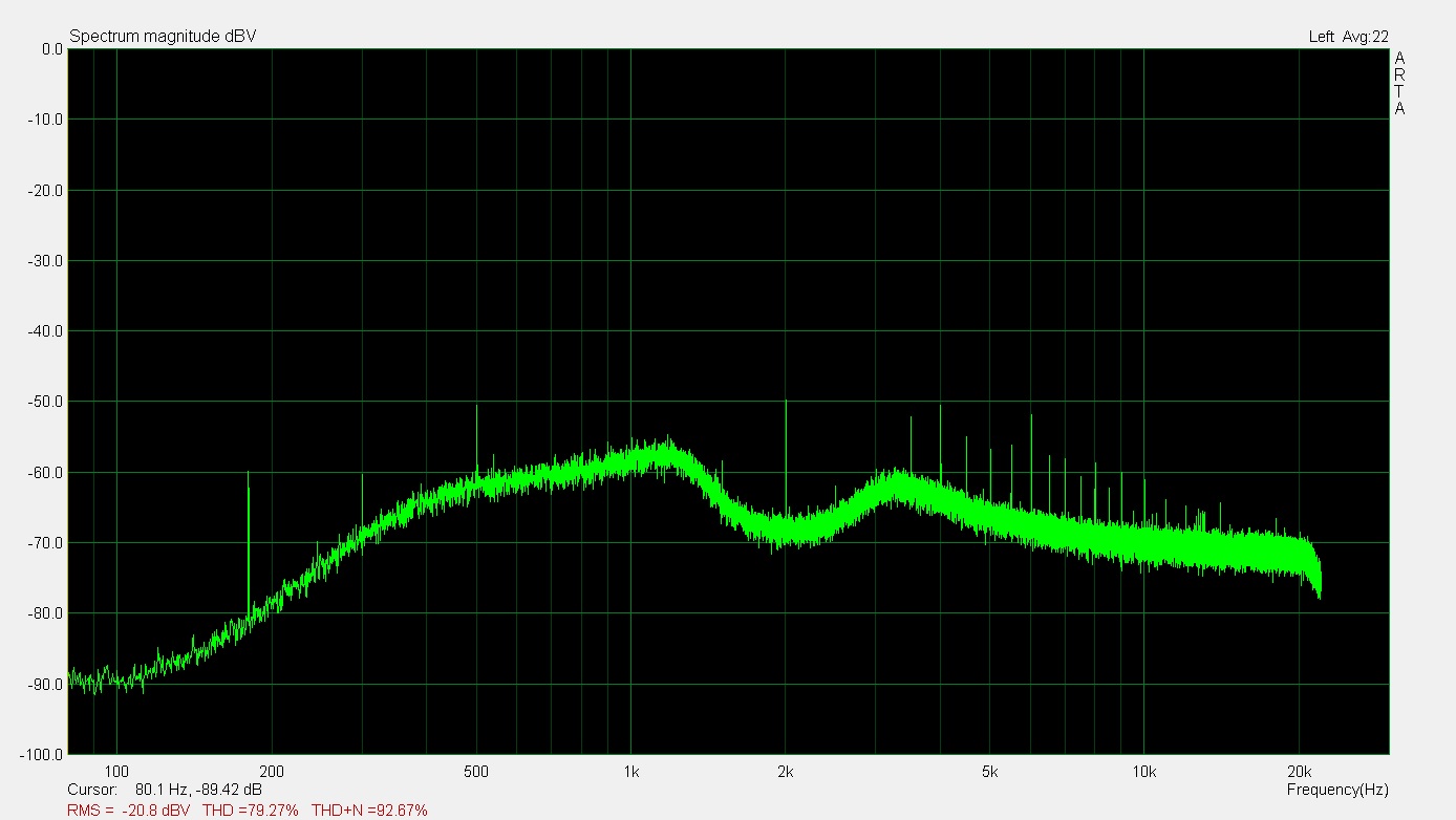

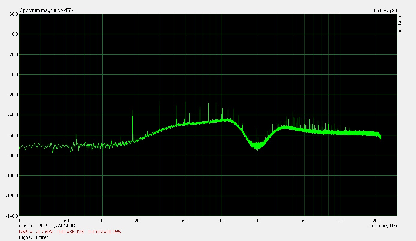

This oscillator is the second generation. I added the capability to function as a high Q band pass filter. In this mode the multiplier is reduced to a two quadrant multiplier operating as a voltage control variable gain inverting amplifier. That's probably not a good description because it just attenuates. No the less the positive feed back is removed and the multiplier controls the damping of the filter depending on the injected level. For -60db input the output is 2.5Vrms.
The fist pic is the output of an EMU0204 which measure -90dBV THD+N. Not that great.
The best the 0204 can do is 0dBu output level.
The second pic is the emu0204 injected into the SVO as a high Q BP filter.
The measured distortion - -100dBV. But the individual harmonic has dropped significantly which suggest the measurement is mostly noise.
Both of the measurement are on the 0.003% (-90dBV) scale. So -90db at 0db ARTA.
From a cleaner source the result should be impressive.
The output frequency is that of the source.

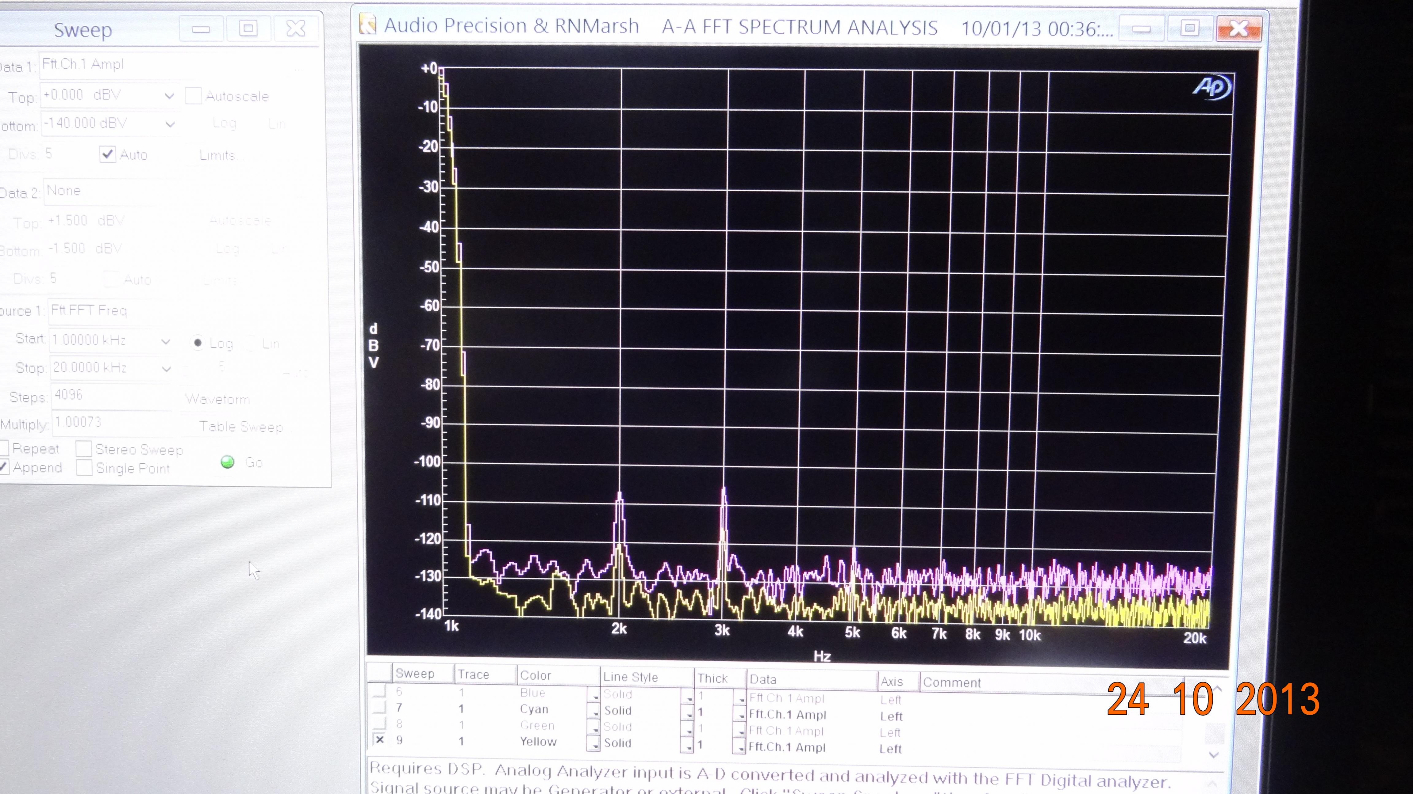

Thats great. Some may not know but we/I went thru many gyrations trying to get low enough measurements... I started with AP Sys One dual domain and modified sound cards. Then modified an HP339A, then ShibaSoku and various Panasonic and AP 2722. Along the way, added notch filters and finally K-Hite generators. It finally came down to needing a better osc/generator. Why all this? because I couldnt measure the distortion of a little headphone amp I made. With the best instruments, I STILL cant measure the distortion.... I used the instruments to fine tune the circuit. Now, with a gain of 12 I just amplify the AP osc/gen without seeing any added distortion level or harmonics. [See below] Now I need a better osc/gen. And, here we are ---- I will now measure to lower levels than the internal osc/gen of the AP. I am very thankful that there is so much talent here to take on the challenge and tasked themselves to do their best. I continue to learn thru the process from others who have gone before me and into the future. We all learn and get something from the shared support and process.

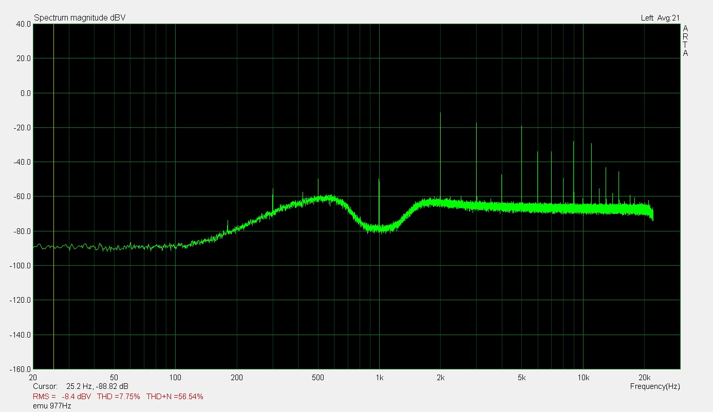

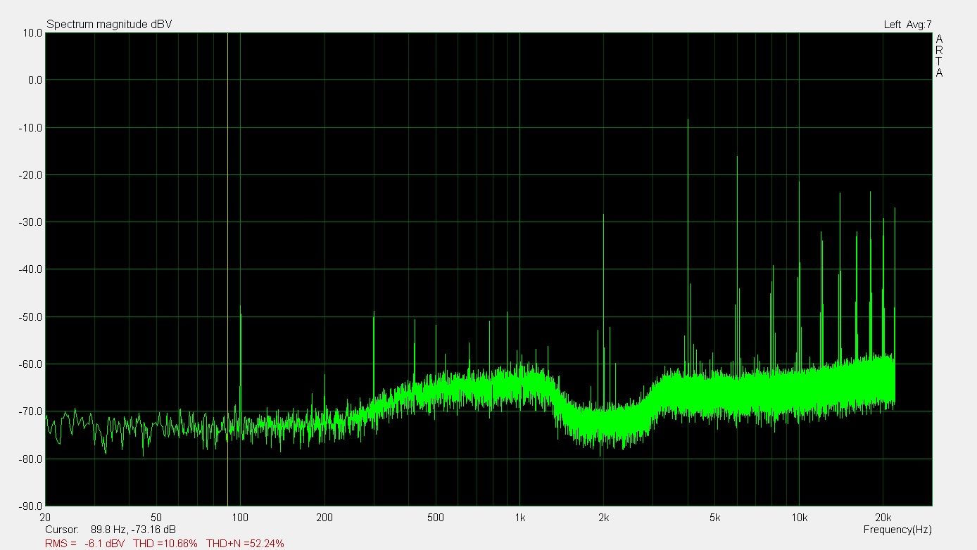

A couple more at 997Hz. The emu output is cleaner at this frequency.
Pic 1 emu @ 997Hz -120.9dBV THD+N
Pic2 is 997Hz through the BP filter. -119dBV THD+N
Scale is -90dBV
