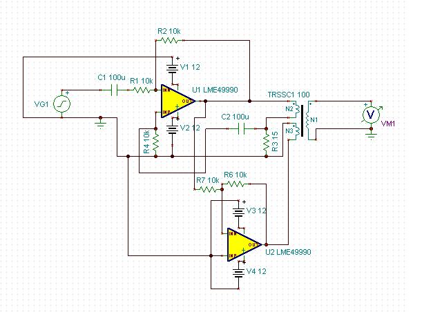

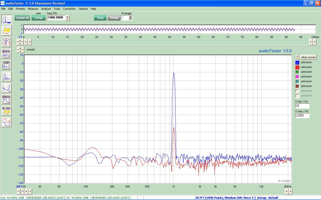

So, I have some good news anyway. I lashed up a LME49720 in a mixed feedback arrangement with a Jensen 112-LCF output transformer (not their best output transformer by far) and got this result. I think it's pretty good. On the bench, bandwidth was really great. It's running on 2x9V batteries.

Are you using the feedback technique in there app note?
It look like it needs some trimming.

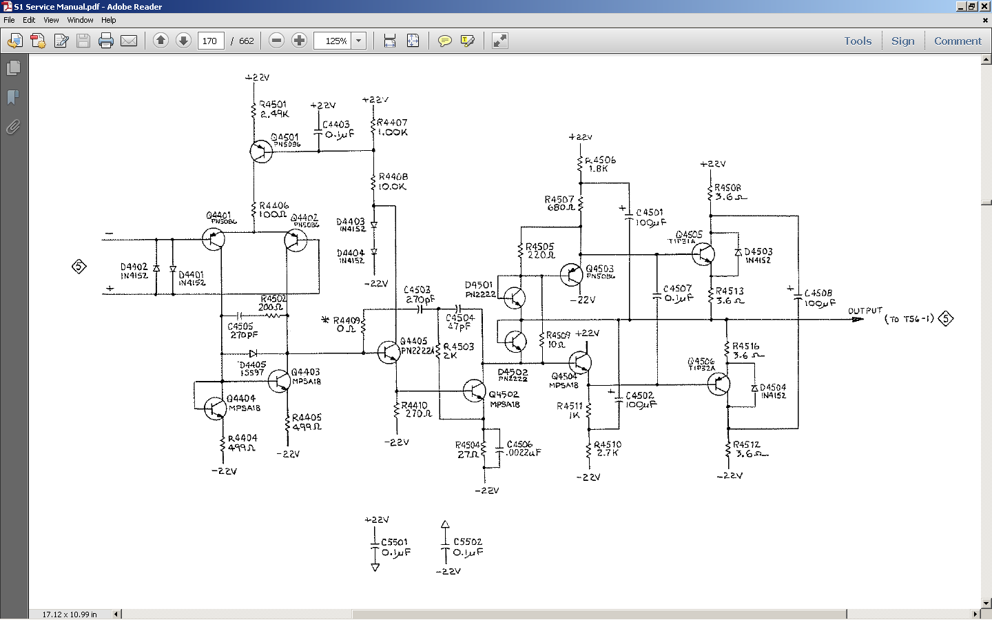

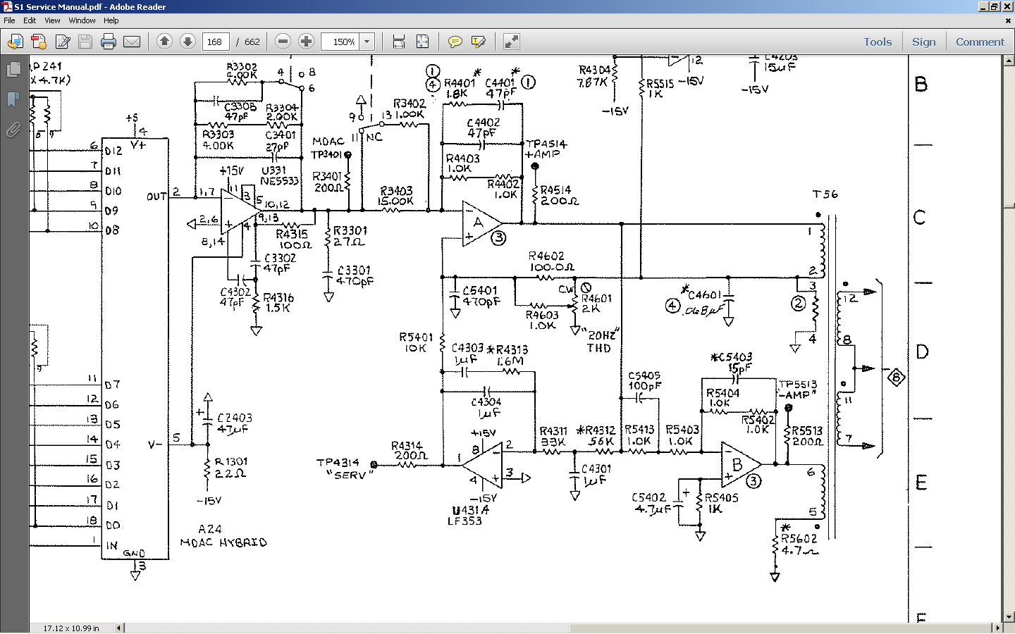

Well get the noise down. AP used this in the SYS1 with outstanding results.
The op amps are discrete of their design. They look more like small power amps.
David.
I can see why the op amp "A" would have to be powerful, since it is driving op amp "B" with a 1.0 kohm input impedance in parallel with the transformer load and the (1.0 + 1.0)kohm feedback resistors. The op amp "B" has to drive a (1.0 + 1.0)kohm feedback resistors in addition to the transformer load. I remember reading about the temperature compensation winding 2 (xfr connections 3 + 4) to reduce distortion even further. They also added a servo U431A. (Why do designers put 2x1.0 kohm resistors in series when a perfectly good 2.0kohm resistor is available?)
Since I'm only interested in 1kHz performance, I probably don't need a lot of extra do dads.

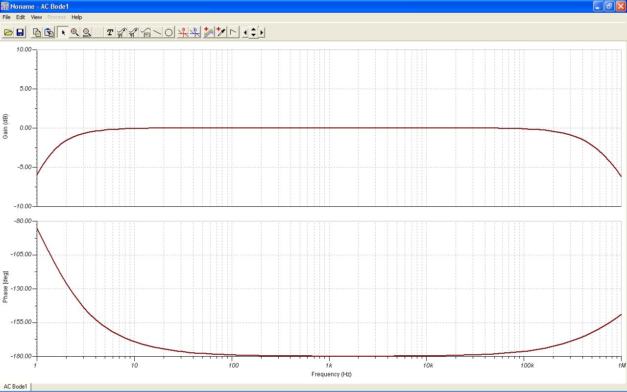

Here's the simulated Bode plot for the above circuit. Obviously, I don't need response to subterranean levels, but I did want no phase shift around 1kHz. For general purpose use, the coupling capacitors could be increased in size to get the lower frequency cut off down to 1Hz or so. As it is, it appears to be fine for both 1kHz and 10kHz oscillators. Also, since there is no funny resonant peak in the HF response, then no compensation capacitor in the feedback loop is required.
