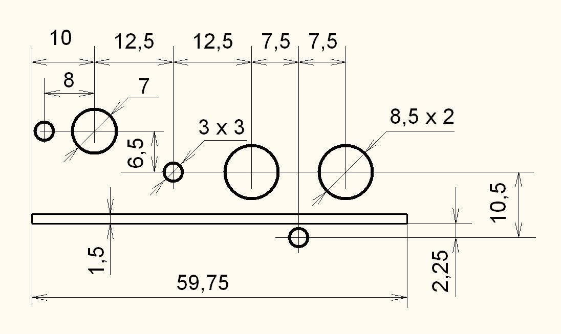

Also, since Victor didn't supply a template for a face plate for his oscillators, and the fact that I'd more than likely NOT get the holes in the right place, I'm going to modify his board. I'm going to take off the pot, the LED, and the two RCA jacks and use different ones directly on the front panel and wired to the board remotely.
Template is on his eBay listing. However, your idea gives a lot of flexibility.
Yeah, I have difficulty doing layout to 0.5mm. I didn't see that before obviously.

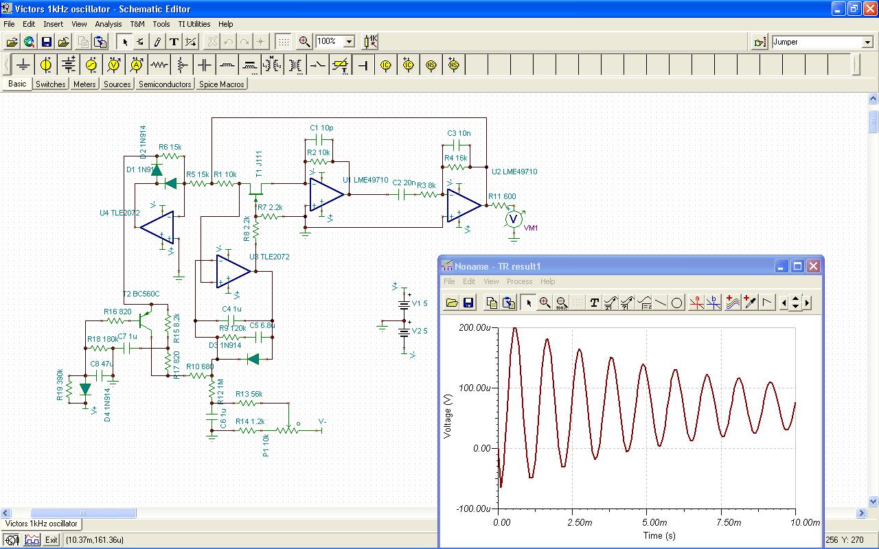

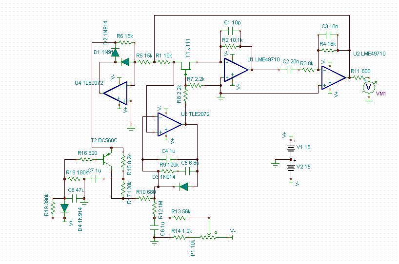

I put Victor's oscillator into Tina just in case I need to make one myself. I'm not sure it's oscillating. I looked up the parts he's using and used something else that's similar, like a high gain PNP transistor BC560C, and the J111 jfet. I don't really understand this circuit, so I am unable to fine tune it. Any help is appreciated.

I don't use Tina so I can comment on that.
Your loop gain is too low.
David.
If you know how to install parts into LTspice I can send you Jfet models.
David.
Hmmm, thanks. I did notice that I had the power supply set to +/-5V, so I changed that. The J111 jfet is supposed to be the same as the one Victor used. I also copied all of his resistor and capacitor values. How do I increase the loop gain?
Dirk,
1) I see two mistakes in schematic:
R17 must be 120k.
R10 must be 10k + 100ohm.
2) Settling time after swich on is tens of seconds. Simulator must be configured for this, if it possible.
3) Power supply voltage must be +/-15V. With lower voltage, you may not drive JFET properly.
The RDs on matches and that about it.
The Idss is much higher and the capacitance is lower for the 4391.
I'm not sure the the gate is ceter on the j111 as it is with the 4391.
I have the model if you want it.
You can try decreasing R7's value. It's tight for gain adjustment with this oscillator.
Any attempt to increase gain at the output drive will upset the filter.
David.
Dirk,
R17 must be 120k.
Thanks!
I have trouble using my software to look at this circuit. I tried the software 'scope but didn't see any output. Since it doesn't have a signal source, I'm at a loss right now to figure out if it's working correctly.

Thanks for your help.
I'm getting basically no voltage across the jfet. I can't figure out why. There's a tiny negative DC voltage from drain to source, and the gate is at 170mV or thereabouts.
I just need the *.lib file for the jfet, thanks.
