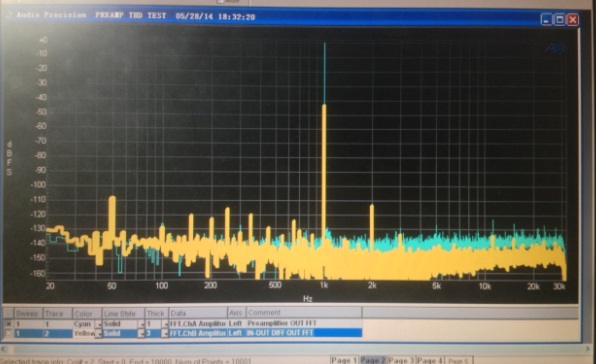

Per my experience with AP ATS-2. This equipment can not be trust when a low distortion signal is feed to it. Here low distortion means 1kHz fundamental signal with ~-130dB harmonics.
I've done a experiment on my preamp:
1. set the peramp to unity gain.
2. SE signal source from AP 2Vrms. (20ohm source impedance)
3. AP analyzer CH1=preamp output -- GND, (100k ohm impedance balanced)
4. AP analyzer CH2=preamp input --preamp output, (100k ohm impedance balanced)
5. Adjust the preamp gain until the voltage monitor of CH2 to lowest level (with notch filter 1kHz on AP)
and then, I got the following measurement result:
CH1=preamp output with AP source distorion plus AP anayzer distortion
CH2=??? (residual distortion of preamp only?)
BR
Paul Lu

Per my experience with AP ATS-2. This equipment can not be trust when a low distortion signal is feed to it. Here low distortion means 1 kHz fundamental signal with ~-130dB harmonics.
Measurements at the -130 dB harmonics level are very difficult--it's at the edge of what can be done with the SYS-2722 (near 1 kHz at least, no chance below ~100 Hz and above ~5 kHz). As noted already I can't give an easy solution because there isn't one. Both source and analyzer would need to be independently specified for < -140 dB performance for reasonable measurement uncertainity. Currently there's no fully worked out design available (neither DIY nor commercial) which would consistently support this performance level.
If fixed 1 kHz fits your needs you might check Victor's oscillator (there must be a link to it in this thread).
Samuel
