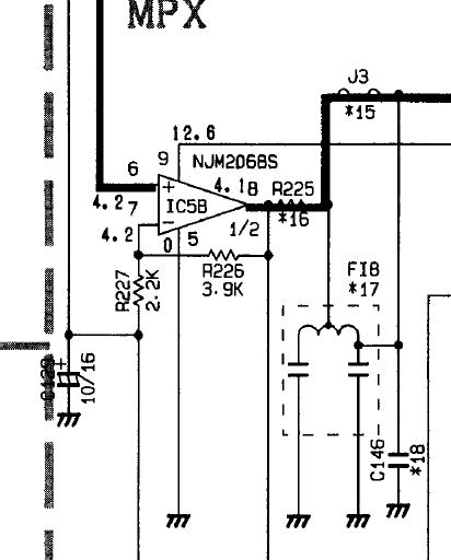

RE Paralleling opamps- I saw in the Yamaha TX950 tuner they did parallel the two 1/2's of an NJM2068 in production. They did this to get the noise floor lower. Since the parts were on a common substrate the offset differences may have been very small. The schematic clip below is not easy to follow but I traced the PCB and confirmed they just paralleled the pins. That was a high volume product so they could not sort opamps for offset differences.

I have always used per amp local feedback and current sharing R for paralleling op amp outputs

I also tried to parallel the 1468... and got same results you did. I thought at the time... IIRC.... that it was dc offsets that caused the heating up ... maybe they were trying to sink/source the dc offset preventing direct parallel use in the oscillator role for the HP339A. I'll have to find the Bob P offset equalizing method.
When I get back to my lab in California I am going to try a lot of IC's to see which can be directly paralleled and which need some small additional fix to make them useable in parallel.
But dont wait for me....
