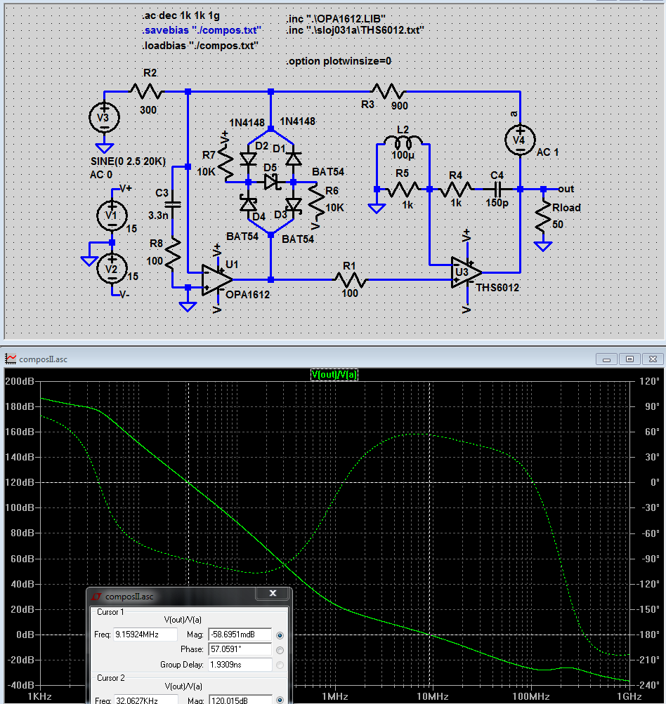

If its an inverting amplifier the TPA6120 as an output amp and even an LME49720 dual would get both phases on the output pretty easily. Witht he inverting amp and 600 Ohms in the noise of the LME49720 will not be an issue. Running the two 1/2s of the TPA6120 in opposite phase may reduce some of the secondary distortions that come from power supply modulations etc. You could use the LME49990 or AD797 or LT1115 as lower noise alternatives if noise is an issue. Checking my records the limit of the TPA6120 is about -109 at the second harmonic in noninverting mode. With its power bandwidth of 160 MHz it won't be the limiting factor in closing the loop.
I reworked my old compos.asc sim with new low noise input OPA1611 and the THS6120/TPA6120 for the output
trying for all the loop gain that can be squeezed to the outer loop I get 20 kHz THD <-160 dB 7 Vrms/50 Ohm load - for whatever the sim # is worth
the simmed loop gain shaping gives near 60 degree phase margin while having over 120 dB loop gain to 30 kHz
the modified integrator feedback and the 100uH inductor shunt push all the gain that can be had from the CFA output op amp into the outer loop for the extended audio frequency range - haven't tried the inductor trick in the real world - but I did choose a model that has a parasitic parallel C so maybe its not too unrealistic
also used noise gain shunt at the input to improve the loop gain intercept region
I find LTspice convergence problems with these ridiculous high loop gains - if you mod the circuit much you may have to retry the .savebias/.loadbias (un/re comment the lines on the schematic, possibly esc out of long startup stepping)
should run in the composII folder - I think I got the models and bias files too

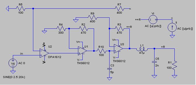

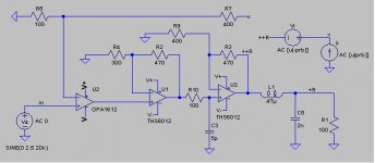

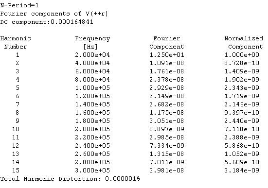

I ran a spice analysis of a composite with the TPA6120 - LME49990, AD797, LT1115 and OPA1611. The LME49990 didn't as well as the others. LT1115 has a problem when over driven. The TPA6120 doesn't have quite enough gain to push the distortion to were I want it, at least in spice land, and remain stable so I used two. According to spice it works very well but it's a bit marginal on the stability. I'll try it and see what happens.
I can bundle this into a zip if you want to play around with it.
1.3uVrms @ 30kHz BW

I like this one better.
What do you propose for an inductor. 100u is a fairly large air core.

Your using some tricks in here I've never seen before. Can explain the integrator thing bit more?
