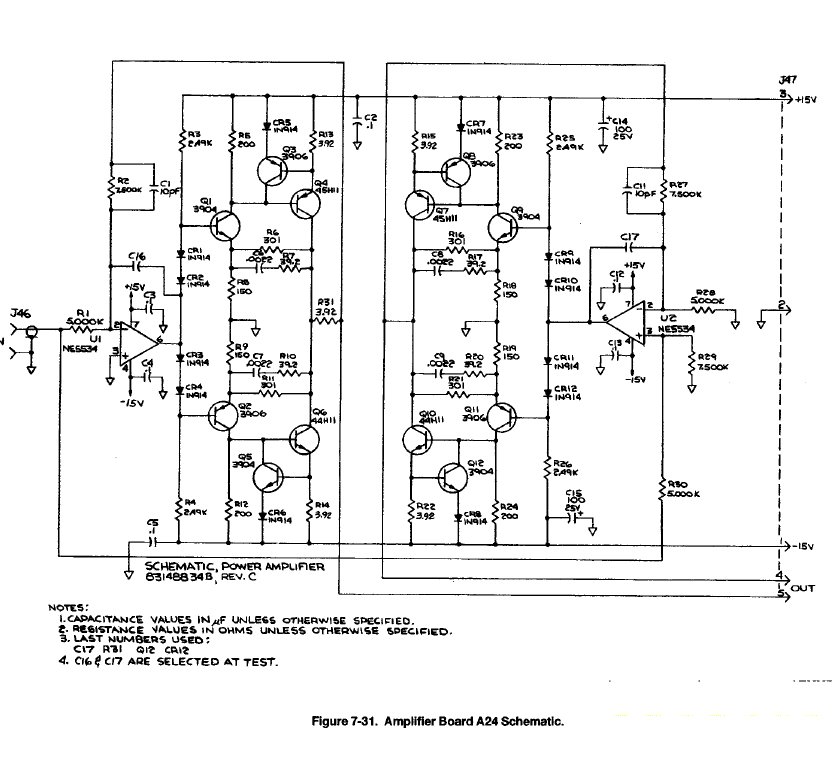

I haven't seen a State Variable the doesn't use an output amp. They typically have to run at a lower output level to obtain a low level distortion. No more than +10dB for mine to get the harmonics below -140 b/t 1k and 10KHz. Victor's oscillator I think has a max of 2.67Vrms IIRC and would require a post amp for higher levels. If +10dB is all that's needed then no post amplifier is required.
So we are comparing apples to apples, B Cordel's uses a post amp. The gen in the Sys One
uses a post amp and IIRC so does the Tek SG. All SVO's. IIRC the KH uses a bridged T which like the HP339A operates at a high output level of about 20Vpp.The 339a has a buffer amp.

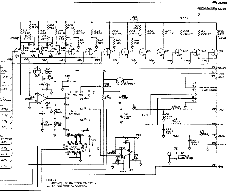

Samuel how are you going about determining R values for minimizing the effect of power coefficient of the resistors. Obviously physical size of the resistor must play a part. Would it be useful to mount resistors over a copper plane to spread the heat or is it this strictly an instantaneous power effect?
600 ohms is still useful as a compromise impedance level for constant-impedance step attenuators, since its degree of loading allows relatively high output voltage levels without resort to a high-power output buffer. To have such constant-impedance attenuators at 50 ohms reuires significantly more power for a given voltage swing. It is true that there is no longer much sacred about the number 600 ohms. I believe that the origin of the 600 ohm number was that it was the chosen characteristic impedance of open-wire telephone lines.
I tend to doubt that power coefficient of resistors is responsible for what you are seeing; I don't think the 339A is fundamentally low enough in distortion to unmask that effect unless they used really crappy resistors. I think the power coefficient distortion only occurs at low frequencies unless there is some phenomenon in them that I am not familiar with. Does the rise in distortion with attenuator loading increase similarly on all steps of attenuation, or just the maximum output step? Who knows, maybe the switch contacts are dirty.

I'd have to dig into it again to be certain. It was a long time ago and didn't care much at the time. Just thought it was rather odd and not easily explained. Dick confirmed the same on his 339a. He didn't believe it when I mentioned it to him so we both checked twice.
I don't think HP used any crappy parts in the oscillator except perhaps the inter stage coupling caps. Switches had been cleaned but given their age....
Come to think of it I used a wire wound pot to do the loading. Maybe it was the pot?

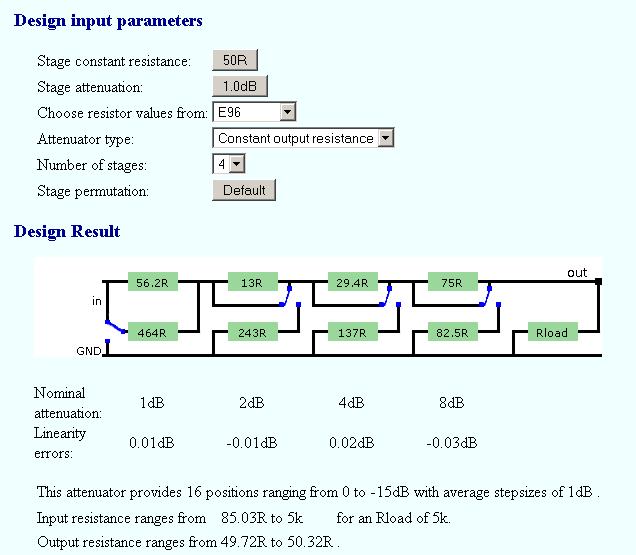

On the 50 ohm attenuator; I did some back of the envelope calculations on this last night.
For a 20Vpp signal we would require a 4W resistor at 50 ohms. For a constant 50 ohm output impedance the input resistance will vary increasingly and the power requirement lessens but we would still be looking at 1W to 2w parts. To do it right 0.1% parts would be required. I think I have to agree with Bob that the power requirements make it to costly.
If 50 ohms is required padding the output with T networks would be a better option but it would still require a headphone size power amp to do it which is not unreasonable.

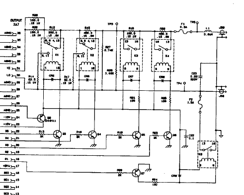

My Boonton has the ability to drive 16V into 50 Ohms and pretty low distortion. A variation on that design (bridged tied load) is not that hard to do, you just need more forward gain and enough heat sink for the output devices. Possibly wrapping something like the TPA6120A2 http://www.ti.com/lit/ds/symlink/tpa6120a2.pdf inside a loop with an LME49990 (compensation will not be simple) will give 700 mA peak. And the chip is good for .0006% THD without help and 100 MHz power bandwidth. it was designed for DSL where some money can be made.
Using an amp to source the signal works at higher levels but its noise floor limits everything at lower levels. A resistor network is really the only option. It does not need to be constant impedance as long as the output is low impedance.

I found this online calculator for a log network. 4 relays get us 16 dB in 1dB steps at nominal 50 ohm constant output impedance and all resistor values below 500 ohms.
Logarithmic Attenuator Calculator
I would just lift the architecture of the Boonton's oscillator and output. It has a high res FET based attenuator (swap for relays) a power amp with bridged load drive in a floating setup. It really works. Let me know if you need more details.

I'm just going to try 2 or 3 50/50 dividers and then a very high quality low Z pot.
