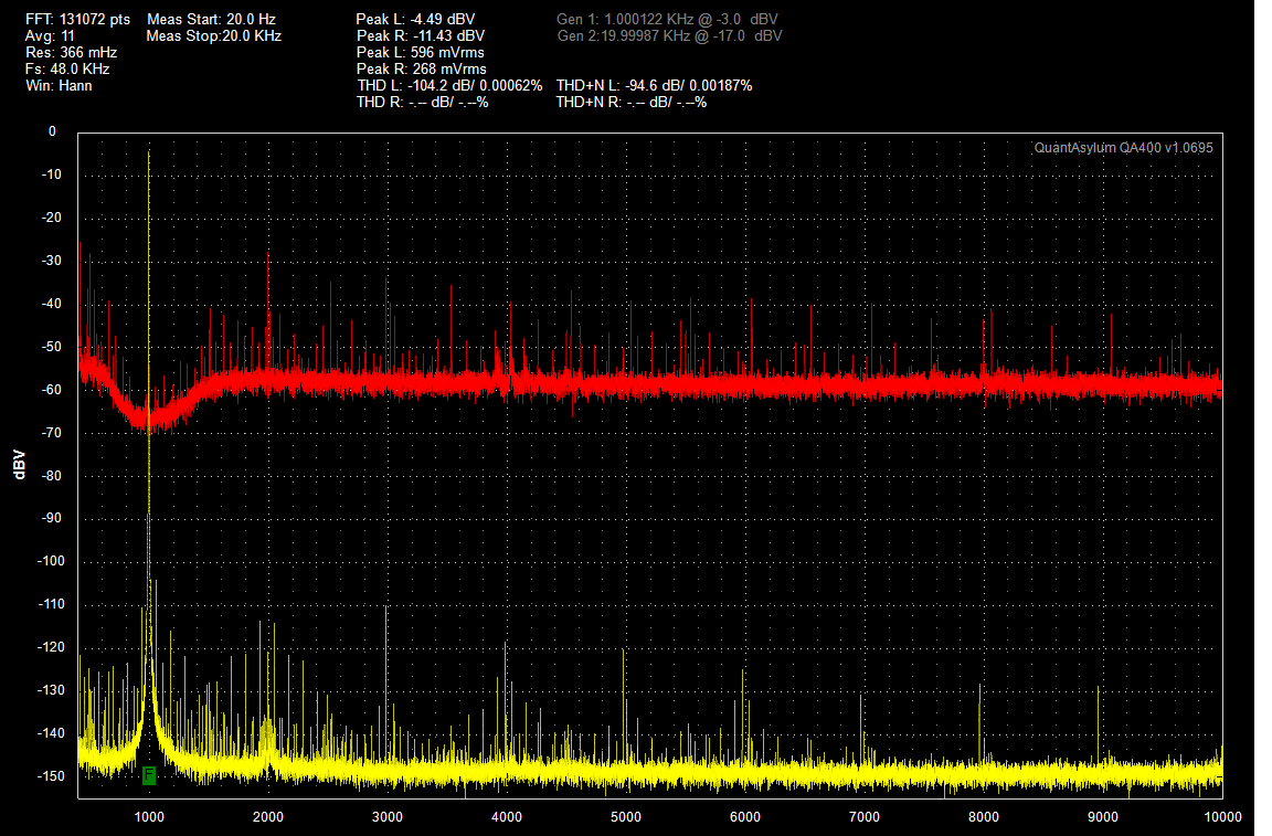

The spreading at the base of the fundamental is normal and an indication of several thing. First the Q of the oscillator, second the phase noise of the oscillator and third, the window function of the FFT. The internal oscillator won't show most of those because its synchronous with the sampling of the ADC.
The QA400 wants 1V RMS in which is at the bottom of the range for the oscillator. I think the oscillator works better at the top of its range. I use maximum resolution ad 48K on the QA400 when measuring with it. Its not adequate to measure the distortion of one of these oscillators directly.
Here is a shot I just took. The yellow is the QA400 fed from my Viktor 995 Hz oscillator at .7V RMS (full output through a -10 db 600 Ohm atteunator), the red is the distortion residual of the Shibasoku 725D of the same signal (they were connected in parallel). For the 725D 0dB is -100 dB so the -30 dB second harmonic is actually -130 dB. I hope this helps.

Yes, that definitely helps. When I received the oscillators from Viktor their pots were turned to max. I checked the Vrms of their output with a DMM first and dialed it down to a level the QA400 could handle. What you said makes sense, I'll try measuring the Viktors at different pot settings using the QA190 in between. I'll also look for your post on the LM317. Thank you.

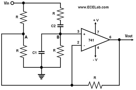

Tuning it may be a challenge with so many elements. I was looking at a bridge circuit that would also work (below, can not remember the name) as long as the source is relatively balanced. Otherwise the common mode of the opamp will be "stressed" if used as shown and probably limit its performance.

@Chris719 -- I don't know of a diff circuit, I'm basically a single-ended kind of guy. Common mode troubles with op amps make all sorts of horrible distortion, which is why Viktor used all ground referenced amps in his oscillator.
@Demian -- I'm going to have to simulate that variant of the Wien bridge to see what the equal R values force the system into -- my mental scope doesn't see what's going to happen.
In my fooling around with modding an HP 334 THD Analyzer's bridge amp, I just could not get the Wien bridge circuit to work without producing second H. spikes when the bridge fed a diff amp to sum a notch with feedback for higher Q.

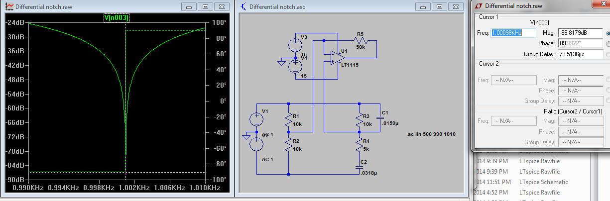

I had similar questions so here is a quick simulation. It actually works quite well. The simulation shows a 100 dB notch with no feedback. However if the signal is not perfectly balanced it seems to degrade. I'm sure there is something I overlooked. This is not a real test but shows it can work.
