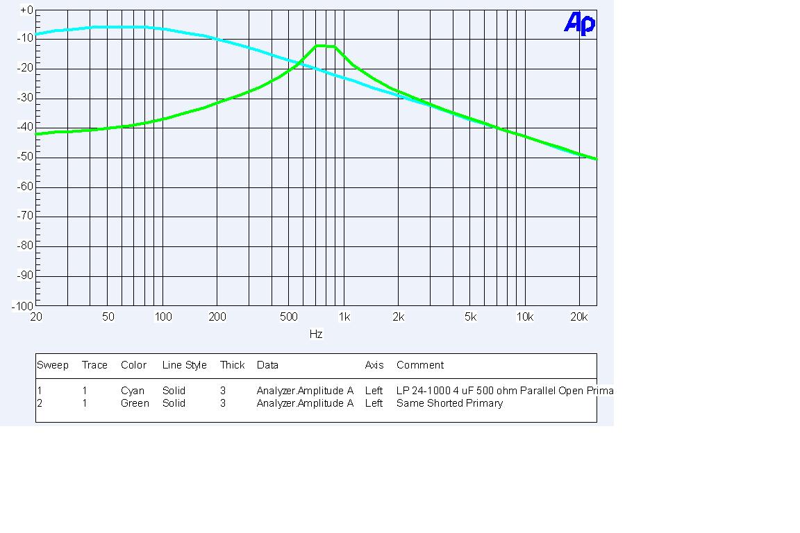

What do you use for stimulus when doing the transformer test to find C shunt?
I use a 1000 ohm resistor in series with the transformer secondary. It is shunted by a 500 ohm minimum load resistor. (Which has little effect other than to drop the test voltage.)

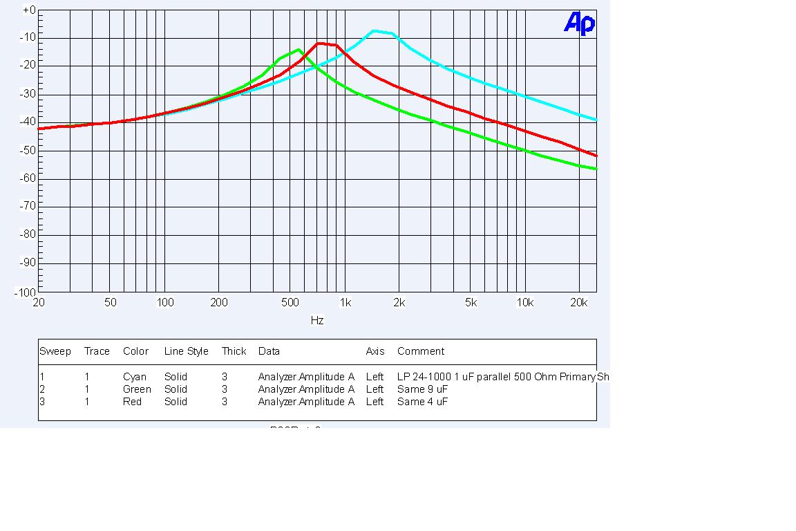

I have a capacitor box that switches in different capacitor values. The results are as shown. I source 1 volt and 0 db is 1 volt.
Now if somebody wants to tell me what I've really got here i am interested.
Did you short one primary together and short opposing secondary together, and then measure the resulting capacitance? What about putting the primaries and secondaries in series first, then doing the same measurement? You'll also want the secondary leakage inductance to help calculate the snubbers (you probably know this 🙂).

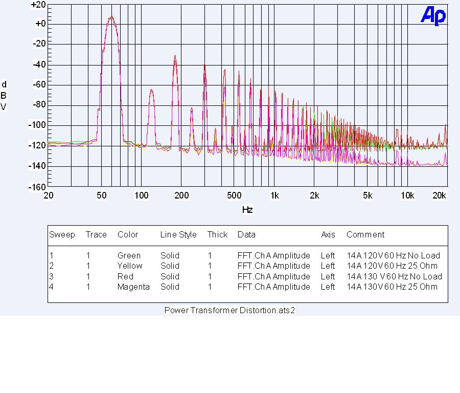

If I get a chance tomorrow I will post transformer distortion plots. They all distort!
All mains has lot's of H3 symmetrical distortion with a typical 'flat top', however I don't see this as a massive problem.
The biggest issue I have found is a transient-like energy spike on the returning
wave on transformer secondary. It seems this may be either running the core
'too hard', leakage inductance or a combination of both.

Attached is the distortion of a Signal Transformer EI core unit. The AC line source was my Audio Precision driving an Ashly Audio power amplifier. The input distortion level is below .5% as driven.

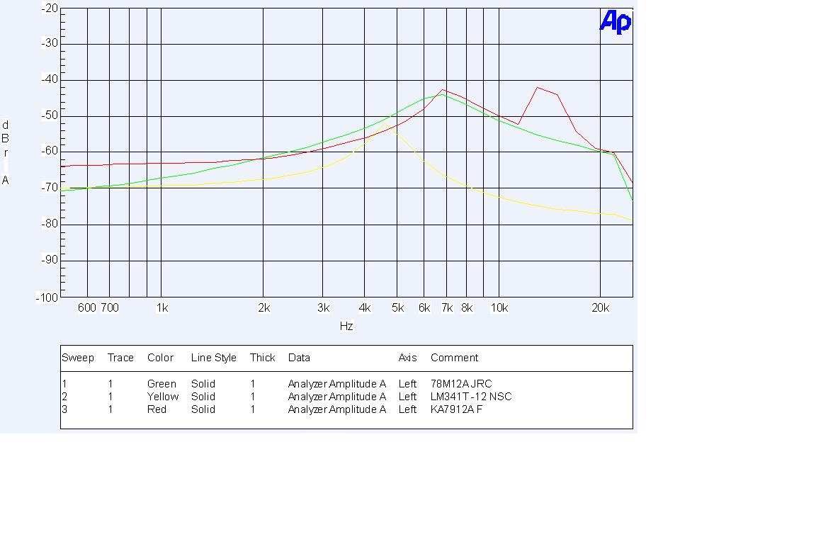

Now Power Supply Rejection Ratio is a different issue. For a simple opamp circuit the PSSR is almost always degraded by input impedance differences. Those differences degrade the Common Mode Rejection Ratio and that shows up as less PSSR.
Now using a simple regulator chip to clean up the power supply helps but the PSSR of the chips I have tested fall off at the frequencies where hearing is most critical.

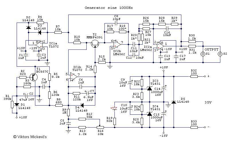

Isn't the volume control the AGC level set?
I have a schematic here but I'm not sure if this is Viktor's original or someone else's art.
An LC resonance.
