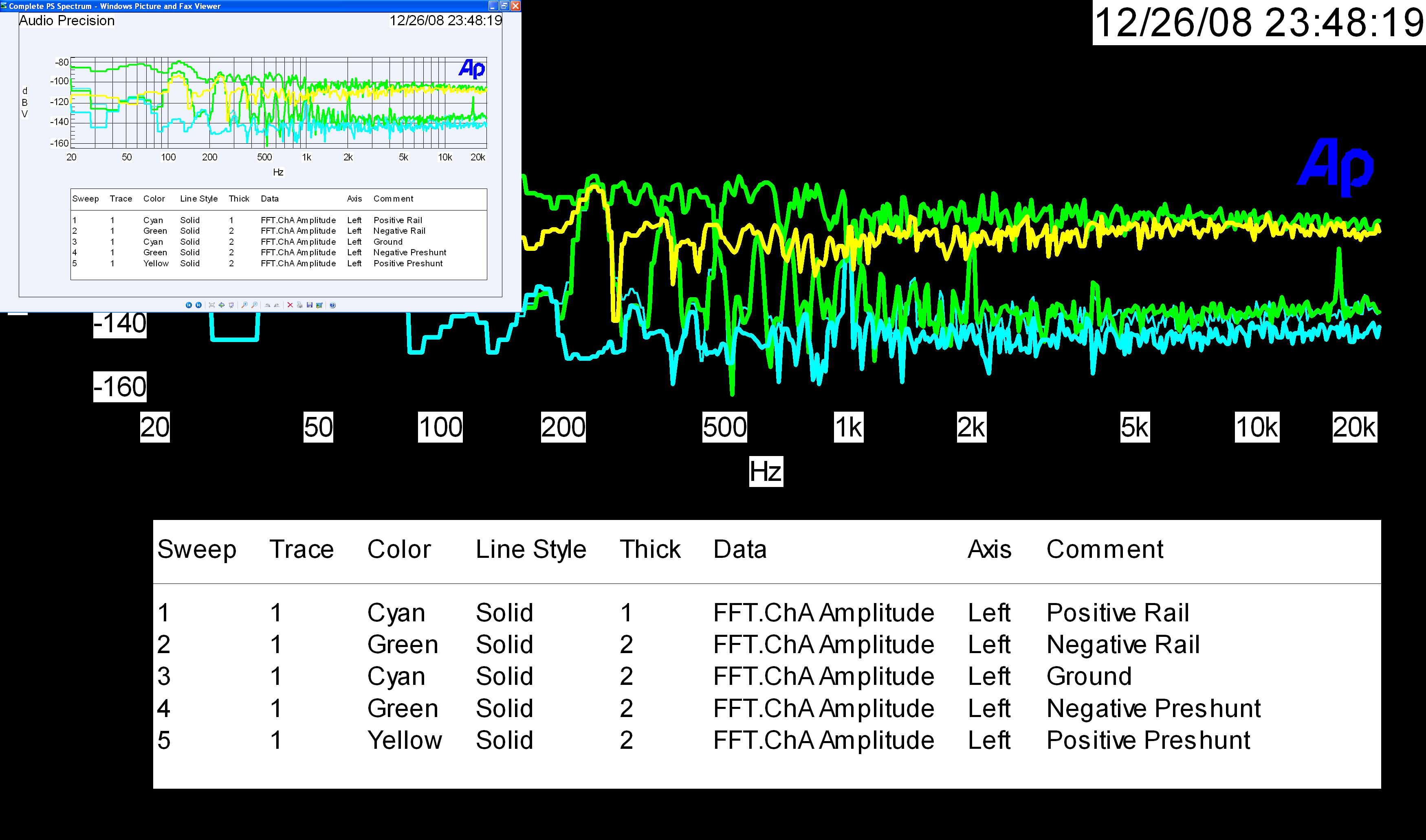

I've completed the modes on the supply. Schematic is shown below. These are the final values. Some measurements.
My Tek main frame has a vertical output. This output is connected to the input of a HP339A set to level mode. 1Vrms is input to the scope and the scope reads 1.414Vp to the best my eyes can see.
The 339A is set to relative adjust and adjusted to read 1Vrms (0dBV).
The 7A22 is set to 10uV/div at 29kHz bandwidth, 1Hz to 30kHz.
The reading on the 339a is at the bottom of the scale so I bumped the input range down -20dBV. With the 7A22 set to the 10uV range, the full scale on the 339A is -100dBV plus the -20dB for the input range adjustment. The total full scale is -120dBV
The positive regulator measures -5.6dBV and the negative reg measure -4dBV
That gives us -125.6 for the pos reg and -124dBV for the neg reg.
Both the positive and negative reg has settled to -126dBv.
With the probe shorted to ground the measurement system noise measures -126dBV.
If the system noise were subtracted from the measurement....

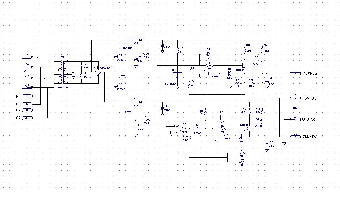

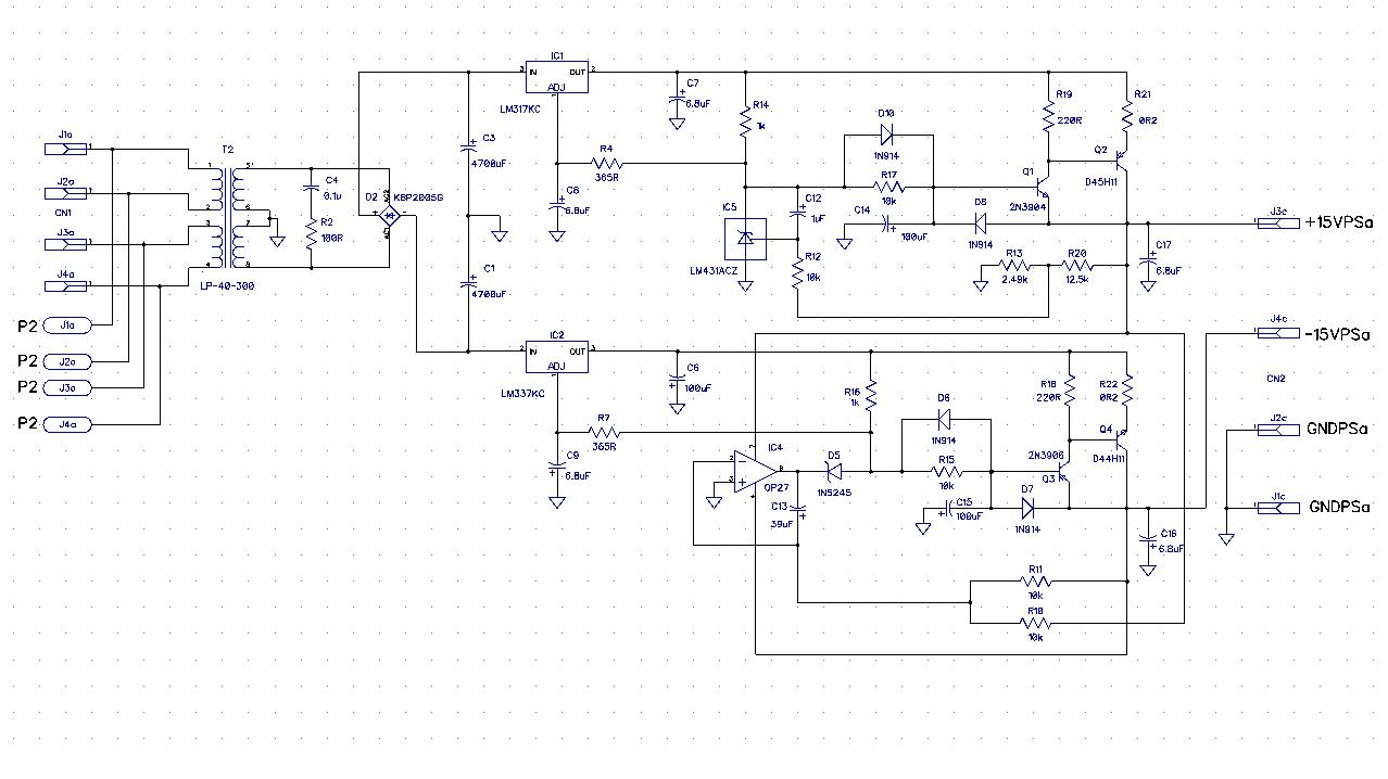

My biggest complaint is the way you have drawn R14. It has a dot to show where it is connected, but this is still very close to the way you show other lines crossing but not connected. if you moved the part one grid to the right it would be much harder to mistake that it is connected not jumping the line.
I suspect the power supply can be made at least 15 -20 db quieter!
You have a series RC across the power transformer. A parallel form works better. The capacitance should also rise to about 1-10 uf. The way I size the R is to load the transformer to 10% of capacity, that is where the magnetic coupling of the transformer is very dominant compared to the capacitive leakage. The the capacitor value is chosen to minimize transformer resonance on the secondary with the primary shorted.
I also place small capacitors across the diode bride. For a cheap diode bridge 220 pf is a good choice. For a low switching noise bridge, 47 pf. This will pass more line noise than the diodes by themselves but will eliminate switching spikes at 500 - 1000 khz.
The next improvement would be to use two bridges and not connect the transformer center tap to ground. By creating the ground or common after the diode bridge and filter capacitors you get 20 db less RF leakage to the ground. ( A transformer does pass line noise, a diode when not conducting power does not!) Better still with the two bridges is to wire one of them out of phase with the other. That way any common mode line noise becomes differential and can be cancelled. Of course a good RF shut on the output of each bridge is useful. I would use an NPO (also called COG) ceramic capacitor of 100 pF here.
I would also use 5 x 1000 uf filter capacitors rather than a single 4700 uf. Even better would be 2000 uf 1R 2000 uf 1R 1000 uf.
Now when you look at the output spectrum if you see power line harmonics the structure is important. If you see even and odd order harmonics that is actually OK. If you see just odds or they are dominant it means either your transformer is not properly shielded or your grounding scheme isn't working. If you see dominant evens that is from radiated energy and can often be cleaned up by a well placed capacitor. If you don't see any harmonics, you are just not looking closely enough.
Now if you want to really go to extremes use a thermo-electric cooler on the output driver transistor!

Thanks Ed. I'll take all this into consideration. I'm out of board real estate as it but I can make the board bigger if necessary. Question is does it need to perform better than it is. I was originally using two bridges but the board was getting tight for space and they charge by the square inch.
I'll fix the hard read in the schematic.

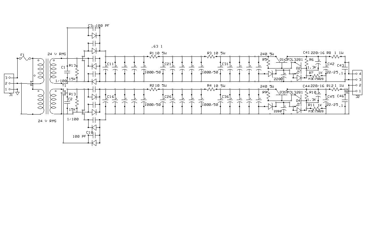

I would not connect a transformer center tap to the ground. Two bridges are a big improvement. If you don't want that use two inverse parallel connected diodes in the ground lead. The diodes only conduct when current flows, so you get as much as 10 db lower line noise!
When you say two bridges, do you mean one per secondary, thus eliminating the center-tap? Have an example circuit handy or a quick sketch?
Here
Don't know how the second image got screwed up, but you get the idea.
I have room on the board for two bridges. It's a small change to the layout. The RF filter components are small enough and easily fit. But I don't have room for RC mains filtering unless I enlarge the board. Peltier cooler might be a bit extreme.
These transformers put out about a 5% clipped sine which might complicate the spectrum analysis you described.
"The diodes only conduct when current flows, so you get as much as 10 db lower line noise"
Then the ground is floating most of the time. Interesting.
Yes it means this. One bridge for each winding. JC goes as far as not connecting a common point until the output. Two separate power supplies +/-.
