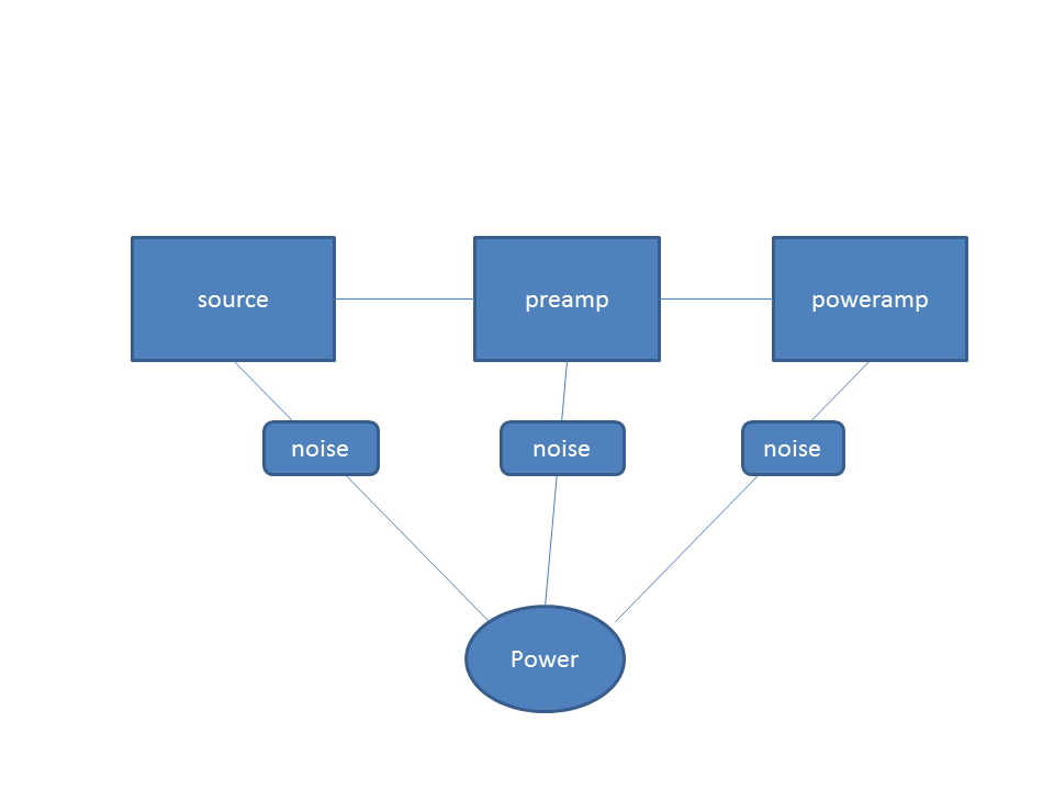

To understand the problem draw a system with a single conductor between each chassis and between each chassis and a common point(the power source). Each box and the power source is capable of generating noise between its chassis and the power connection. The connections between the chassis are the audio/digital links. The more pieces the more complex this mess gets. The noise energy in the power will get conducted through the chassis even if the coupling has a very high impedance. And its a matrix with the energy going everywhere. Unless you can shunt the noise around the sensitive circuitry it will get into it.
The noise source can be modeled as a voltage with a high series impedance. That's why adding a ferrite that may be 300-400 Ohms at 10 MHz won't have a big effect.

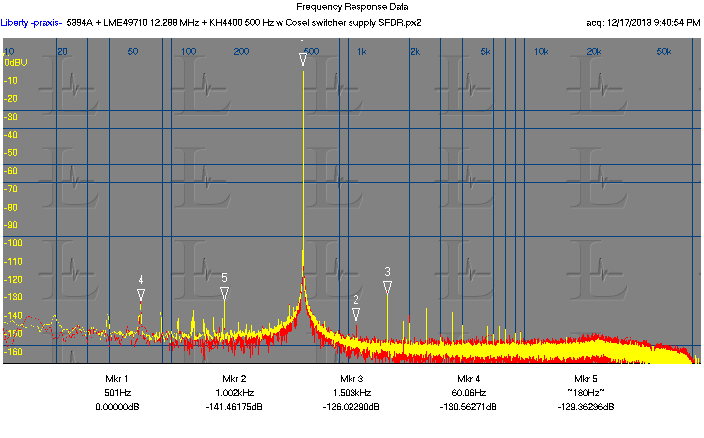

The distortion plot shows the difference between a good switching power supply module (Cosel) and a cheap crude linear supply (Jameco JE215: JAMECO KITPRO: Education & Hobby Kits) powering an ADC demo board. There are no onboard regulators for the analog opamps. Even with 200 mV of ripple on the analog supply you don't get more than -130 dB (ref 2V) in the output. I think this underscores how effective the power supply rejection is on decent opamps. Setting up a really clean linear supply did not make a difference. Connecting the chassis together (generator and ADC) in the wrong place makes a mess of it.
