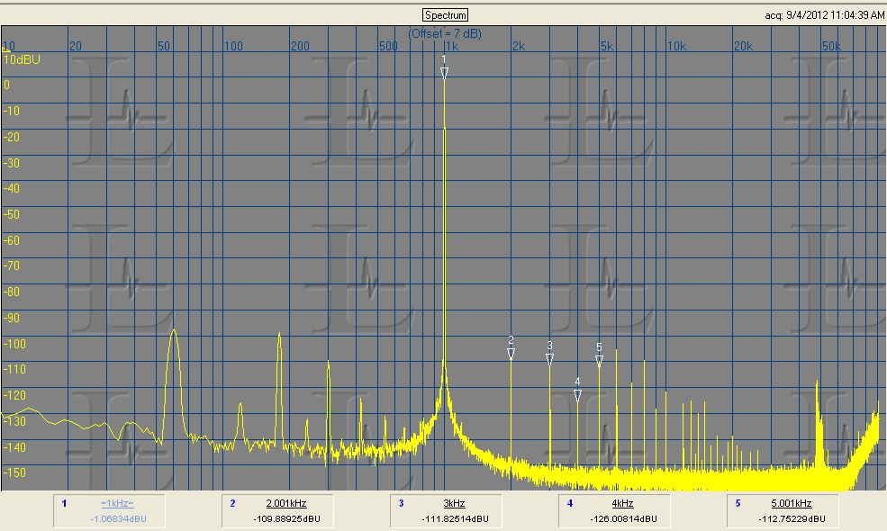

This is a quick capture of the distortion spectra (of the ADC, the source is significantly better) of a 1 KHz low distortion source. The ADC is an AKM AK5394A, which is a reasonable choice and used in some current mid priced products. Adding a twin T would get better resolution on the distortion if you are really concerned about distortions below 120 dB. (The opamps on the ADC board are JRC 5534's, I have not tried others yet.)
Getting this performance from an internal card would be difficult but possible, however an external ADC will give better results usually.

The 60 Hz was lazy setup on my part. I usually run a separate ground wire between the chassis and the demo board, but not this time.
I am not sure what uses this chip today. I believe its used in several pro ADC's and it might be in some of the better mid level ADC's.
I'm using the AKM demo board but laying out a board for it is not too difficult. If I weren't so busy I would do it. I may be able to get someone to attempt it. The chip is $22 for one at Digikey.

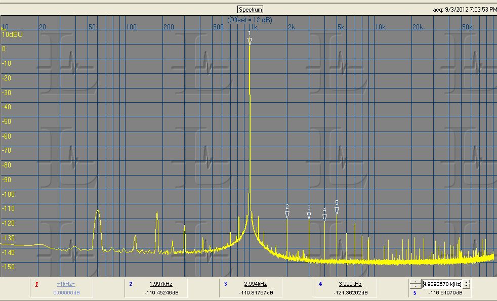

I cleaned up the connections and improved the grounding but the hum remains. It may be a limitation of the Heathkit bench supply I am using. It is -120 dB. . .
Warm up got the harmonics down some (who says warm up is a myth?).

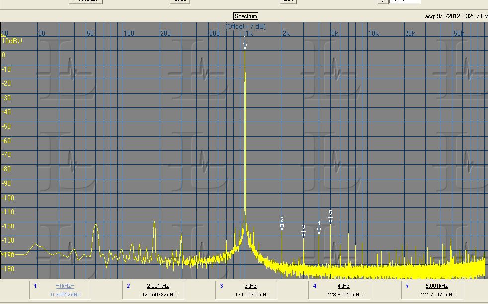

Here is the same source measured with the PCM4222 EVM. I did not get the same results or even nearly so as the linked test. Distortion products are higher. Key difference- I am sampling at 192 KHz. Changing the sample rate is a real PITA on these. I had to get the local FAE to get the board running and he had to call several people at TI for guidance.
It also shows me that I have some jitter in the on board clocking on the AKM board (its not well done and I should completely reconstruct it).
The noise above the oscillator frequency is lower than the noise below (??). The noise shaping start up at 50 KHz on this chip. I'll leave it running and recheck the distortion in a few hours to see if its better. I also need a better power supply for these guys.

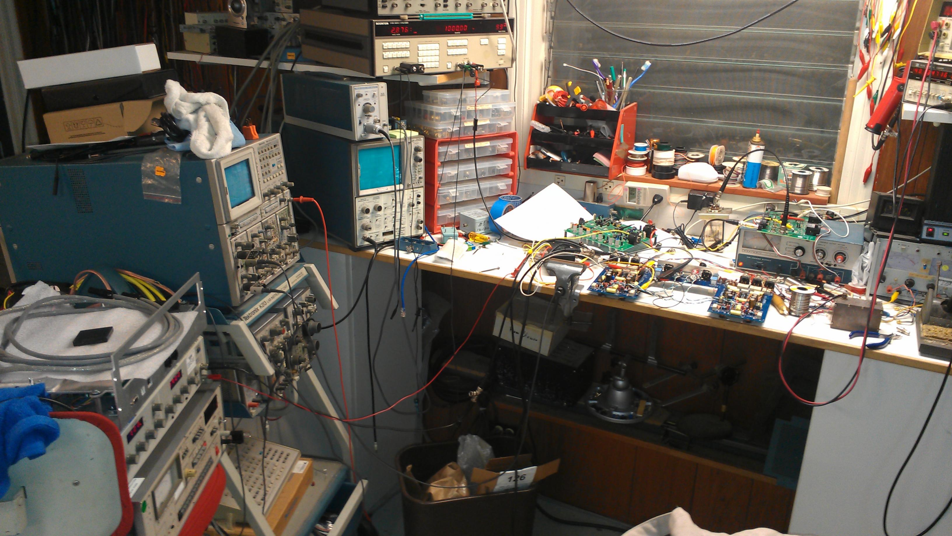

RFI Shielding?
Not really. The generator is in the stack on the left under the aluminium chassis and the ADC is on the right on top of the Heathkit supply connected through 8 feet of coax. Its identical to the setup used with the AKM demo board. Neither are particularly good.
The big board in front is what I should be working on. . .
