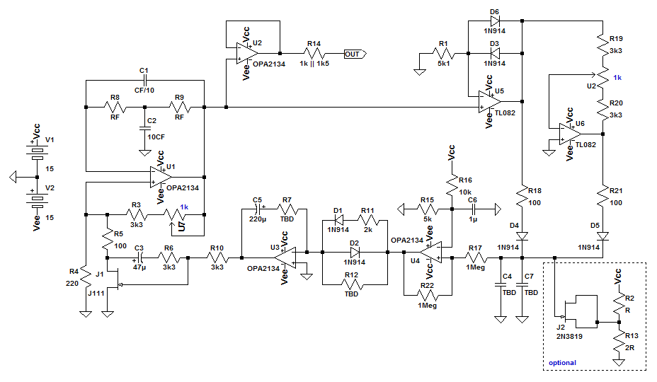

Update on the Victor oscillator- Running overnight the distortion seems to have dropped. The second harmonic is now almost -140 dB. the higher are still lower in level at around -150 dB. I'll try to check the calibration at these low levels to make sure there is no nonlinearity affecting the readings. The Shibasoku AG16 is a little better but not much better. Essentially these are "perfect" oscillators for virtually any application.
The second harmonic is now almost -140 dB. The higher are still lower in level at around -150 dB.
How come that you can measure -140 and even -150 dB with any certainity? This would mean that the notch filter you're using has -160 dB or less distortion contribution--a quite unrealistic assumption...

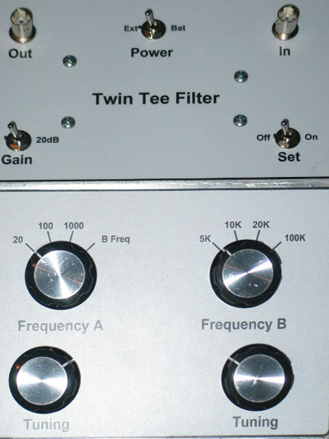

To turn off all but the bottom tracks in Eagle, click on the display icon in the left toolbar, the multicolored button under the one that looks like an i. Click on none, then click on 16,17,18 and then OK. Should see only the bottom layer.
I am using 20,100,1K,5K,10K,20K and 100K in my filter on two Alpha double deck 3-pole 4-position switches from Mouser.
Samuel
To bracket a min/max error you would have to rule out fortuitous cancellation, but in this case I don't see the need for certainty just a max limit. Yes you would be hard pressed to make a passive notch (let alone an active one) that would tell you if it was -145dB vs -148dB.

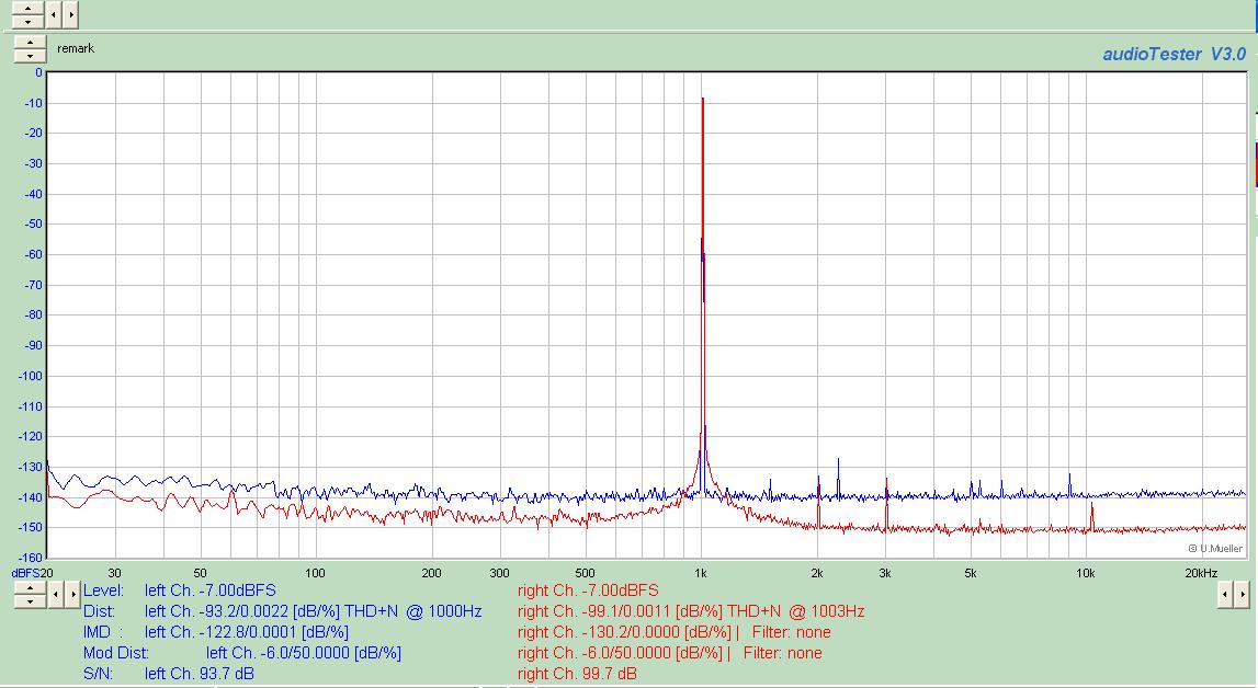

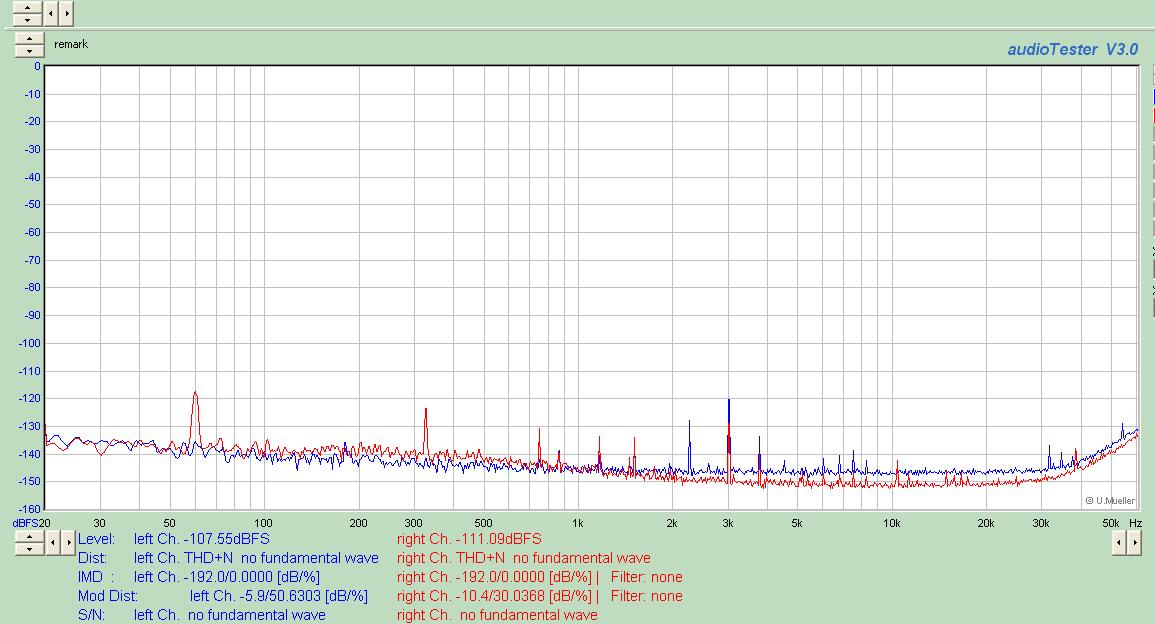

My 1KHz version came in yesterday so I ran a couple plots on my system using a Audiophile M192 in loop-back and with the oscillator for comparison.
The Oscillator is not in a chassis yet, so hopefully that will explain some of the noise.
Cables are RG174U for each signal in diff mode (8 coax total). The unused input signal on the rt channel is grounded at the oscillator.
The highest level I could get out of the M192 is -7dBfs ref 2.828V, so I adjusted the oscillator to the same level.
First plot is L- M-Audio, R - Oscillator both at -7Dbfs
Second plot is with the output of the M192 off and the Oscillator un-powered.
The 3KHz spike is from some unknown source. I tried setting the M-192 to 10KHz and the spike remained at 3KHz.
Wow. You clearly subscribe to the beyond-audibility-is-important camp! Hmmm, is there a below-audibility-is-important-too camp?

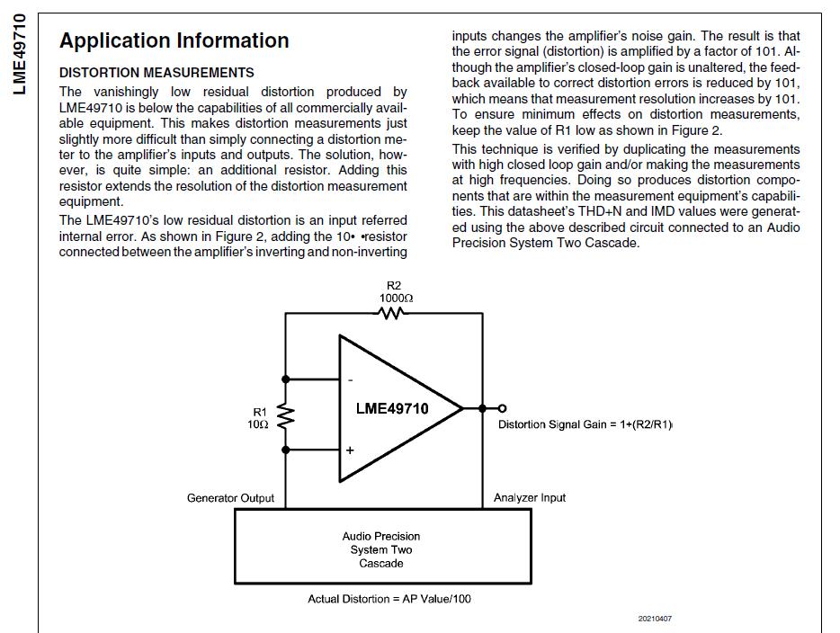

Has anyone tried this technique for measuring distortion on differential input amplifiers? I don't know if it could be used for other kinds of amps. Substitute our low distortion oscillator for the source and a super nice ADC/computer for the analyzer input.

Pease wrote a related app note too, but this technique is pretty old. You can also obviate somewhat the need for a super oscillator.

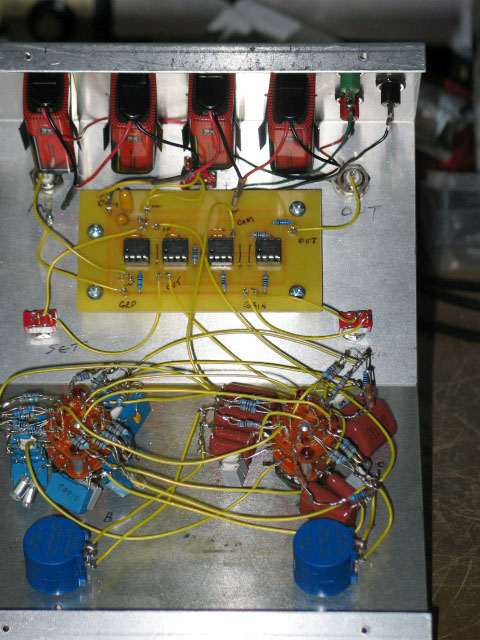

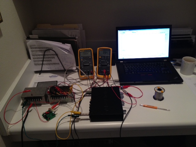

Here is a couple of pix

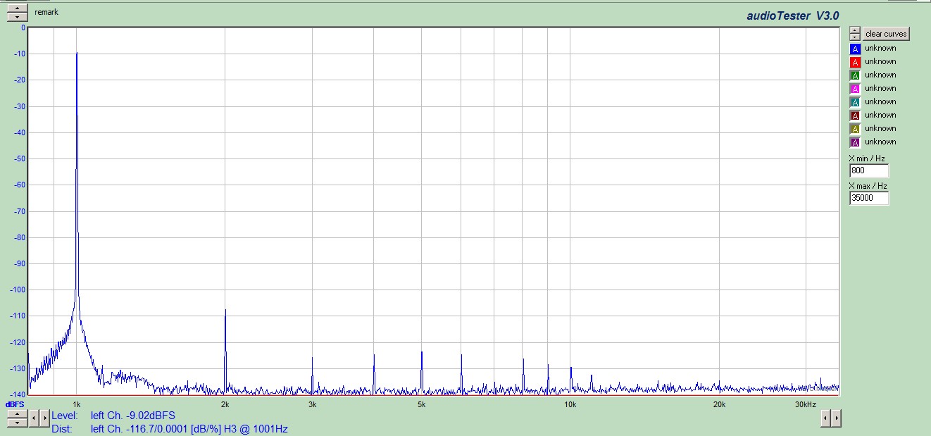

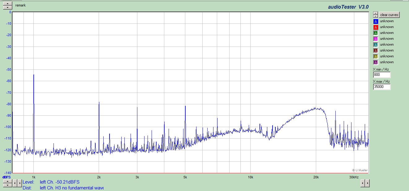

So I received Victors’ 1 kHz oscillator yesterday, and completed a first round of testing. I also built a twin-t notch filter in a separate box, to test out the real distortion of this and other sources. It is a passive design on the front end followed by a fixed gain amplifier of 100 (+40dB).
I have performed no real calibrations or loopbacks; this is just to see if things are functional or not. I have good confidence in my M-Audio Profire 610 (other than Win7 frustration) so cursory results are very encouraging.
As far as the oscillator, I built my own 35V non-regulated outboard power supply, which was actually putting out closer to 37V at 35mA. This caused the oscillator’s local power supply to run a little too warm for my comfort; you could really see drift of circuit performance as the entire pcb warmed up. The TL431’s were running around 55-60C absolute. So a 100 ohm resistor in series was sufficient to bring voltage down to 34.7V, where the shunt power supply was much more happy and cooler.
Frequency of oscillation was 1001.2 Hz, well within specifications. Ideally let the assembly run for 15-20 minutes before doing any serious measurements. Gain control appears very decent- I had the Fluke 87 bouncing +/-1mV, but that could just be the meter itself. It doesn’t appear to have a significant effect on distortion results, anyway.
Now that I knew the oscillator’s frequency, I could custom tailor my notch filter specifically to that frequency, getting maximum performance. Happy to report, that worked out really well- I was able to get a -82dB notch, which followed by the +40dB fixed gain amplifier resulted in total fundamental attenuation of -42dB. Now I had a low fundamental, which would not (probably) add any distortion products on the soundcard’s FFT results. Any distortion I see would now be from the oscillator and notch filter. Although the notch tends to drift a little with time, all I was interested in was getting it low enough to not be an issue with the soundcard; I believe I have accomplished that.
So by the numbers, my low-Q notch filter performs as follows:
2nd: +30.9 dB
3rd: +34.9
4th: +36.7
5th: +37.7
6th: +38.3
7th: +38.7
8th: +39.0
9th: +39.2

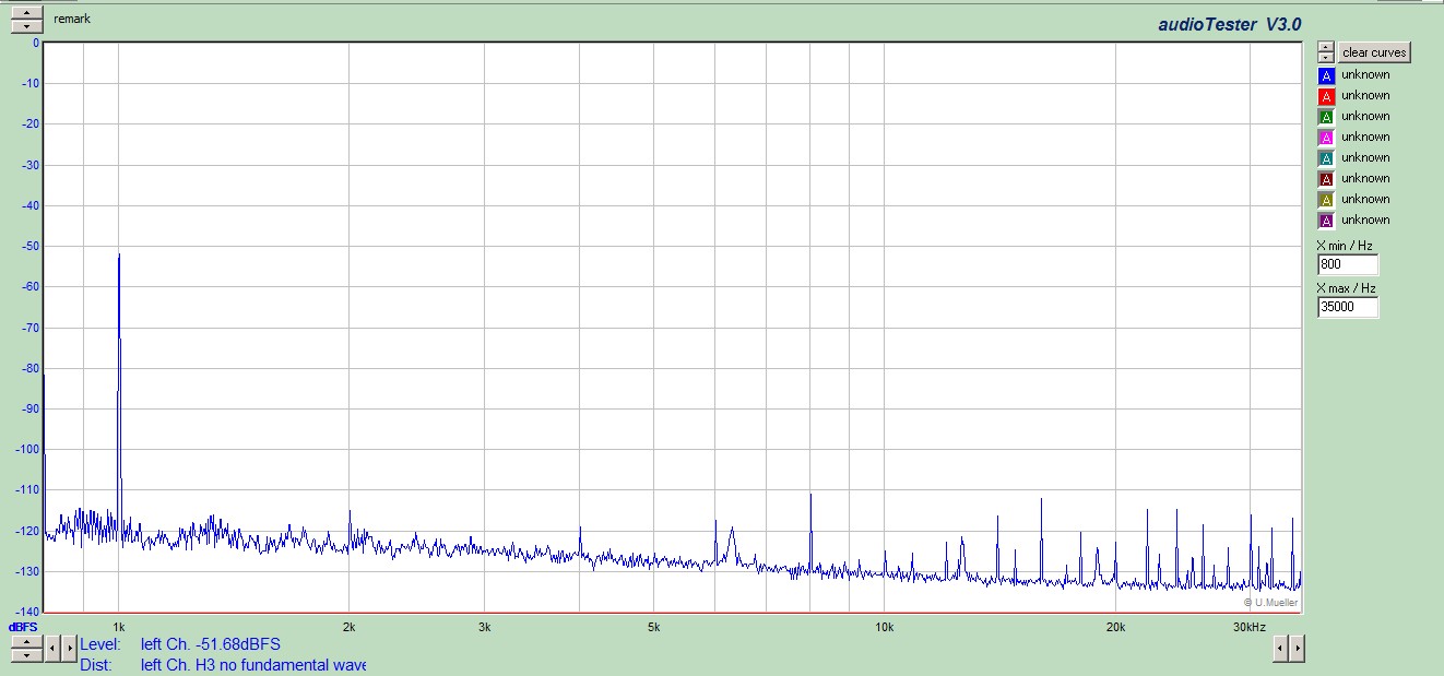

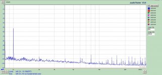

I set the oscillator for around 2V rms output (-9dBFS) and began measurements. Keep in mind, this is a mess of wiring at present; I have attached a picture showing the spaghetti setup, so you understand that a little noise here and there is expected. Pre-notch into the soundcard and post-notch into the soundcard attached. My observation:
2nd harmonic (which has been boosted by 30.9 dB by the notch filter) is actually at -137 dB below the fundamental.
3rd unmeasureable.
4th at -147 below fundamental.
5th at -inf.
6th at -145.
7th at -inf.
8th at -141.
THD therefore 0.000018%
The pre-notch capture indicates to me that in the presence of a strong fundamental, the soundcard does in fact distort, resulting in erroneous measurements of harmonics. So a notch filter is absolutely required in order to test the distortion of Victor’s oscillator, and for the price, that’s a darn nice oscillator.
Your thoughts?
