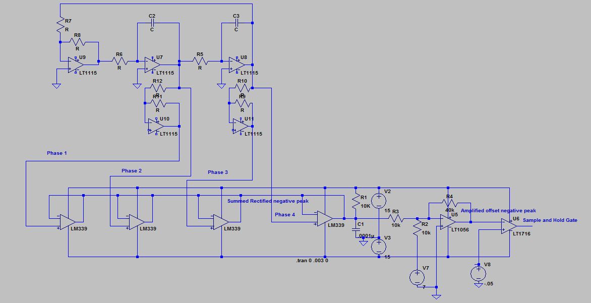

Fast settling oscillator
Here is the unfinished design for the fast settling state variable oscillator. It borrows the additional peak detecting ideas from Cordell's oscillator, adding more and uses a trick I have used making an LM339 work as a peak detector.
The LM339 is a fast comparator but internally its like an unfinished opamp with open collector outputs. It has the virtue of not going nuts when the output is in an odd state. By feeding back the output to the input as shown it works as a "perfect" rectifier. Being open collector we can wire or several outputs together as shown.
The next stage is borrowed from the Fluke 510A oscillator which is designed to have extremely stable output. The DC offset from R2 moves the peak negative voltage to 0V at the output of U5. U6 is a comparator that switches to turn on the sample and hold at the peak voltage. This is modeled in the LM339 rectifier sim attached.
I have not added a sample and hold (did not see one in the library) or the AGC. I think Victors AGC would be well suited to this.
Also not done are the frequency tuning, the startup circuit or some of the other details. I found Victors modules and did not need to finish it.
