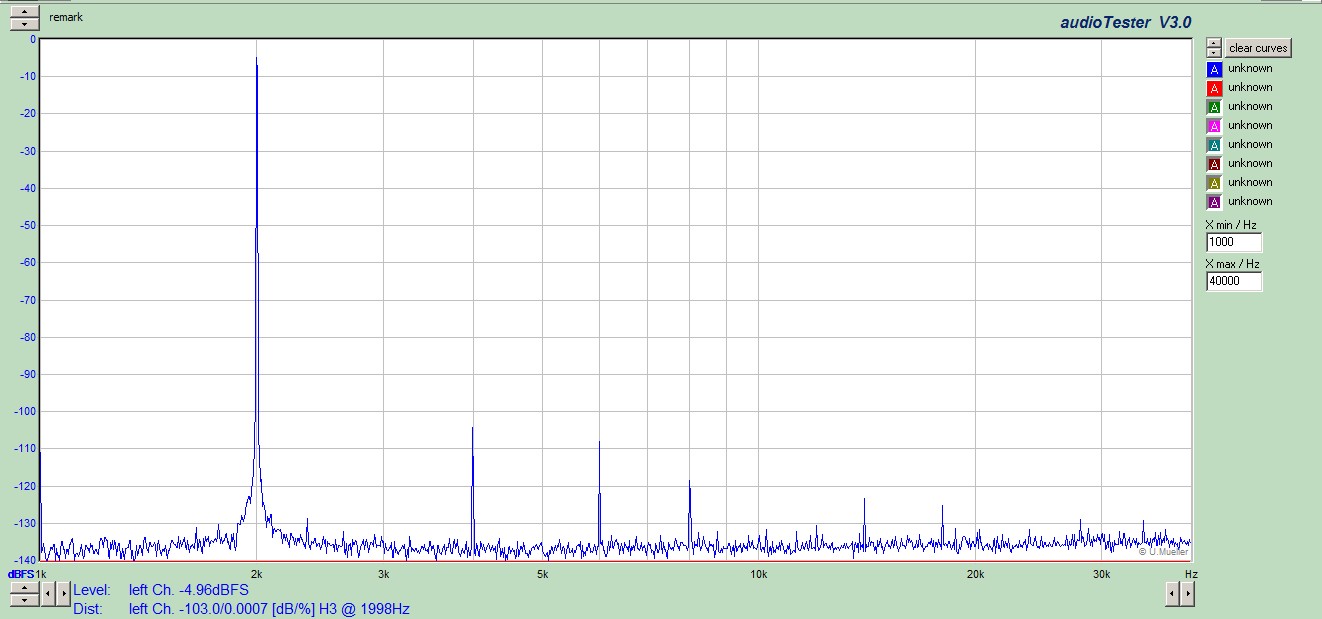

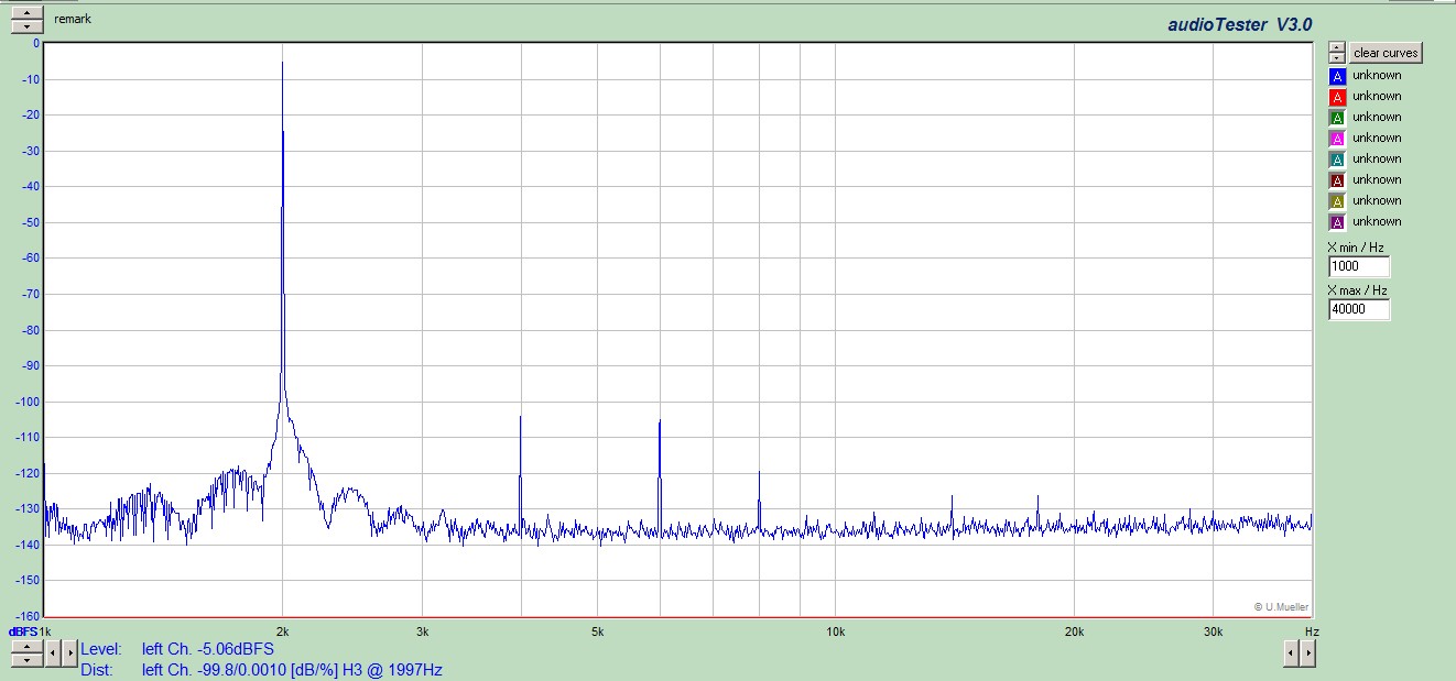

Did make some progress: the sidebands are due to distortion from too high an output level. At the time I was testing this earlier, I only checked the amplitude modulation with output level, which had no effect. Once I bring the output down to 3Vrms, I get much better results as you can see.
Annoying is the fact the amplitude modulation is still occurring, at +/- 12mV. Maybe this is the best I can expect, not sure. I have run the LED current from 6 mA (too low to control startup) to 15 mA (too high to control startup). In between works well, with 12mA settling quicker than 8mA. But each has almost identical modulation of amplitude.

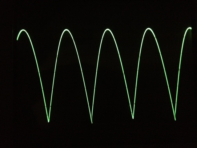

Pics also included of the sine output and output of the FW rectifier. Note the 2nd harmonic present at the output of the FW rectifier; every other valley is at alternating DC levels.

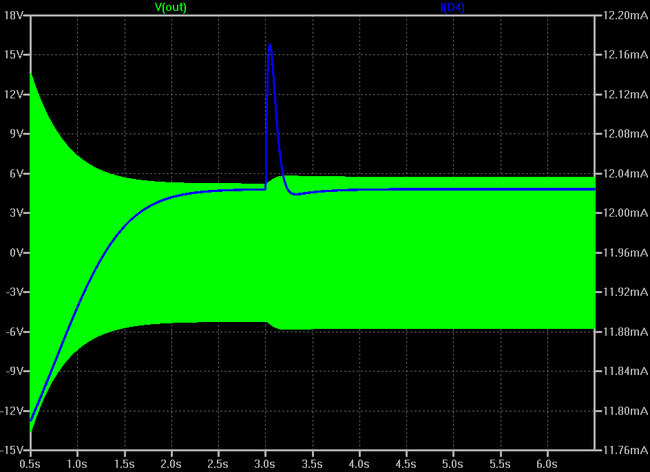

I tried simulating the circuit and it seems it is really very picky in the AGC behaviour. The LDR coupler was modelled with a controlled resistor, running along an 1/Iset curve around 80Ohms @ 10mA which matched the published number and graphs quite well (but not the response time). I used a Zener to clamp the top integrator output because of ideal opamps used. Startup is triggered by injecting one single period of the osc. freq. at the beginning. Find LTspice simulation file attached (rename to .asc).
The noted asymetric behaviour of the rectifier is confirmed in the sim, too (depends on the diode load resistor and the comp cap).
I finally managed to get to a stable operating point, playing with the series and parallel resistor around the LDR.
Injecting a step at the AGC reference, as per Samuels suggestion, shows a quite well damped response. See screenshot.
But whenever missing the correct parameter range even by a slight amount the osc either died or showed some sort of "gain hiccuping" with 1s order of magnitude period times, just what ZigZag is seeing.
I would think the circuit is very sensitive and might easily be working "just on the edge" where small amounts of noise and other disturbances or drifts could upset stability.

It might be possible to clean up the full wave rectifier output a little.
I have built some full wave rectifiers myself a long time ago and found that 'Applications of Operational Amplifiers' by Jerald G. Graeme helpful. I think that the alternating DC values are due to the offset voltage of the first operational amplifier stage TL082D. The switching around 0 V is also affected by the slew rate and high frequency small signal gain of the TL082. So a lower offset, higher bandwidth, greater slew rate operaational amplifier should help. It might also be worth using schottky diodes for their lower forward voltage but with the disadvantage of higher capacitance and leakage.

Good call. Increased R18 from 15 to 22, to 47, and finally 63. Improvement each time with gain control. Now getting about +/- 0.5mV of wobble, and its pretty consistent and doesn't get out of control. Also notice that stability is best when the current through the LED is low, around 4-5 mA. May not be best for linearity, as I can see my 3rd harmonic is a little higher, but we are stable. Starts up and settles very quickly, too.
The cap at transistor base was about the same when increased by 10uF, but got unstable with an extra 22uF.
At this point I have determined that my simple D/A through transformer works better. If (and that's a big if) the author really did get distortion measurements that low, the design is way too marginal and sensitive to luck that it's not worth pursuing anymore.
