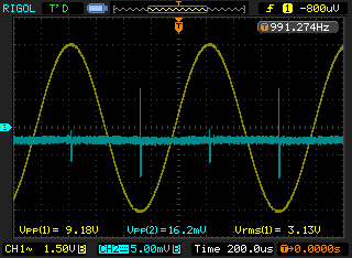

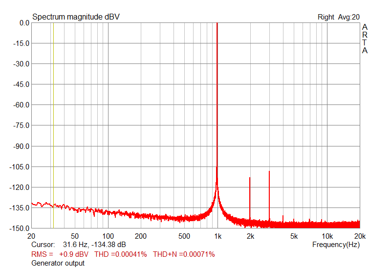

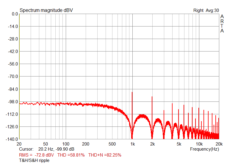

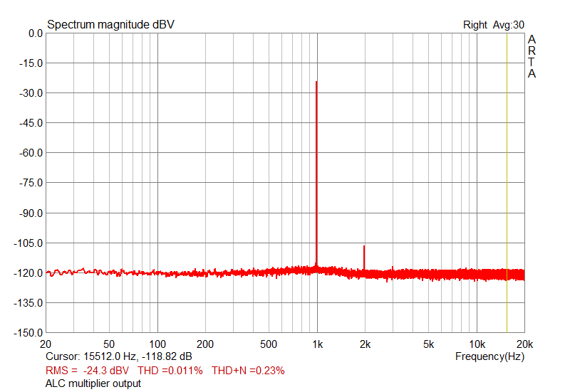

I've attached difference amplifier output as it appears both on the scope and in the spectrum analyzer; the 3rd graph shows ALC multiplier output, while the last one is the generator output itself scaled down to 1Vrms or so. I think T&H/S&H output ripple can be further reduced by replacing the first T&H with a true peak detector with reset, and maybe optimizing somewhat the layout (although I'm already employing local regulators and careful decoupling for both the ring itself and the peak detector), but what does actually matter is the analog multipler output signal, and it is quite clean, as you can see. This generator is based on a ring of 318s and a single AD633 in the ALC loop working at a decoupling factor of about 21, or 26.5dB; its unloaded output level is about 9.1Vpp - the operating Q @ 1kHz is slightly more than 60dB, and it runs smoothly from 10Hz to 150kHz (although its Q lowers quite a bit at high frequencies). It's a little bit noisier than the version with 2 AD633 and a 4-phase rectifier, but 318s are noisier than 5534s; anyway it seems to have quite a bit lower THD - something in the -130dBc range @1kHz, but I still have to check thoroughly these preliminary results - I know they are a little bit impressive...

I did try the same sin^2+cos^2 peak detector approach, but it turned out to have too high a ripple to keep THD low without heavy filtering and very slow response. Besides this, my only APF test generator was a slightly modified version of the one cited in the first post, but after having had a look at your work I've decided to try a version with a much better ALC loop to see what comes out - I'll let you know.

As far as I know they are the lowest cost monolithic S&H in the market; and they do work pretty well indeed, but they do not seem to suit the needs of this specific application. Boonton generators employed a HAI-5320 by Harris (a fast precision integrating S&H) and a SMP-11 by AD (a diode-bridge S&H with very low droop rate), but I've not managed to find both the first and the last - don't even know if they are still in prduction (although HAI-5239 DS is dated March 2012...).

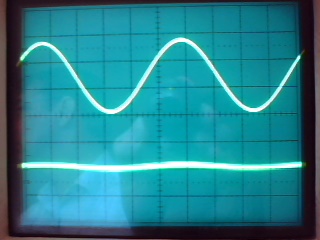

Top trace: Oscillator output at 5 V / div
Bottom trace: Sample and Hold capacitor C52 (increased to 10 nF) 5 mV / div
Hi PChi, your S&H output seems very clean indeed (although a spectral analysis could reveal quite a bit of HF content), but it's a little bit higher than optimal, too - it's likely to significantly raise the 2nd harmonic level in output signal. What's the signal level at the multplier output?

Thanks for the comments. The sample and hold output is clean because the low charge injection analogue switch, the Analog Devices ADG1221, is good though the 10 pin Mini Small Outline Package with a 0.5 mm pin pitch is a challenge to hand solder.
