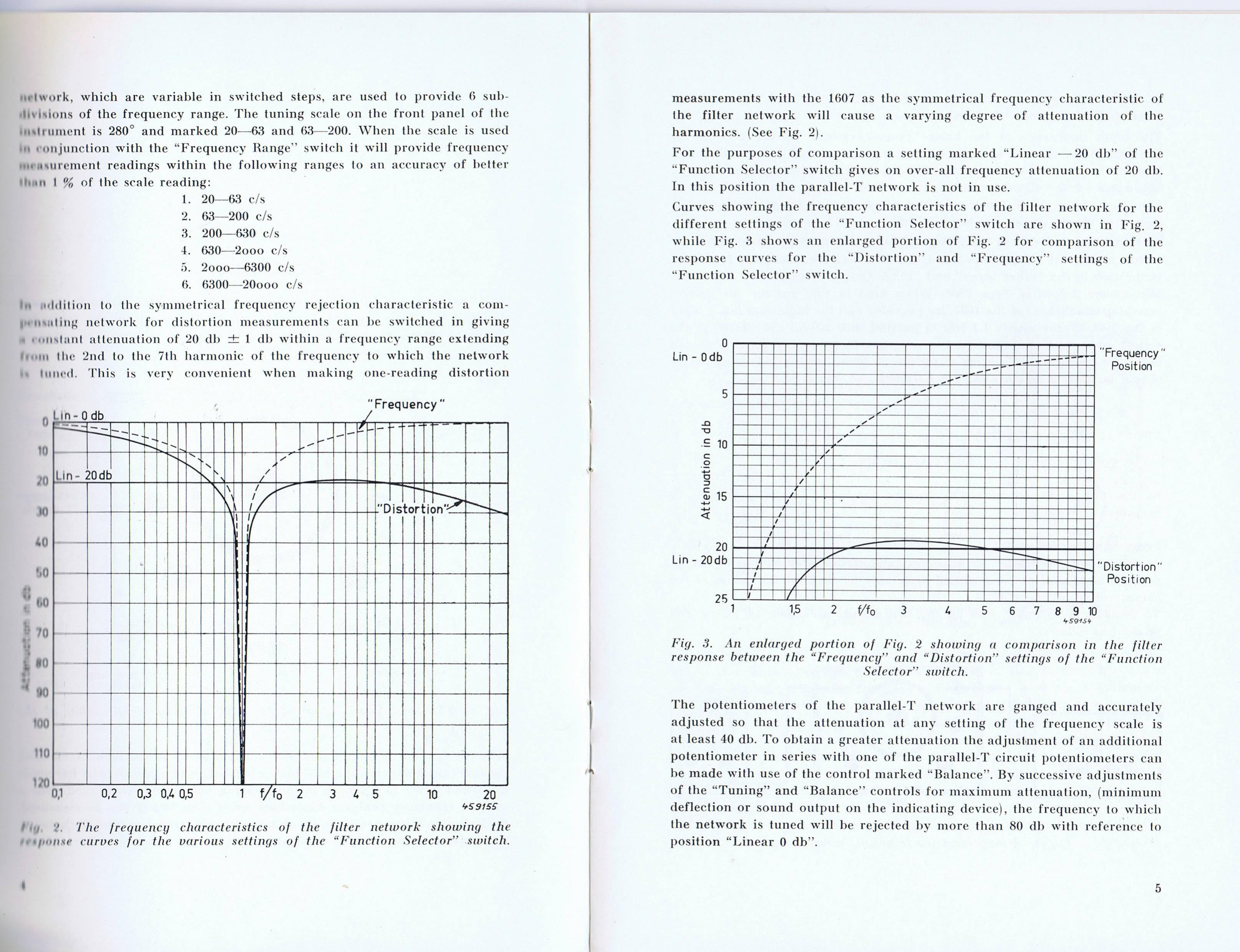

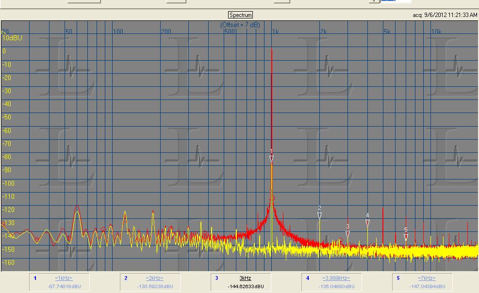

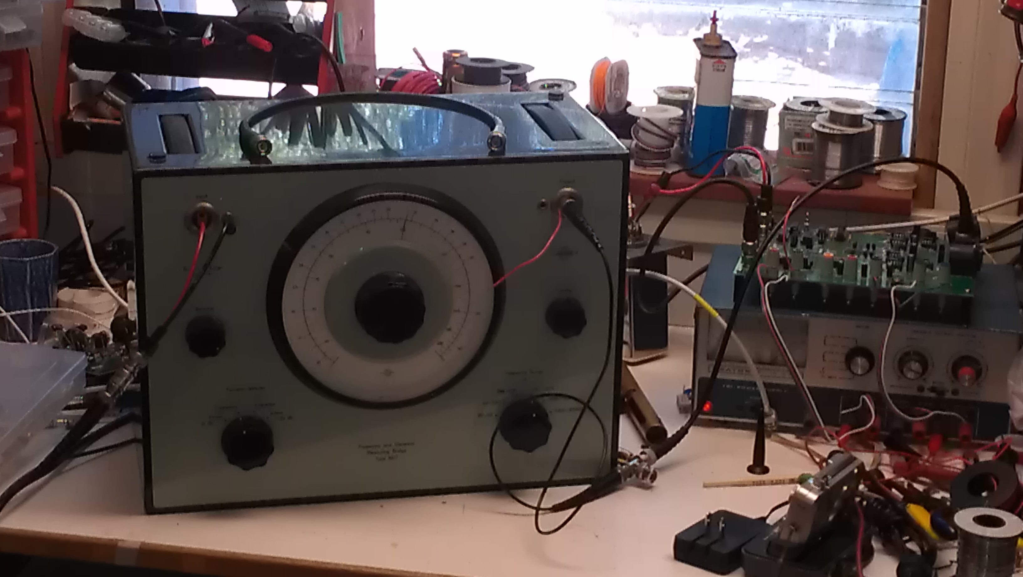

I finally dug this rare (and important antique) out of storage and checked to see if it would work. it does and it gives some verification of the performance of the oscillator.
The spectrum shows the un-notched as the red trace and the notched as the yellow. Also is a picture of it in use (not the best lab technique) and a page from the manual showing its notch characteristics. The manual does not have the circuit (a first for B&K manuals of that vintage) so I may need to reverse engineer it. Also a clean mod to work around the B&K connectors is on my to-do list.

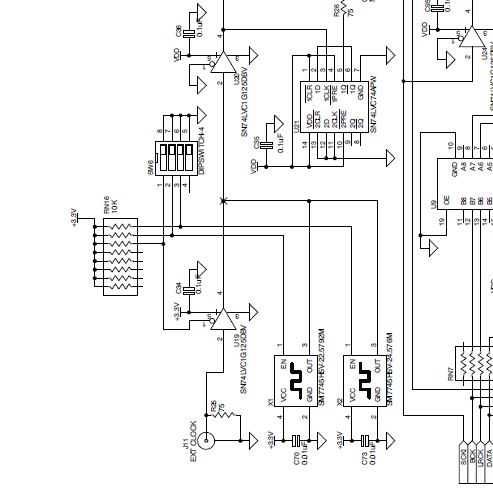

For lower jitter i'd guess 🙂 Or for syncing-up the whole system from single clock source (useful in multiple ADC configurations - for multichannel recording etc).
Low jitter is the primary issue. The TI board is pretty good while the AKM is a demonstration of why you don't want an inverter crystal oscillator. I am using an external OXCO (it draws as much as 12W) to get a low jitter clock. Its possible to get similar performance from the Crystek oscillators, but you do need to clean up the power supply.
I'm up for modifying the TI board if someone can show me what needs to be replaced.

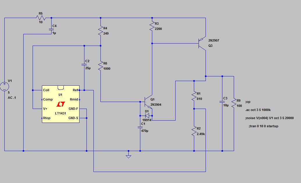

The TI board has two crystal oscillators with about the same foot print as the Crystek oscillators. They are on the attached schematic. You do need to improve the power supply to get the best results. I have attached an ultra low noise supply I created for this task that works quite well. The sim should open in LTspice with no fiddling.

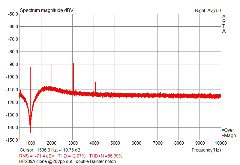

My favourite one is a manual-tuned double notch based on Bainter topology - a sample run of a 239A clone thru the notch is attached: @ +40 dB post notch gain noise floor is quite low, and you can easily (and stably) get more than 100 dB fundamental suppression - I'll post the schematics when I'll find it...
L.
