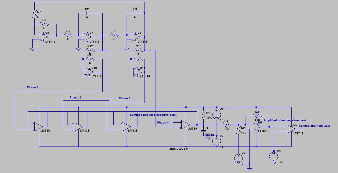

I have a trick for using an LM339 as an active precision rectifier. It has an open collector output and is a linear device inside that recovers from overload really fast so it works well for this. Its "negative logic" so you need to think negative peak capture. You get 4 in a package so its a good match for this. Attached is an illustration of the concept.
However with 4 peaks per cycle you will get ripple at 4X the fundamental. You may also get 2nd and 3rd harmonic modulation if the peak levels of the stages are not identical.
The higher Q will reduce the close in phase noise which is good. But would not the noise floor of 4 opamps summed in effect be higher than 1 or 2? I would think you want the system running at as high a level as possible, but then the nonlinearity of the opamps may become a limit.

I found the LM339 to be quite noisy. Is there another comparator that would work for this. LT has some with light current source pull ups, 100uA. The outputs can be paralleled.
Is it noisy enough to affect the output level significantly in this application? With the integration after the device I would think the noise would not be a major issue. I don't know of another open collector type that is linear to the output and I have looked.
Probably not enough to effect the output level. It's my experience that noise and distortion is transferred to the multiplier through a fast control element and in turn shows up at the output of the oscillator even with large amounts of decoupling.
Whether this is significant or not depends on what we are trying to achieve. If it's a -140 THD or THD+N then yes it matters. With what we have to work with these days the AGC is a dominate source of noise and distortion. Next to that is the multiplier.

I think the noise (however much there is) will be attenuated by the integrator and become very small part of the end signal with a passband well below the the frequency of the oscillator. The input offset is approx 1-2 mV which is small in this context. If the noise is a real issue a TH-SH may actually work better if the switching transient can be managed. The through connection for the noise is a very small part of the cycle with the TH-SH solution. It would also avoid the introduction of harmonics from multiple samples per cycle.
"If the noise is a real issue a TH-SH may actually work better if the switching transient can be managed."
That's a big if. The transients can get into everything. Even using a high performance ADC as a sampler noise and even distortion of the peak get passed through.
I'm not sure of how much, distortion of the peak, contributes to THD.
Excluding a clipped peak of course.
Unfortunately we need a PI controller--the I portion is surely not much of an issue if well designed, but the P portion forwards noise of the detector straight to the multiplier. If there was no need for a P path this thread would proabably not have nearly 300 pages...
